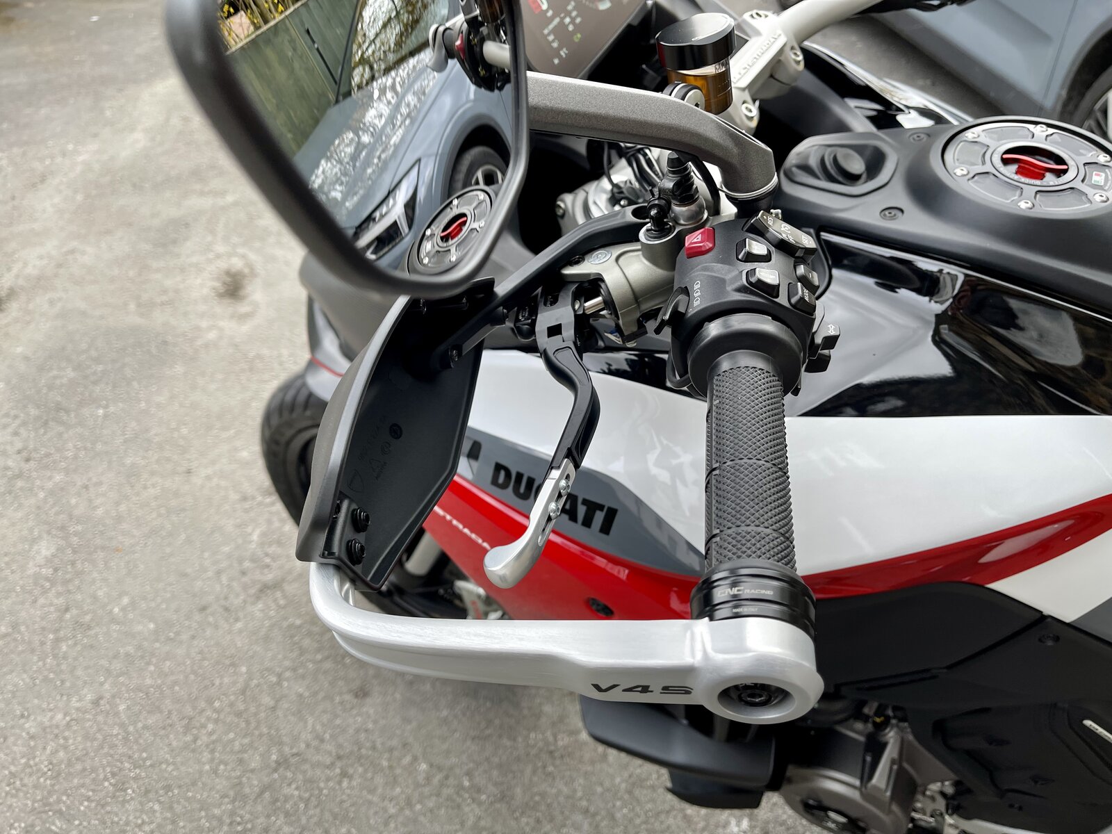

  10. My dealer is fitting the Gilles levers from my 1260 onto my Pikes Peak. If they have any issues, I’ll update the thread.

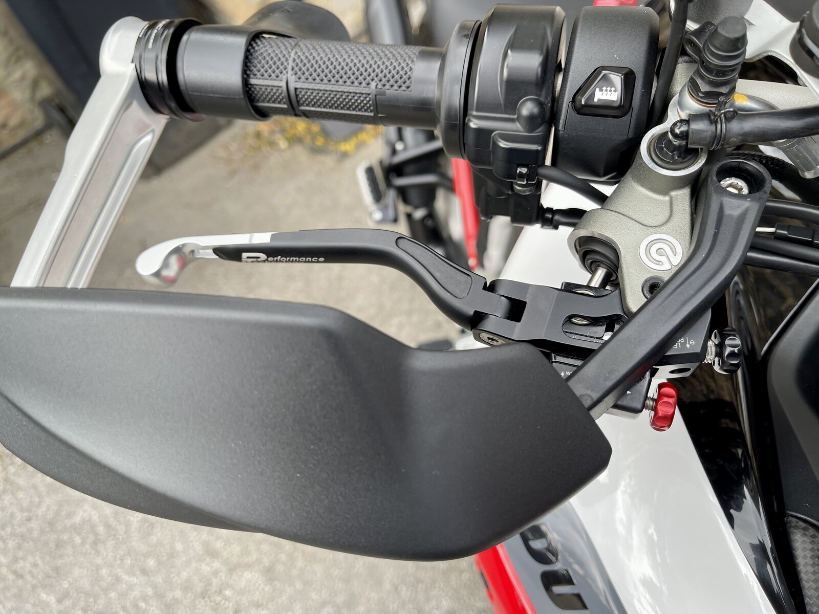

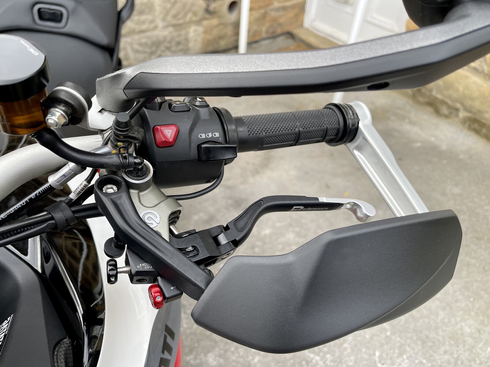

  11. I fitted these beauties last weekend… expensive but fully adjustable (reach and sensitivity) Performance Technology (Ducabike) Ultimate Levers… all went well until I realised I had damaged one of the clutch micro switches which knocked both front and rear radars(cruise control) out… trip to local Ducati dealer fixed it but at additional £140 cost for the new micro switch and labour. Everything set up perfectly and working brilliantly now though!
  12. They look very good and this is an upgrade I'd like to do (once my PP arrives). Out of interest, what happened with the micro switch? Was it a case of they are too fragile when removing or even not designed to be removed?
  13. Looks good. Just out of interest, is the bash plate on your bike painted, powder coated or is the the PP equivalent part? Aiming for that exact look!
  14. the micro switches are very fragile and I knocked it when I was removing the OEM levers… didn’t realise until too late… really recommend these levers though.

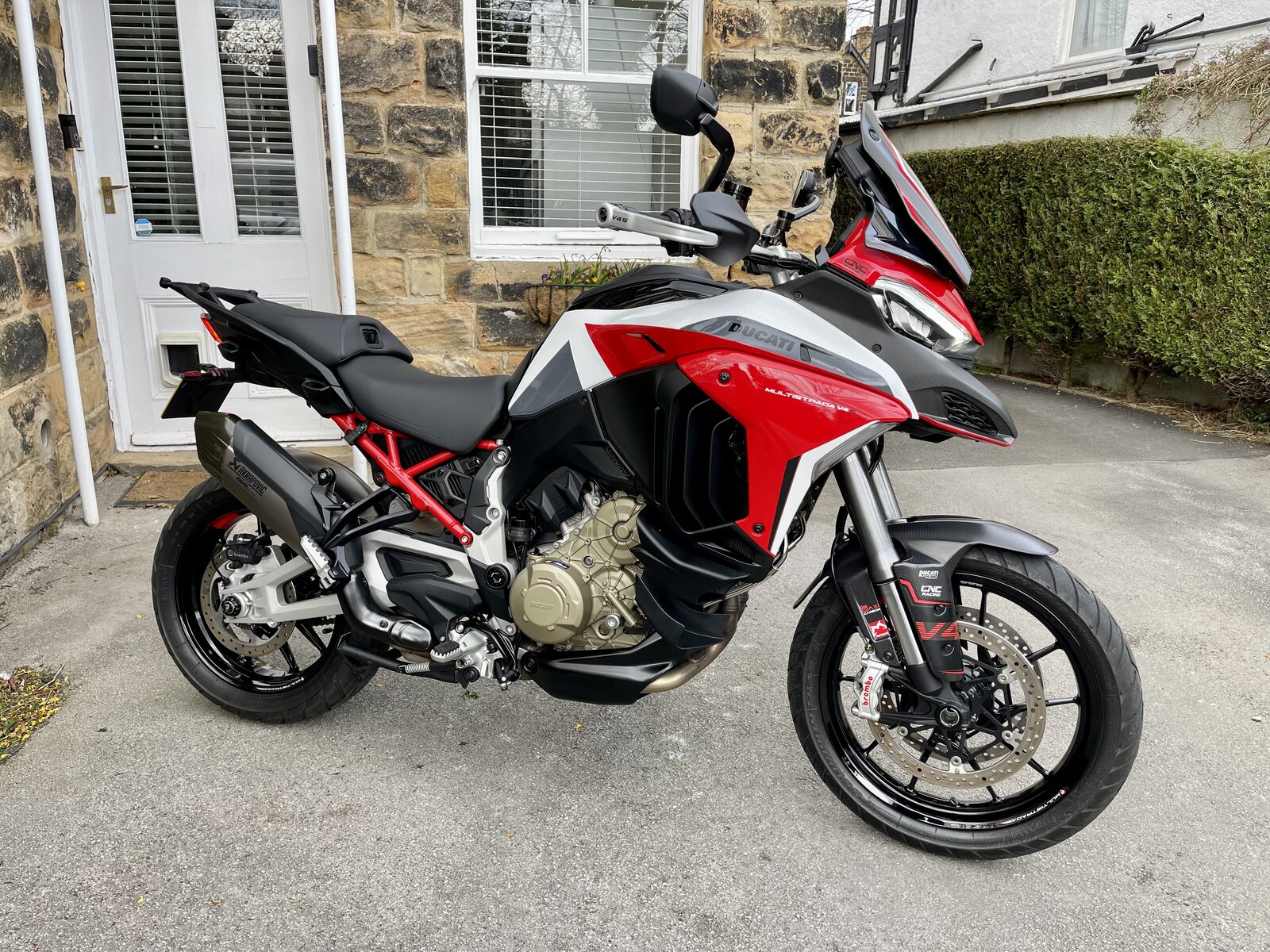

  15. Ducati Leeds were selling a brand new silver bash plate off very cheap so I bought it amd paid £75 to have it powder coated. I also bought the black Pikes Peak rear foot peg/exhaust hanger… and Ducabike rear brake/gear shifters… again not cheap but at least I can revert the bike back to stock when I eventually sell… or sell the silver parts off separately.
  16. Does the clutch lever adjust the bite point at all? Interested to know how the second adjuster works.
  17. Yes, clutch adjusts bite point and brake sharpens/softens up brake point… not massively but it does.
  18. Many thanks. You were very fortunate to get a spare bash plate - I'll need to keep my eyes peeled! Last question, I see you have the accessory hand guards fitted - are they much heavier than the stock plastic versions? I need a bit more weight at the end of the bars, and have been thinking about the Evotech guard protectors - the Ducati ones look so much better, though, and if Ducati Manchester have another 20% off sale...
  19. they are heavier than the stock plastic efforts… much better quality though. I ordered in the last sale via Ducatistore (Manchester) and arrived this week.
  20. Brilliant.That's what I needed to hear. Many thanks!
