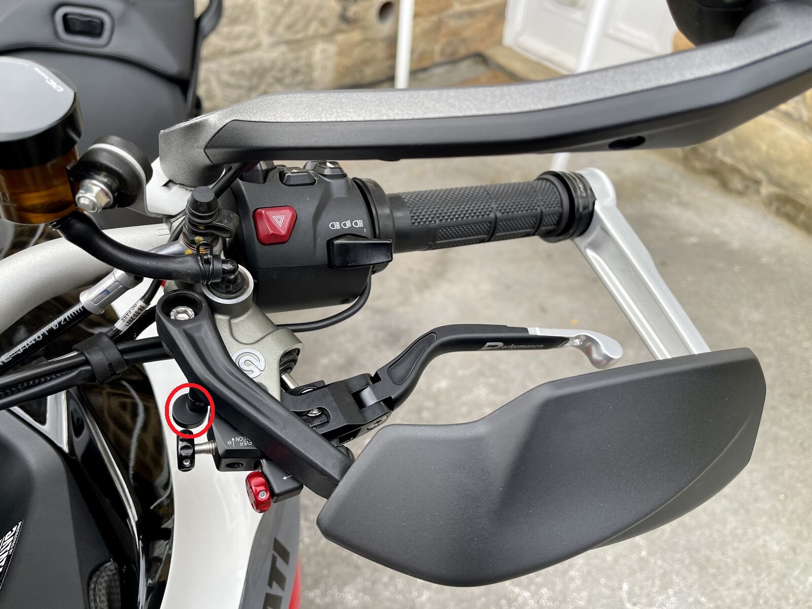

  8. I was wondering what that cam in the picture you posted was for. Makes sense that you would need to be able to adjust activation for the switches when you're able to adjust the lever pivot point. The stock levers don't have those cams and I don't think the more pedestrian Evotech levers I have on the way do either. I'll take a look at them when they get here to make the final call but at this point I'm still planning on doing my own install. I'm a 165 miles away from my dealer.

  14. The item you circled is one of the adjustable cams that engage/disengage the micro switches. If I recall there are two on the underside of the clutch lever and one on the underside of the brake lever. It is critical to set these up correctly and not damage the micro switches in the process. Your cruise control, quick shifter, clutch and brake are all connected via the ECU and are engaged by these micro switches in order to operate correctly. I'm not sure if this would be the same setup challenge if the radar active cruise control is not fitted...
    The knurled black knob adjusts the reach/span and red knob is used to adjust the bite pivot (ie plunger) on both clutch and front brake.
    I guess the adjustable cams are present on these levers due to them being more adjustable than most other levers.
