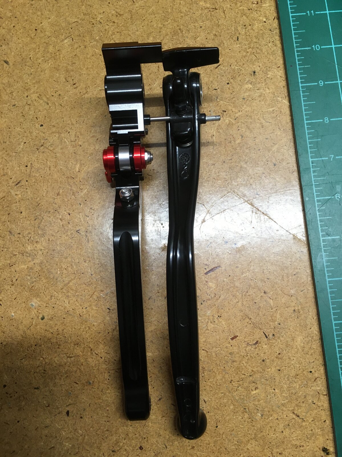

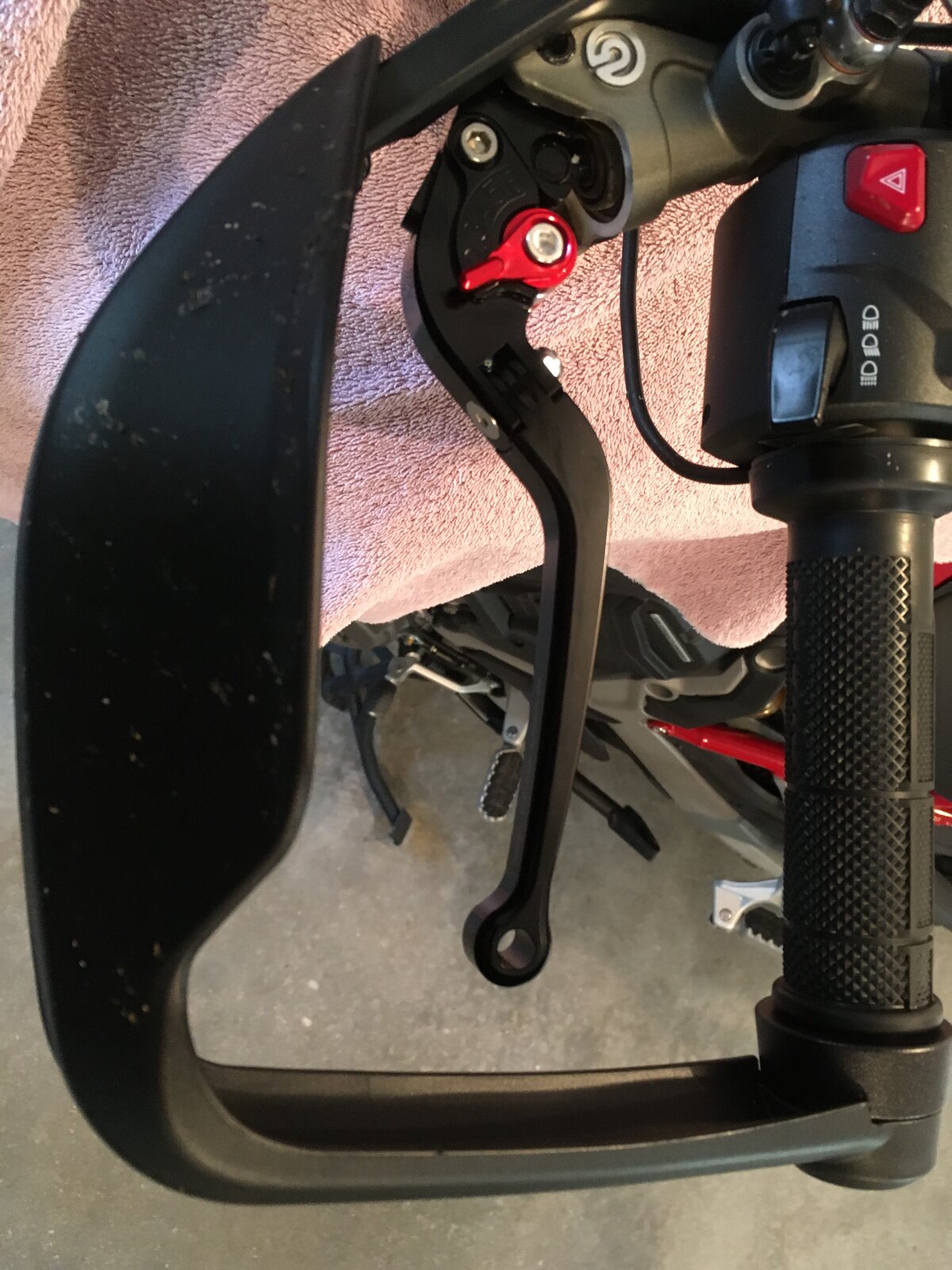

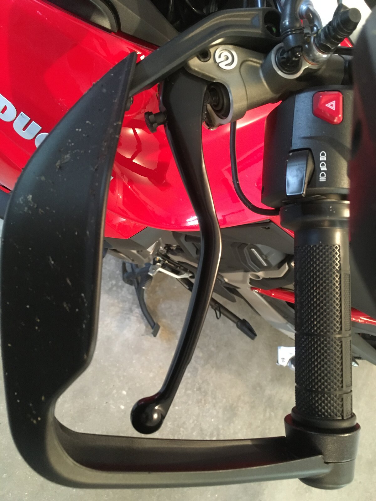

  2. Installed Evotech long levers this week and just got in from a 95 mile test ride. No problems with the install and everything works like it should.
    You can see the Evotech long levers are still a bit shorter than the OEM Lever. For me the clutch is essentially a three finger operation now and the brake I've always used two even with long levers. I was surprised how much better I like the brake lever over stock. It was the reach to the clutch lever that convinced me to make the change.
    In these picture both stock and Evotech levers are set to minimum distance from the bar, just to give an idea of the difference. Sorry for the smashed bugs.:D
