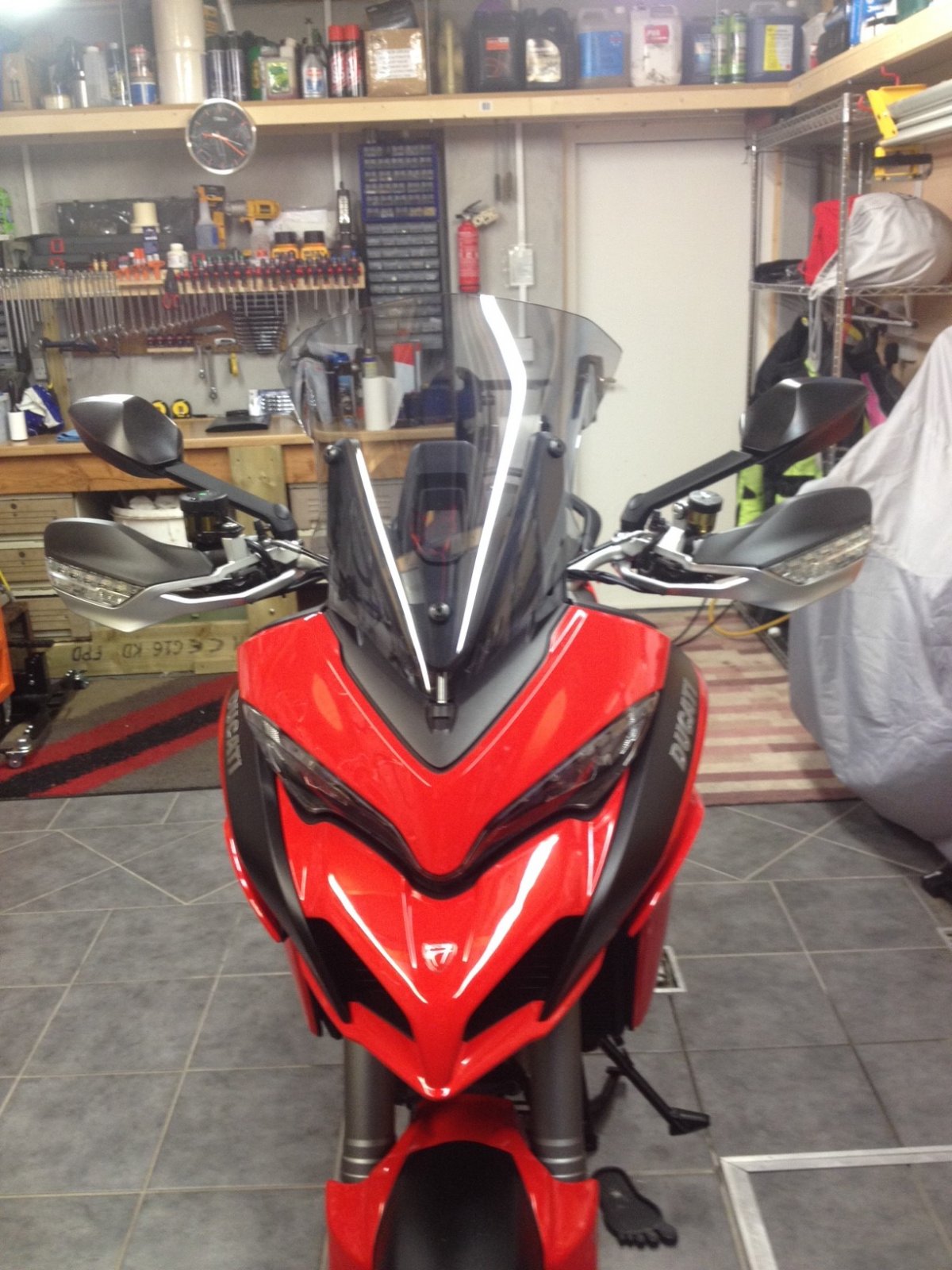

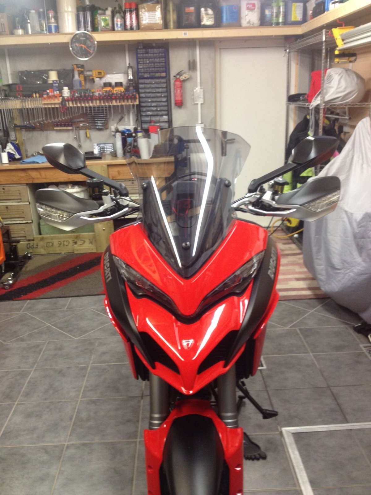

  3. Hi - I just decided to cut down my Touring Screen - since it was worse than the standard screen to try that before spending another £200 on the carbon screen.
    Cut 110mm off the top and 2 small corners then a couple of small blend radii.
    Looks OK to me - maybe a little too high still?
    In the upper position its the same hight as the standard screen in low position.
    Hopefully weather will be dry in the morning and I will give it a try.
    screen down.jpg Screen Up.jpg [/QUOTE]

    Well took the bike with cut down touring screen out for a 100 mile ride this morning - buffeting has gone - still a little noisy - but thought that's more to do with Arai X4 tour helmet - much quieter than before.
    But this time when I was out I tried raising the screen - just 1 notch and the noise got worse, 2 notches up and the buffeting came back.
    So reset to lowest setting - 70mph on cruise control and started straightening myself up.
    Lifted myself maybe an inch, inch and a half - keeping head level - and it went quite a bit quieter.
    So decided to lower screen further.
    Cut another 45mm off it - so now in down position the top of the screen is level with top of mirrors.
    Test ride on Monday when it goes in for its service - already at 700 miles - so no ride tomorrow. :(

  12. Quick update on this screen. It's working very nicely indeed. Smooth airflow, no buffeting, much lower noise. I like it a lot.
