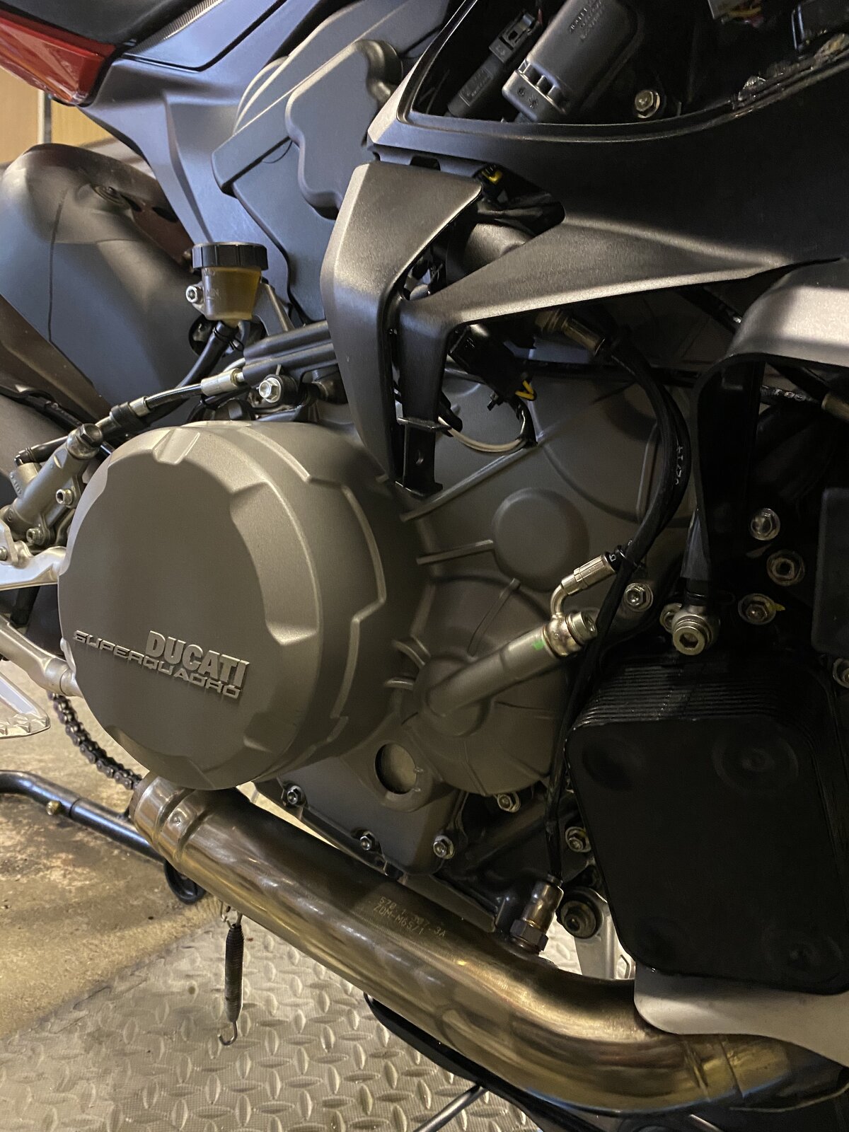

  1. Doesn’t look in the best of shape. There should be a needle bearing on the shaft that the gear runs on. In the picture it looks like it’s not there and the gear is on the piss?...
  2. I use coffee for nut tightening normally but maybe @nelly is a better option
  3. I’ll check the oil pan see if it’s fallen out when I took the cover off. Can you point me in the direction of a new cog... I’ll check the manual see what I can find out.
    Any help you can offer is much appreciated I can see I’m in a little bit of a pickle here now
  4. The gear will be a dealer only part. I need to check in the morning, but I think there should be a thrust washer on the shaft to... maybe stuck in the cover?
  5. Yep washer came off with the cover but no bearing found. I think I need to swap that cog though... bad practice taking the cover off and not replacing it. Surprising how worn it is the bike has only covered 4600 miles
  6. There should defo be a needle bearing on the shaft for the gear to run on. One not being there, could be a result of the cover already having been off before and not put back together properly?

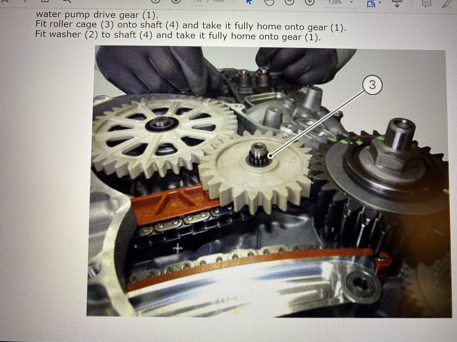

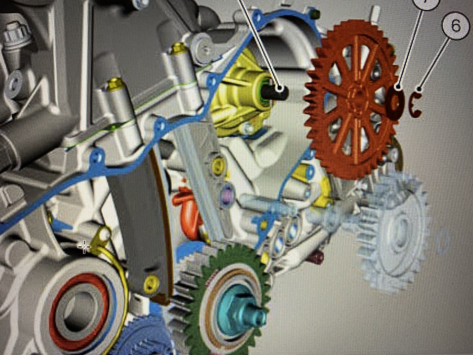

  8. Morning Nelly
    not the best picture but the diagram only shows a washer to the outside of the centre sprocket - not quite found the part number for a replacement sprocket yet
  9. It’s missing and that’s why your a fully fledged Ducati specialist
  10. Haha sorry... I’ve found the parts now!! Plastic pump gear, the bush and bearing needle. I’m guessing the bearing needle is still in there behind the gear but again is it worth changing the bearing needle while it’s in pieces??
  11. I'd check and be 100% the bearing is there. Pull the gear off and check everything is in place.
  12. @nelly when you gonna start charging your consultancy fee?!
    fyi the 749 is running lovely thanks to your prime work
  13. hi Nelly, yep everything's inplace. I've ordered a replacement sprocket so just a quick swap around.
    This threebond sealant - I guessing I fit the part as soon as I've added the bead?? Gonna be a nightmare not getting the sealant everywhere while feeding it in.
