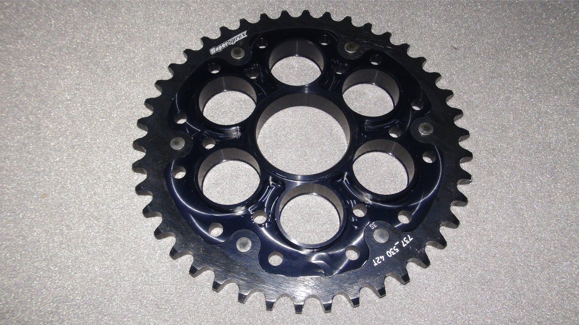

  11. Sorry to revive an old thread, but what sprocket carrier is that? I'm hoping to duplicate the exact look below.
    Thanks
  12. [​IMG]
    Freshage - Suggest you speak to AndyW as that was the original VERY clean one that is now replaced by black as above! Get the metal polish out :biggrin:
  13. OCD Andy !!:biggrin:
  14. Oddly, I'm not a fan of the black carrier flange. And I've learnt that the sprocket mentioned in the post I quoted has the carrier built into it. So no need for a separate carrier (mentioned on Andy's site).

  16. If you have gone for the rear sprocket in quoted here: http://ducatiforum.co.uk/f6/alternative-530-pitch-rear-sprockets-mts1200-457/index3.html#post258940
    Then if you can't cancel it in time and end up getting jipp. I will take it off your hands. Won't be until late December though :(
    42T is the OE size right? And it's in 530 pitch and black?
  17. Freshage, Check the original post by AndyW as he goes into a great level of detail on gearing. The 42T is a 5% change that will be ideal as I always find 6th too tall even when touring and the 5% change will help low speed town & traffic and make it even nippier :biggrin:
    Otherwise it's black 530 so I will post if I end up with a spare.
