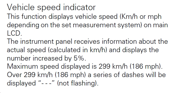

  6. The rear wheel ABS sensor also provides data for the speedo / speedometer so the only thing that would change the accuracy would be a change in tyre and/or wheel diameter :)
    I believe the same data is used for the odometer. Note - Ducati have introduced an intentional +8% error in the speed shown on the Dash (to meet EU safety regulations i.e. any error in speed displayed errs on the safe side with displayed speed higher than actual speed [you'd think in these high tech times they could just produce super accurate speedo systems?].....although most manufacturers don't build in such a high margin),
    The odometer on the other hand is accurate.
  7. As you say it is down to the regulations which state that speedometers can be up to 10% fast but may not read slow. So manufacturers usually set them to the middle of this range but Ducati's 8% does seem excessive.
  8. 8% ? Or is that how the calculation From KPH to MPH makes it ? (No idea why the image is entering twice)

  9. No you'll find that the same error applies whether the readout is kmph or mph. What year bike have you got?.....interesting that the figure now reads 5% - for 2010-2012 bikes it was definitely 8% and demonstrated nicely somewhere here recently (by Kirky I think) with a GPS screenshot showing 137mph.....Dash showed 150 (8% difference) [in Germany apparently;-]
    I remember a comment on ducati.ms some time back where someone posted up that one of the Ducati ECU updates changed the level of the built in error but never saw this confirmed in any way.......anyone know more?
    I fixed that for you (images from a URL......watch out for the check box below the url entry;-)
  10. Its a 2013 ABS and taken from the electronic manual, but its the same in my hard copy I got with the bike also.
    Thanks for fixing the picture :)

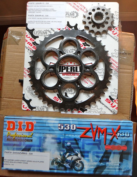

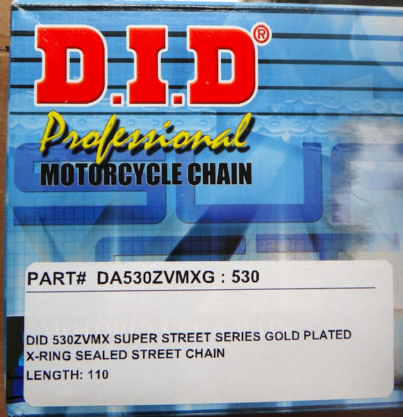

  15. Woooo, finally getting round to my little service this weekend. Hopefully, including chain. I'm going for the 42 tooth supersprox rear, OEM front and DID chain... But how many links? 108 links?
    Going for this chain(part# 3012648): DID 530ZVM-X Superstreet Gold/Gold 'X' Ring Chain
  16. Warning
    Yes 108 link (the OE length) is perfect.
