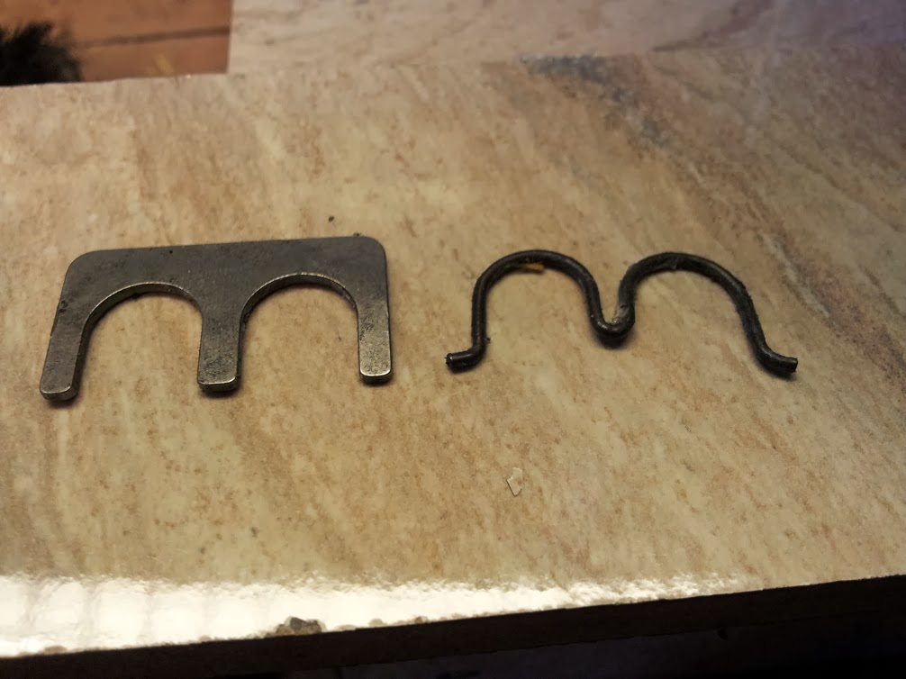

  1. The last 2 chains I have fitted have been supplied with a 'shim' to fit between the plates when riveting to prevent them being too tight.
  2. Never seen or heard of that before........good as long as you don't trap it! lol
    Photo would be cool ;-)
  3. I'll see if I can find one. I think I might have one in the garage - somewhere :rolleyes:
  4. Found some info via Google.........
    "Some chain tools provide you with spacer blocks to help you do this without over-tightening, but if you don’t have one of those then patience and care will do the trick."
    Spacers for correct riveting of chains. Some motorcycle chains are supplied with spacers / shims to help ensure the new joining link is not over tight when riveting.
    Regina chains come with shims/spacers apparently........this is also a good 'how to' article:
    REGINA CHAIN - Replacement of an endless riveted chain
    ...and another reference plus other good related chain change/maintenance info:
    Chainmaintenance
  5. I found some in the garage - two different types. One came with an EK chain, the other I think with a DID. I see you've researched them for yourself. :smile:
  6. Thanks :D

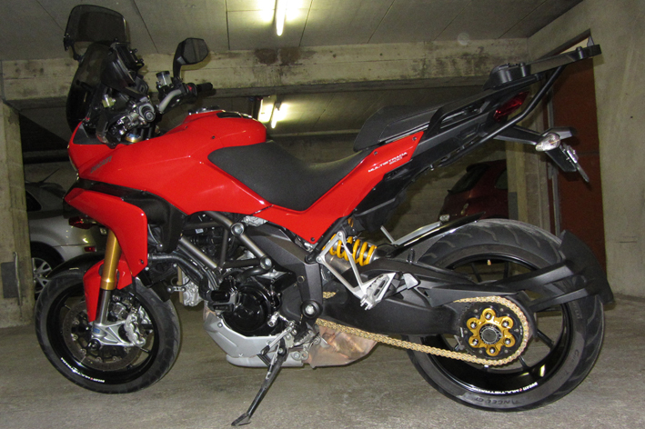

  10. My actual choice goes to 14/40. I know that makes much more stress for the chain, and makes the chain whipping against the sliding shoe fitted over the swingarm, but it makes the bike easier to ride at low speed, especialy in town.
    Currently, I use a Supersprox sprocket (RST-737, 530:40, black), a DID chain (530 ZVM-Xring Gold, 108 links), CNC Racing rear sprocket flange gold, CNC Racing rear sprocket flange nuts black, CNC Racing rear wheel axle nuts black, and the rear chain mud guard modification suggested by AndyW here :
    Multistrada 1200 - Changing chain & sprockets - AndyW-inuk's Photos
    I like the look :upyeah: and I think the quality is at the rendez-vous too.
    My next final drive kit will be 15/42, probably with same items.

  12. I have a set of the wire spacers, shown on the right of that picture. I keep them secure. Attached to a rare earth magnet stuck on garage door. Along with a few other minor fiddly bits I dont want to loose. Can be a bugger getting them of the magnet tho.
