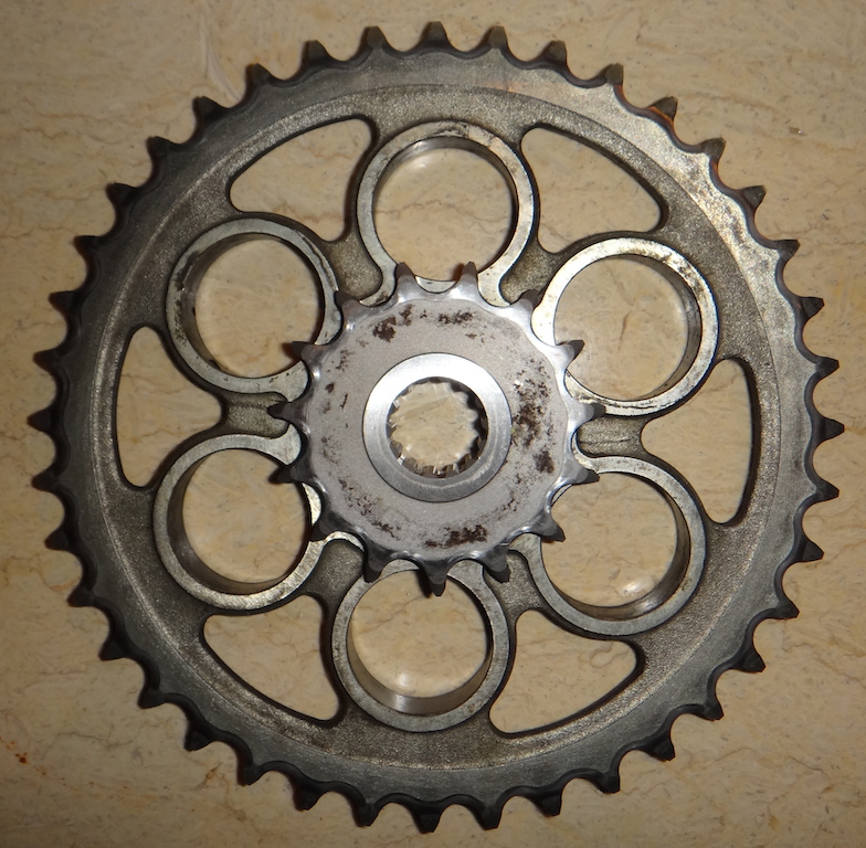

  7. The two sprockets pictured in my post #105 (15/05) are my old OEM sprockets.
    See my post #65 had a MTS chain / sprocket kit hand-carried from the USA: www.ca-cycleworks.com to Shanghai / China last year.
