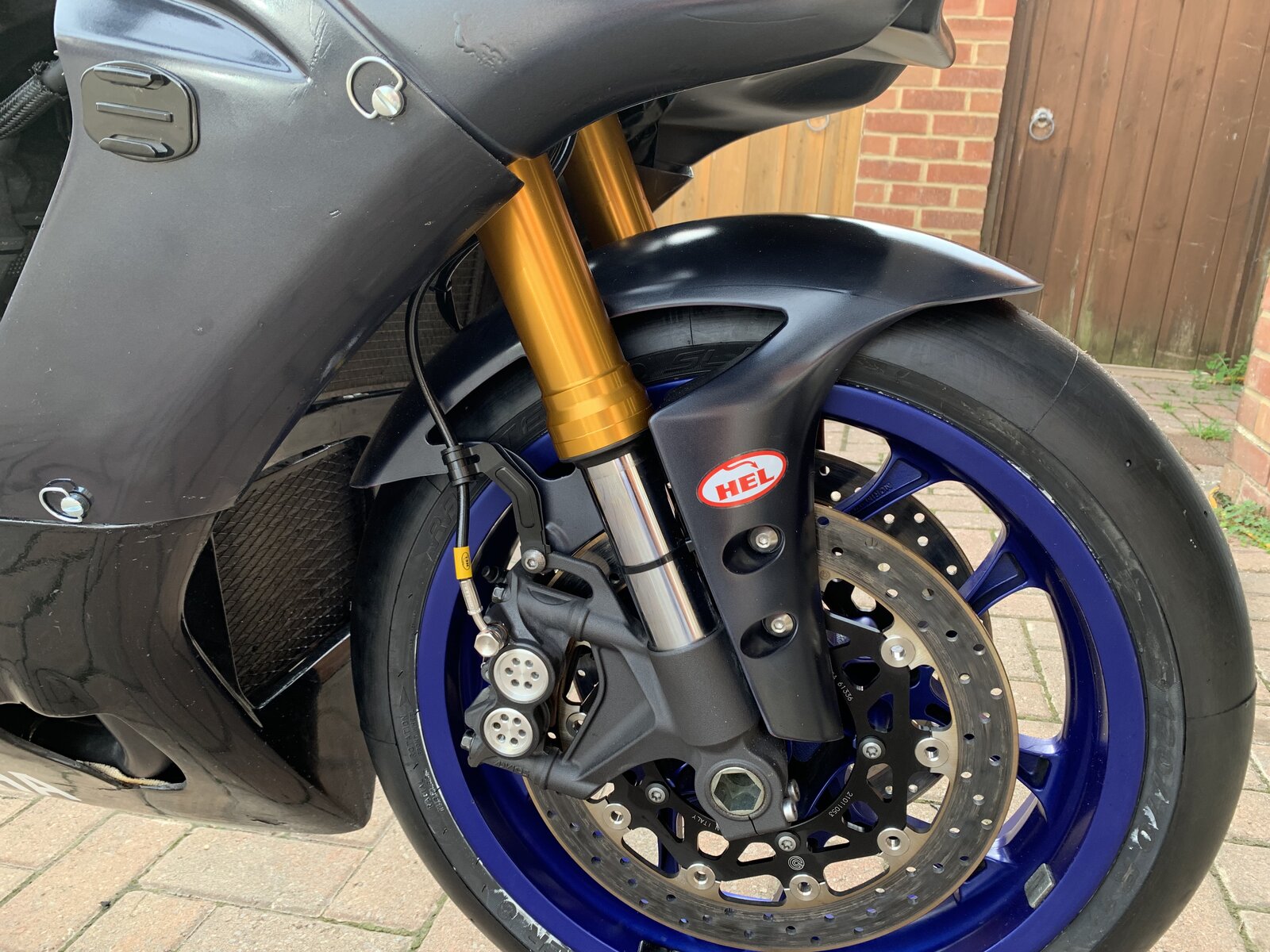

    as I probably said, I ran the entry level Brembo series discs and I think they are 5mm on my R1 and they were absolutely brilliant, it’s the quality of the metal also that helps, versus OEM stuff
    pic of my brakes to show which ones I’m on about
