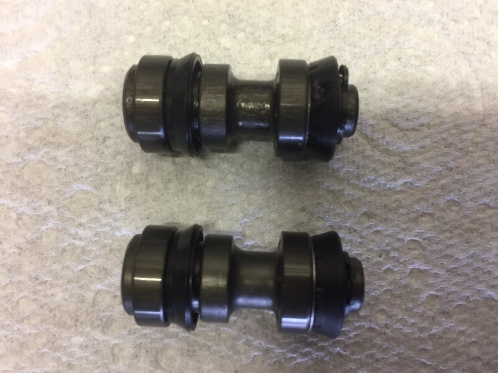

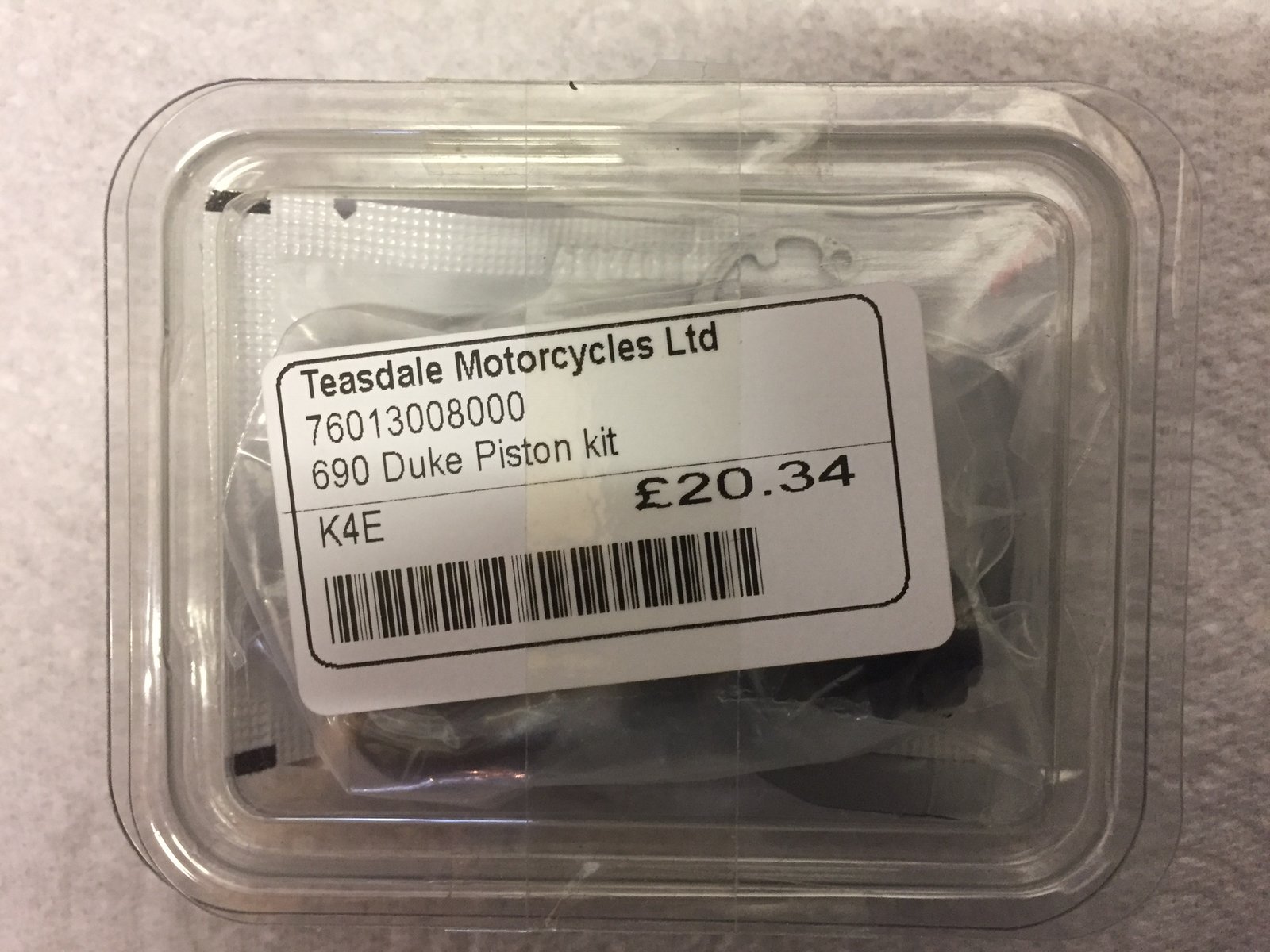

  1. A most enlightening and interesting post. I’ve had problems with my 1299 clutch since new and I concur that the problem is with the master cylinder. 2 master cylinders & now 4 slaves, new copper washers and bleed nipped all round. NO fluid leak!!! Still have to fecking bleed every 100 miles.
    So, I’m going to order a kit and see what happens.
  2. Would this fix work on the brake master cylinder? My front break lever is getting softer. Pads all good, bled system and still feels soft?
  3. Don’t know tbh, you’d have to pull the brake master cylinder apart and find out what bore size it is and then go look for the equivalent KTM seal kit which just takes a bit of time and “detective “ work
    You would know for sure if you had a pin hole through the seal on the brake side, just hold the brake on, …does it loose pressure and the lever come right back to the bar?
    Probably not I would suspect, it’s probably some air still trapped in the system, a lot trickier to bleed are abs brake systems...

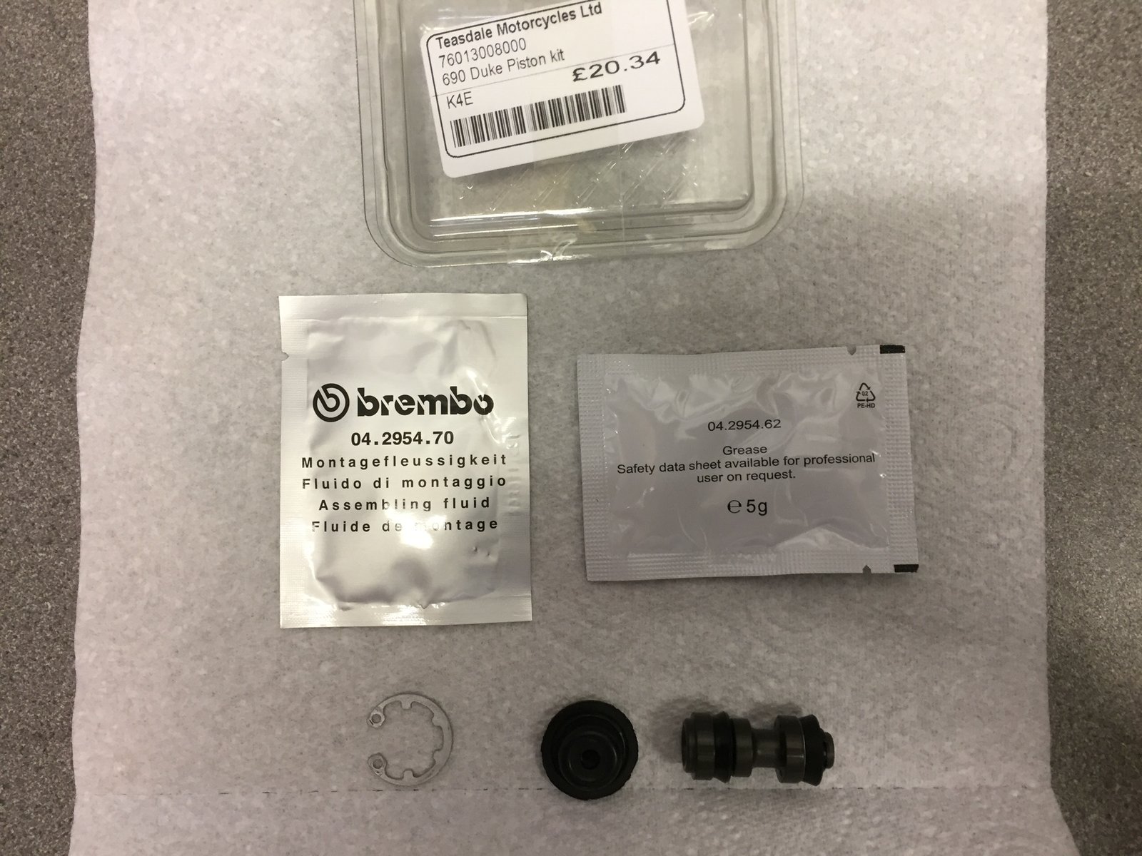

  4. When I was looking for a Brembo part for a Ducati but from KTM, I looked for the equivalent master cylinder and then got a part for that, rather than hunting through parts looking for one that matches.
    Maybe I was just lucky but I found that route to be quick and simple and all done online.

    What still amazes me is that piston seal repair kits obviously exist, but they won’t sell them in the UK, they try and force you to pay out £240 , when a fiver seal is all you need?

  6. Yeah, but the KTM parts microfiche that I’ve seen don’t tend to give you the bore size, if you’re looking for a brake piston seal set for your 1299, aero’s post gave some Ducati seal part numbers, for a 16mm bore they quote a seal kit part number
    61041881A
    Try ordering that from your local Ducati dealer and I bet they will say they can’t get it, you’ll have to order a complete master cylinder.
    Good luck, let us know how you get on.
