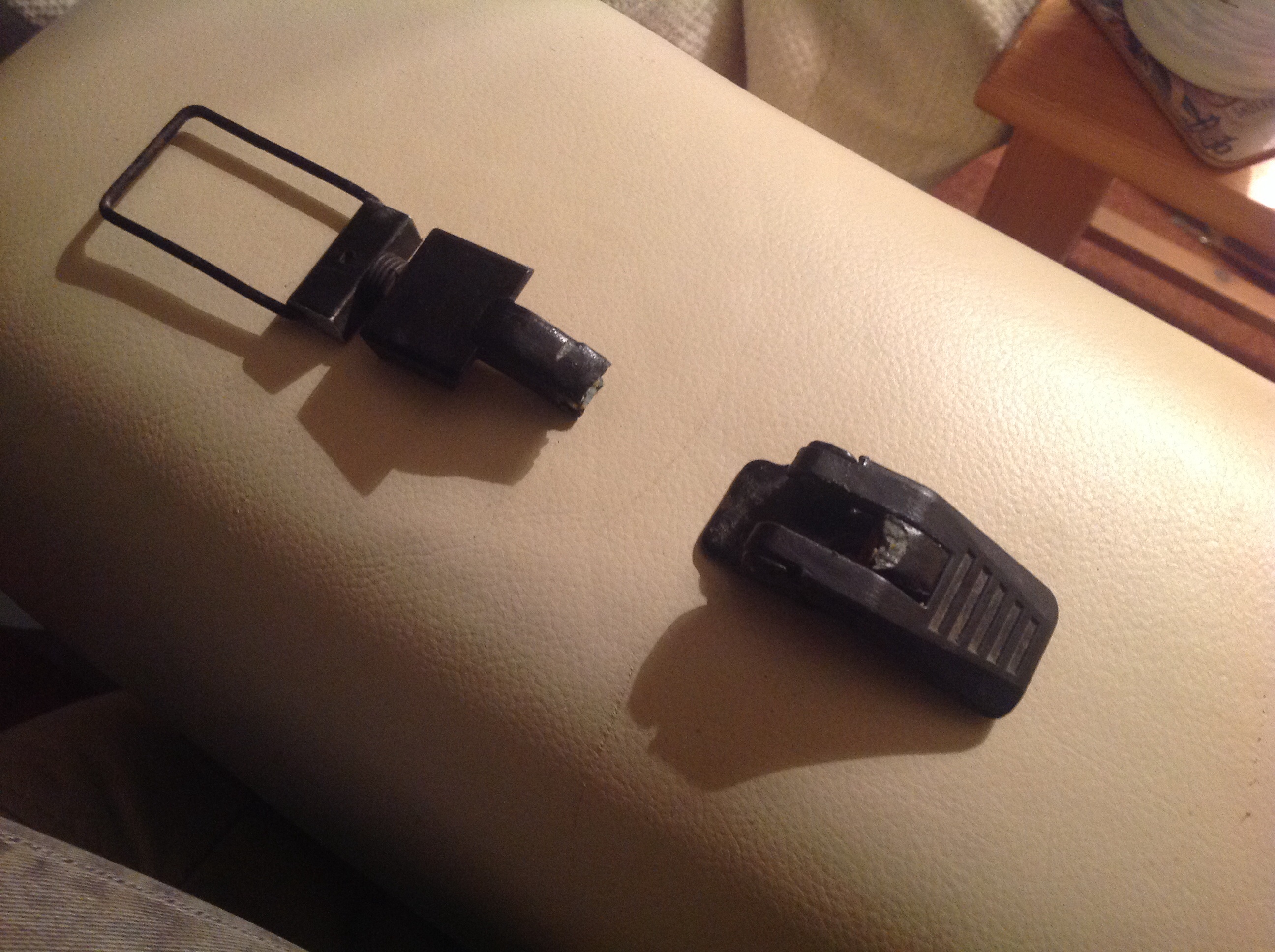

  4. All done. Runs beautifully once again. Just need a tank clip now mine broke. Anyone have one?
  5. It was probably too tightly adjusted..............
    I have mended one before and it is still working (not mine, I hasten to add) but yours is very close to the pivot pin, so I might not be able to do it.....but I will have a go if you want.
    AL
  6. All sorted but many thanks for the offer.
