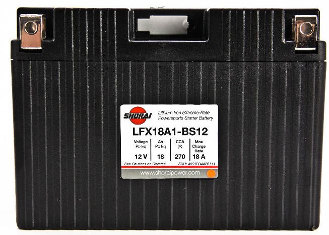

  1. LiPo, I put an 18a Shorai on my 1098R after some starting issues...............Tin hat on :Nailbiting:

  2. Well I'll back you up @Robarano I have a Shorai 21Ah in mine, LFX21A6-BS12, 21Ah, 315CCA. Although its not listed for the 1098 it fits a treat, it is a pricey option though and LiFe requires a little bit more homework and can be a little more fragile.
    Failing that a good option is something like an Odyssey or Motobat these are AGM (Absorbed Gel Mat), which can take a lot of abuse and IMHO are superior to the standard gel types, downside a bit more expensive and usually bloody heavy.
