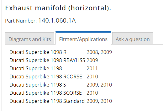

  1. Thanks, i thought i remember seeing an oem pipe on here, just looked but couldn't find it.
  2. That does look to be the cheapest, all the others are £60+. Might just go for that.
  3. Mine's a 2011 S, but i presume they are all the same?
  4. I'd have thought so. How many O2 sensors does yours have?
    Or check the part number.
  5. Only 1, which i can't get off - i presume that is the thing that looks like a spark plug?
  6. Hmm, doesn't say 2011 S there. Everything but it seems.
  7. Ask @nelly he should have the answer.
