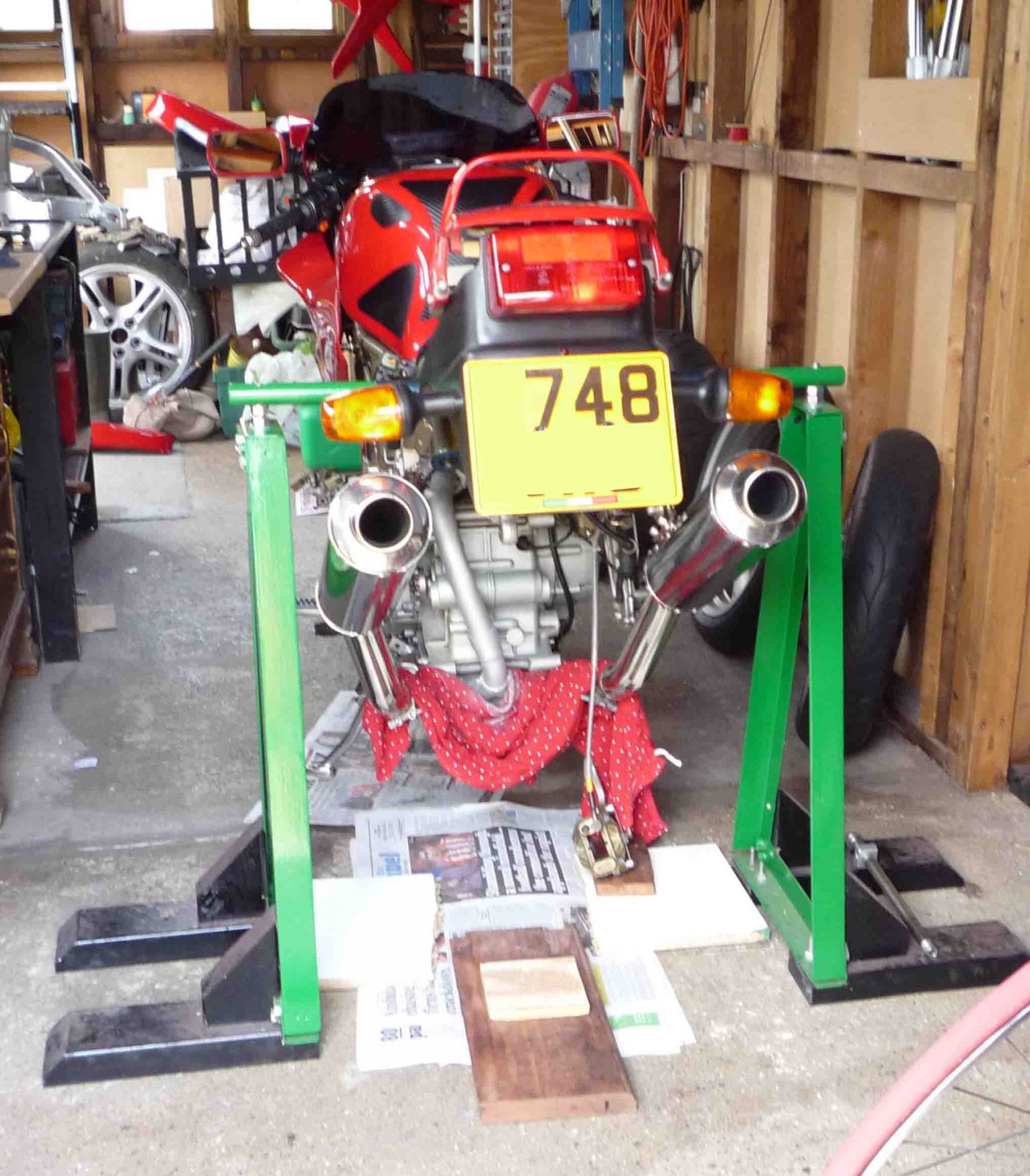

  2. Now if you had knocked up a rear stand based on mine, getting the swingarm and the zorst off wouldn't be too difficult.........see below......

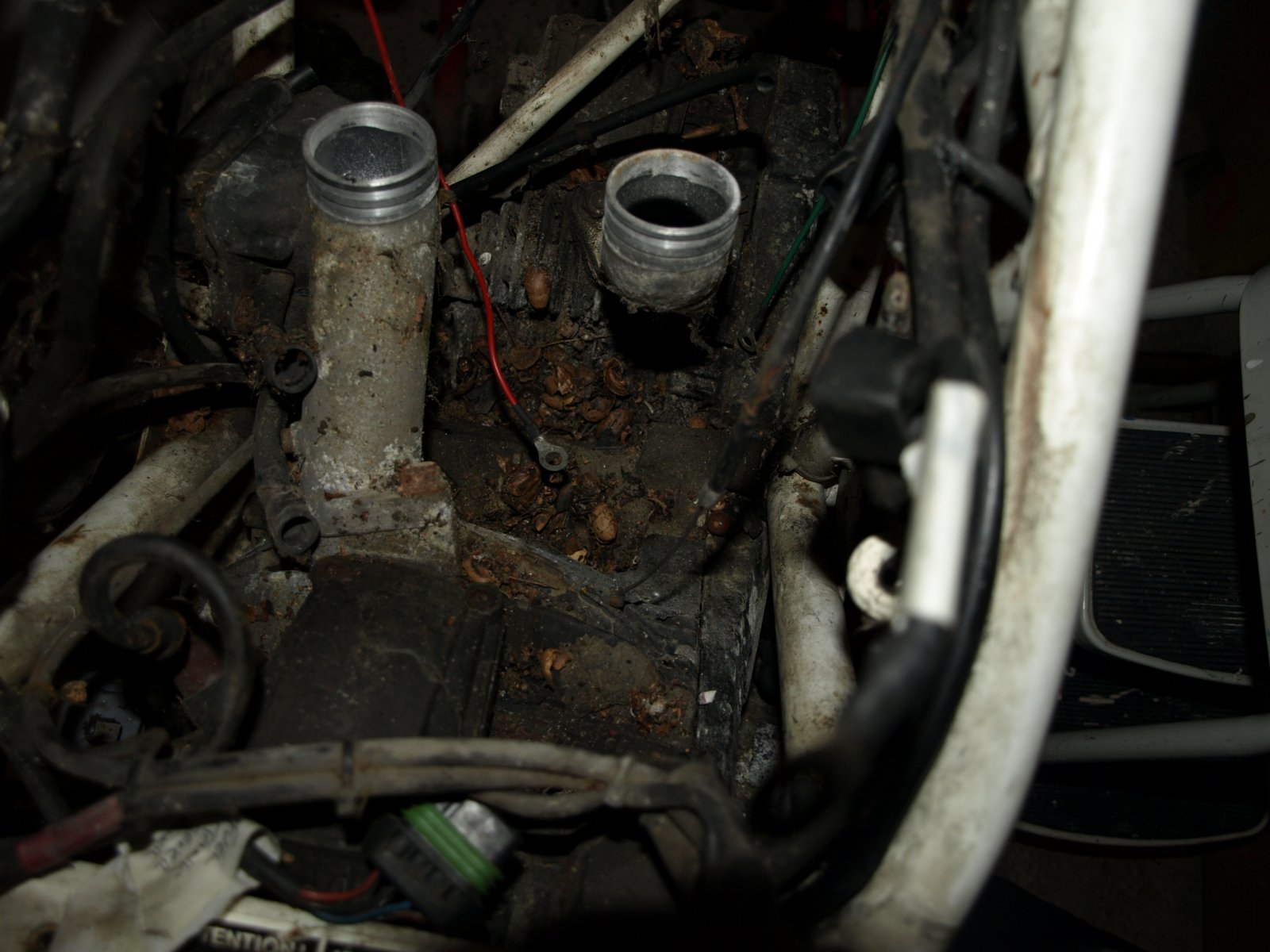

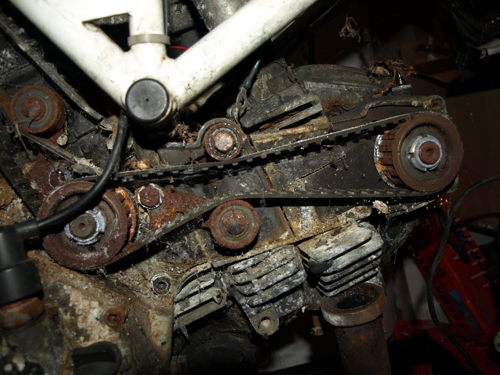

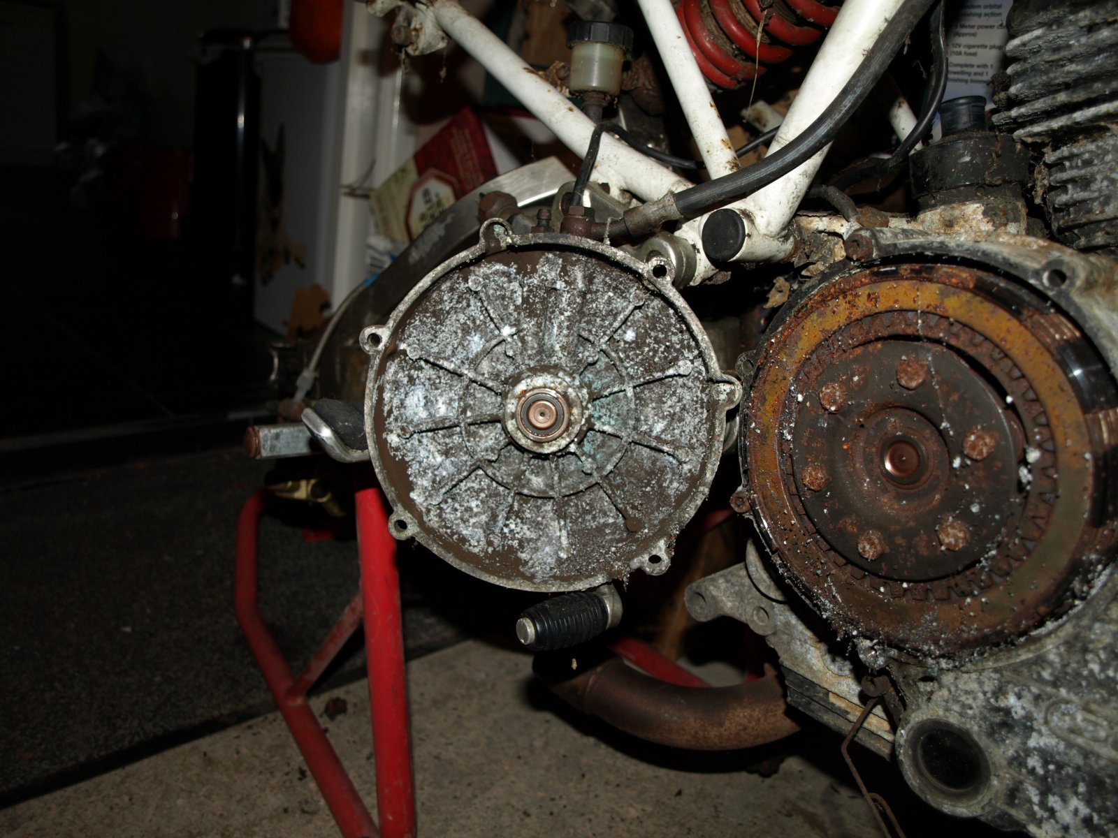

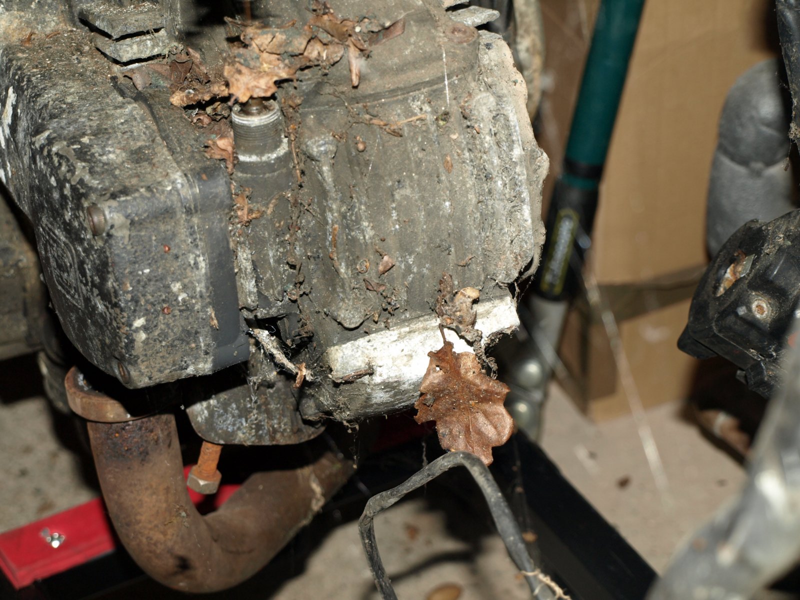

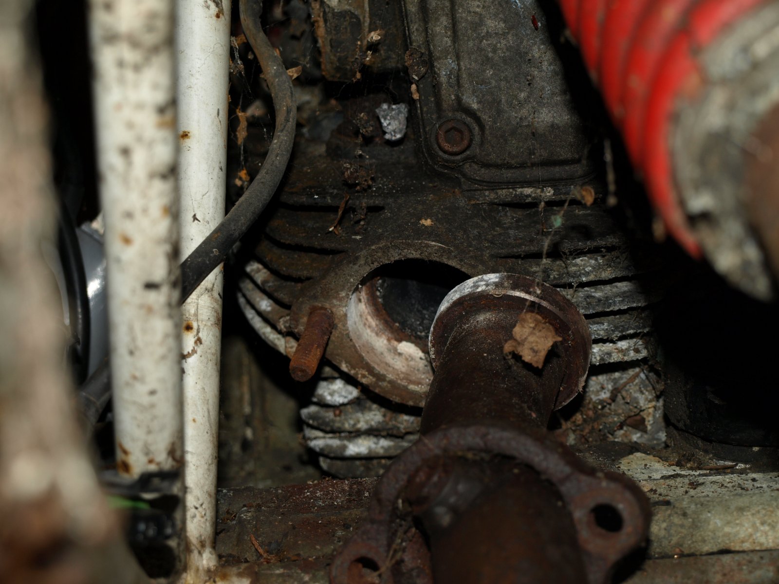

  10. So not a lot further in terms of stripping the beast down however I am slowly getting there. Here are a few more pictures to amuse you all.
    At last I have found Squirrel Nutkins secondary nut store
    Close up shot of the rear cylinder with the exhaust removed and one stud to boot.
    Close up of the front cylinder
    Belt covers off, now minus the spiders nest that was festooning the entire cavity. New belts and rollers all round plus new adjustable pulleys if I can get hold of them. Do you think the belts will be any good ;)
    Last but not least the clutch. The bearing still rotates freely, but I think the seals are well and truly shagged, as are the clutch plates by the look of them. So new slave seal and clutch pack to find from somewhere:Banghead:
  11. Belts look ok , but bin the rest !!!
