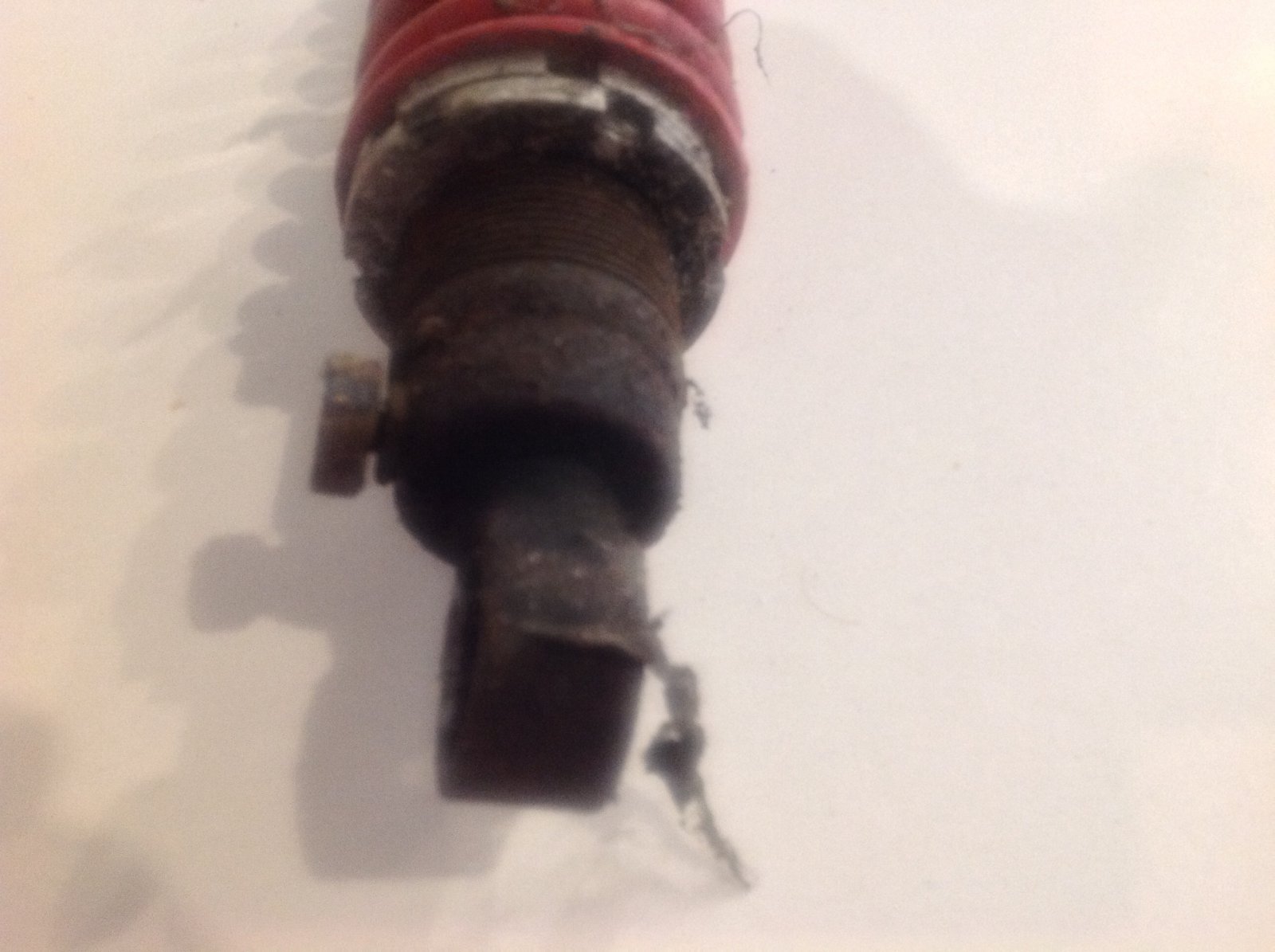

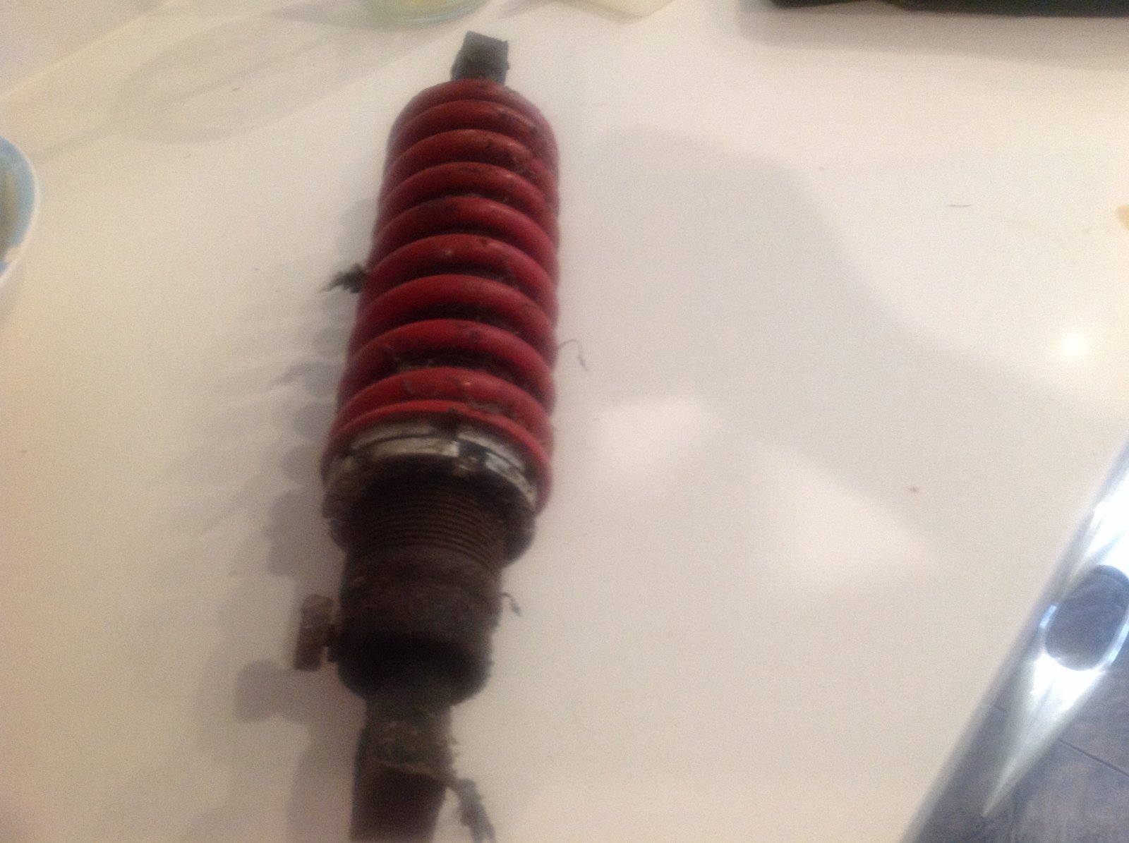

  3. So a bit more progress made. Finally got the rear shock off. The top bolt came out ok, but the bottom bolt had rusted in to the bearing. So after much Dblock spraying I got the bolt out which judging by the state of the nut, it was the rust holding the whole thing together. Any way could the assembled gurus see if they can identify the shock from these pictures

  4. Nope...................'Cos it ain't the normal Showa or the Sachs Boge..........No reservoir.
    I don't think its an Ohlins, even....
    It does slightly resemble the early Monster shocks, but the adjustment knob doesn't look right.
    I'll take a guess at Hagon, although it may be a Marzocchi, but from God knows what.
    #84 Ghost Rider, Apr 19, 2015

  6. Thanks @Lumbux judging by your picture my shock was installed upside down, the bottom bolt has been "modified" so the nyloc nut was held on by one thread and rust

  7. It could be that mines up up side down?!!:rolleyes:
  8. Does anyone know what the original fitment would have been, and does it really matter which way round the shock is mounted?
  9. The very early 750 was fitted with a Marzocchi rear shock, which was then changed for a Showa and then a better Marzocchi.....all this happened in 1990...........thereafter some 900s were fitted with an Ohlins or Showa (although the steel swingarm 900 should have a Sachs Boge shock as do the 750 with the steel swingarm)..........the early 90s 750s appeared to end up with the Showa reservoir shock when the swingarm is ally.
    That's the best I can offer.......the Showa and Sachs Boge are mounted with the reservoir at the top.......won't fit otherwise.
