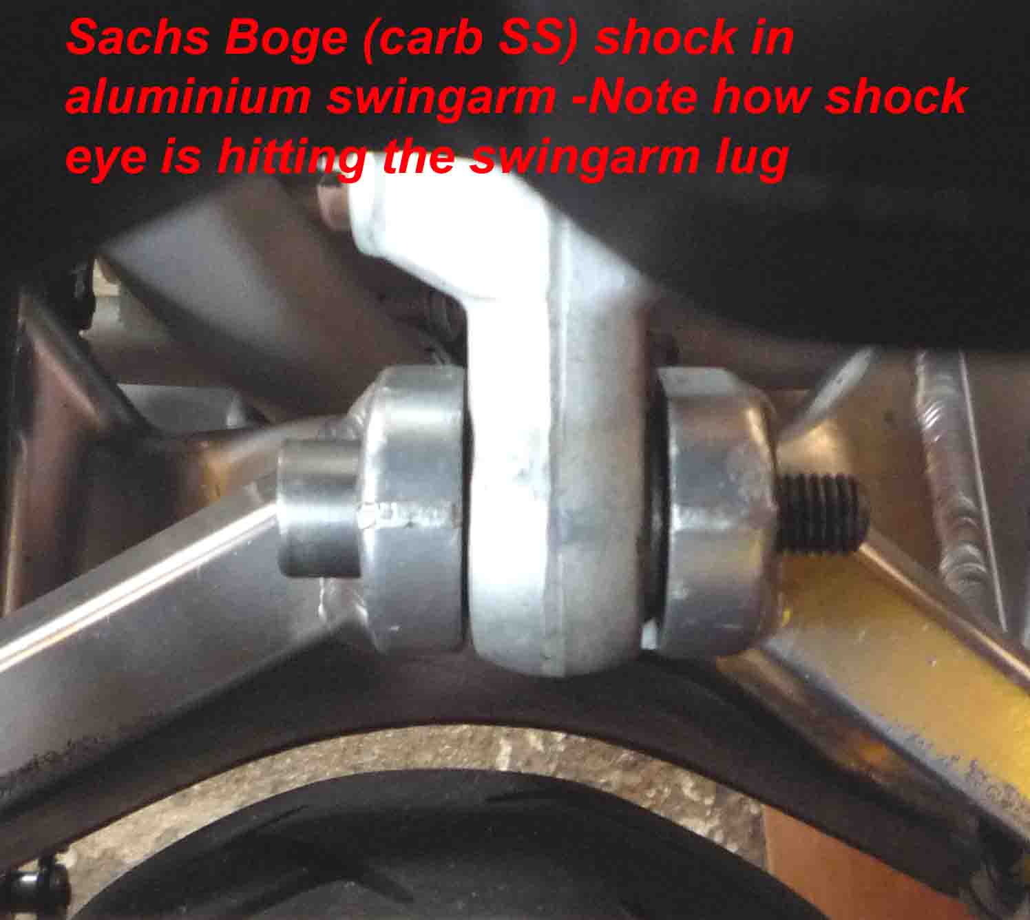

  1. My 400 has the boge shock on, it looks ok to me, not sure how long it's been on it for mind. I'll have a closer look later to see if there is any sings of damage.
  2. Here is what I found and asked Ducati Italy about:
    The main thing to look at is the lower eye of the Sachs Boge shock as it rotates across the bike.....the large eye will make contact with the swingarm lugs on my 900 ss ally swingarm.
    Maybe your swingarm has different lugs??

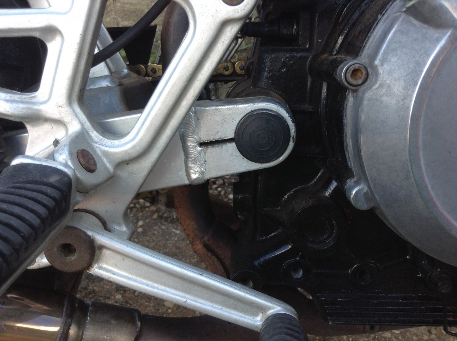

  4. And now something completely different.....
    How does one get the swing arm pivot out. I am assuming you need to drive/push it out, but it is hollow with very little meat to use, oh and the reverse thread on the the drive train side had me going for a while.

  10. As far as I can recall, Lumbux; when I saw your 759 swingarm, I thought it was different in some way to the earlier 900ss one I have fitted......Trouble is, I can't recall what it was that I saw.
  11. The lock bolts are the wheel side of the pivot not the engine side, and the engine side end is round not square.
  12. Gotcha............I wonder which is the stronger method? Or even, why did they change it?
  13. The 900 had the same swing arm as yours all, and the 750, 400 and 350 had the other type. Not sure why, the 750 sport, paso and I think 851 all had another type of swing arm too.

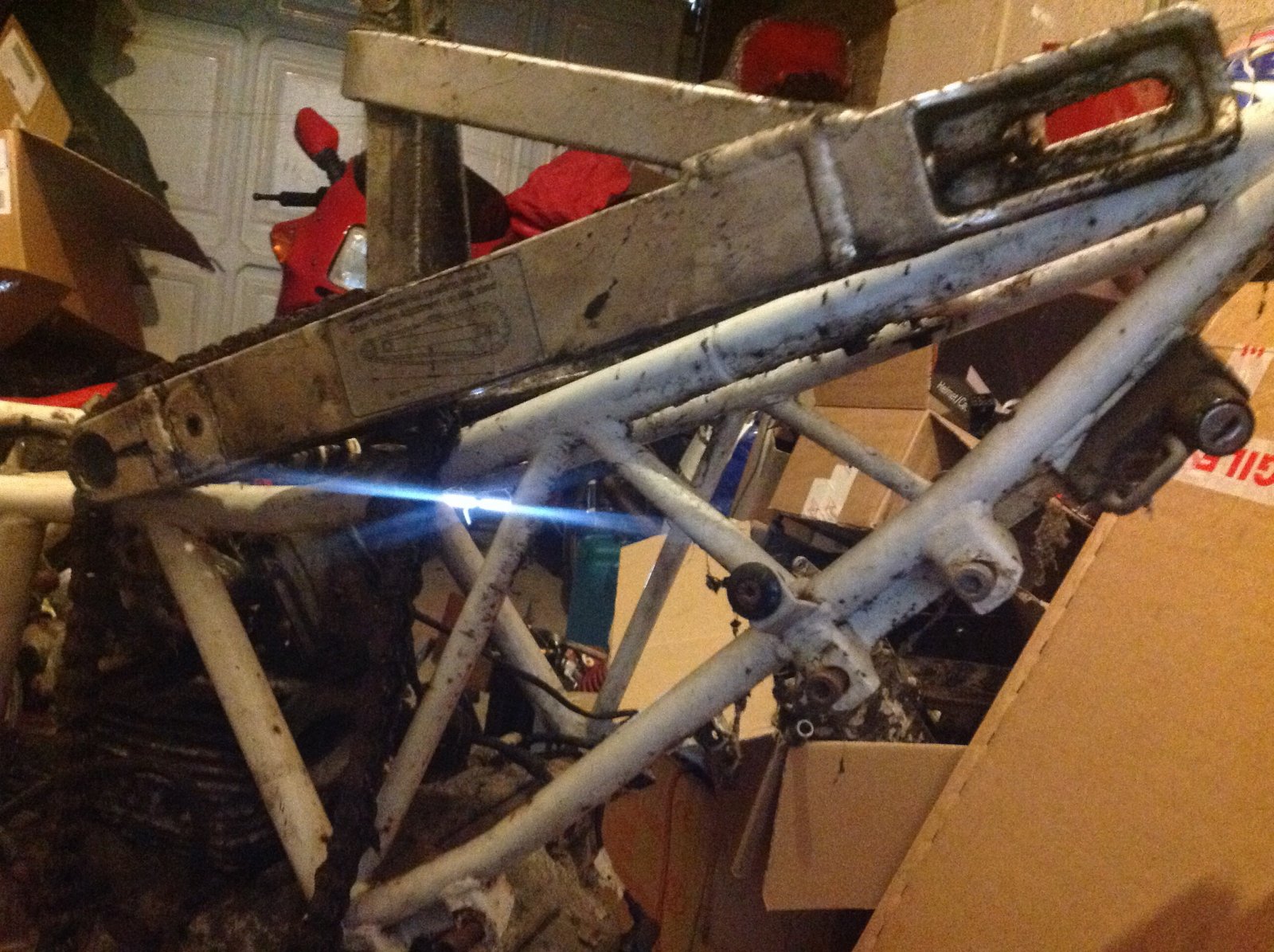

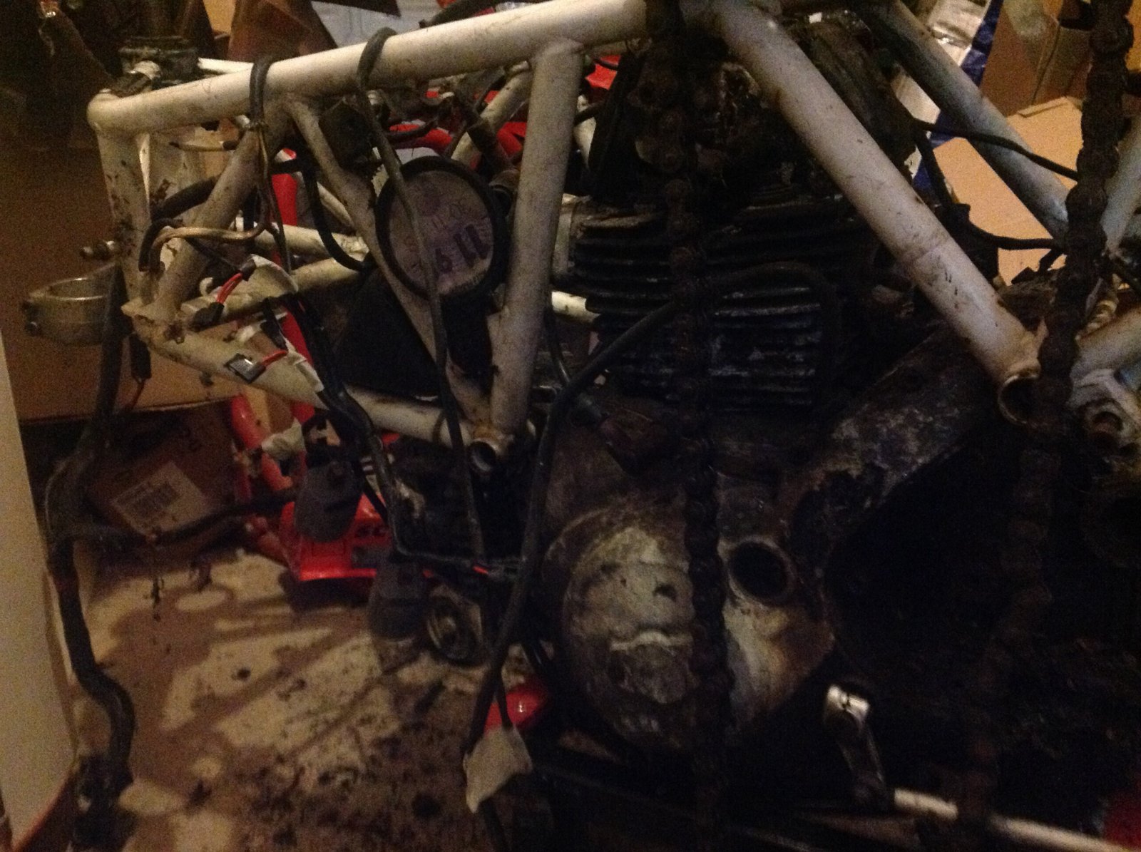

  16. So to answer my own question, you need a 19mm and 17mm Impact socket a dead blow hammer and some socket extension shafts, so we now have the bike in this state
    And the rest of the bike resting on the engine dolly like so
    So next week should see the engine and frame finally separate after 24 years
