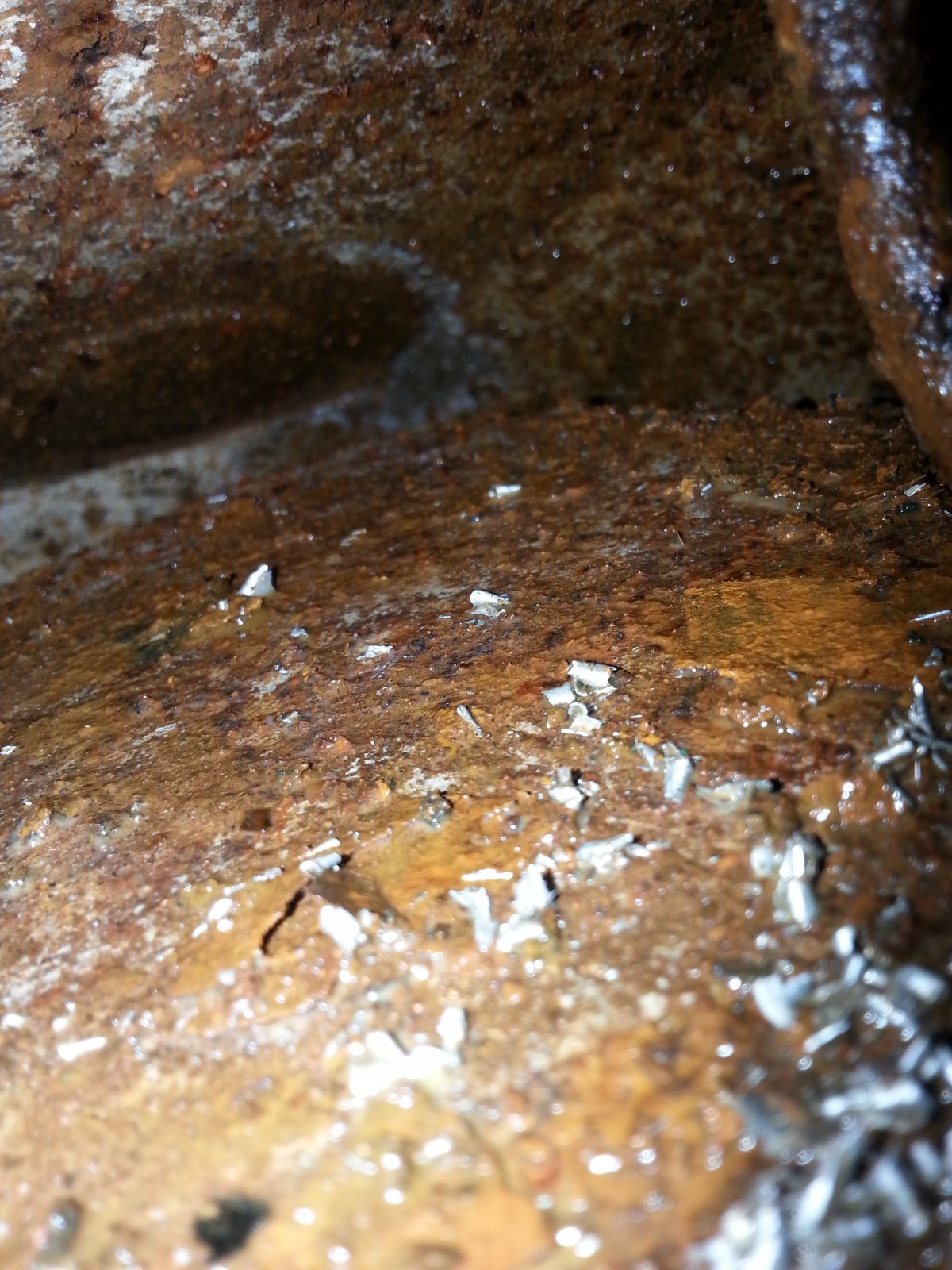

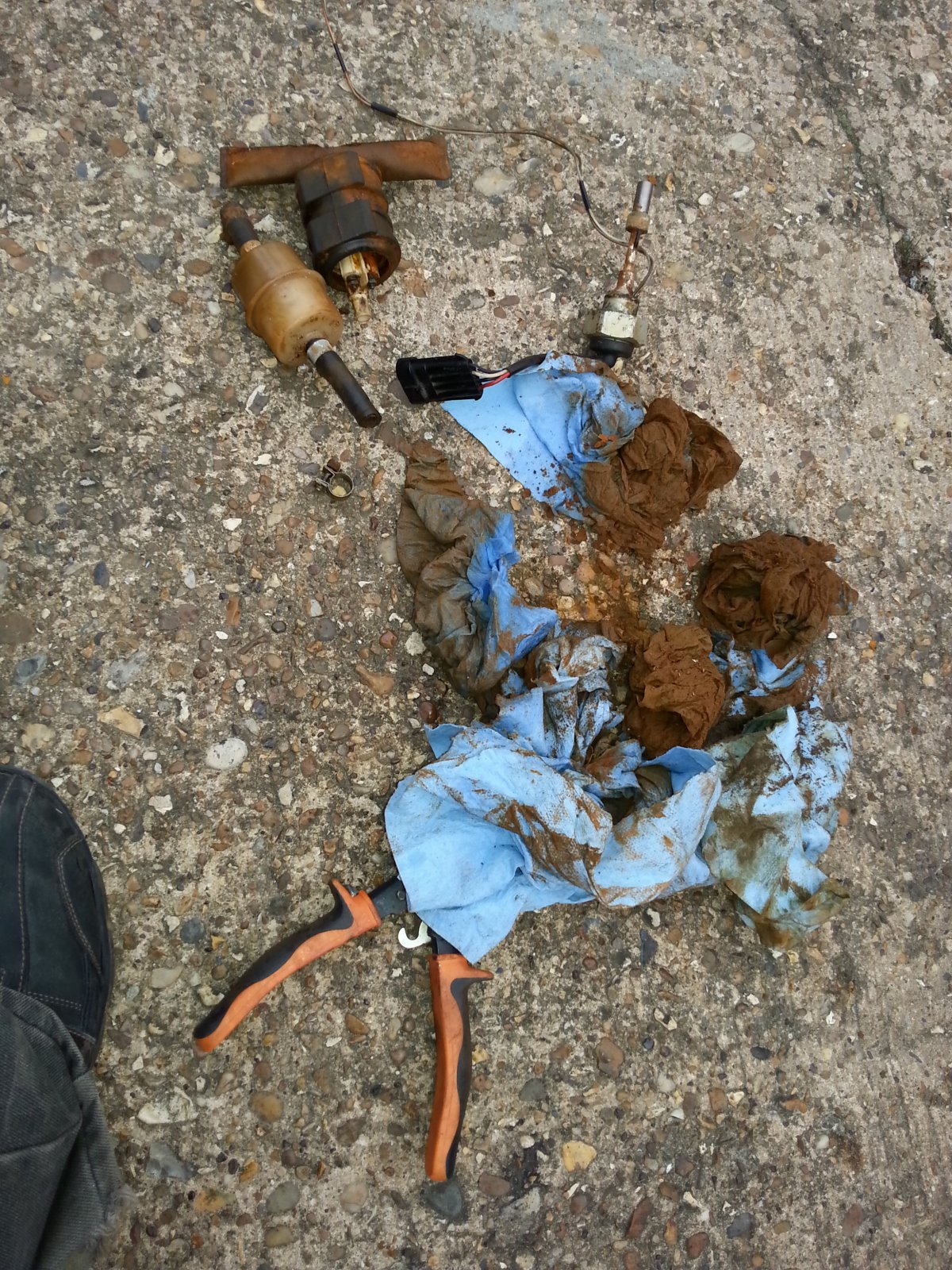

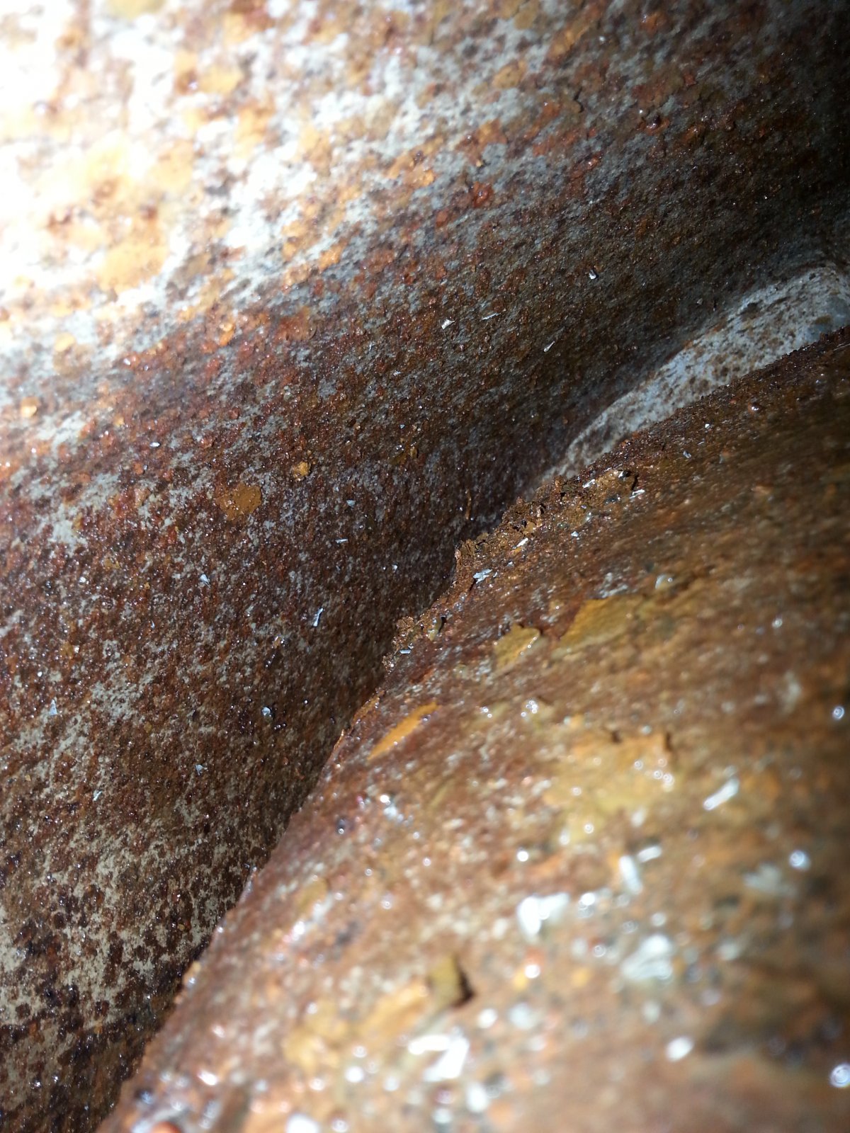

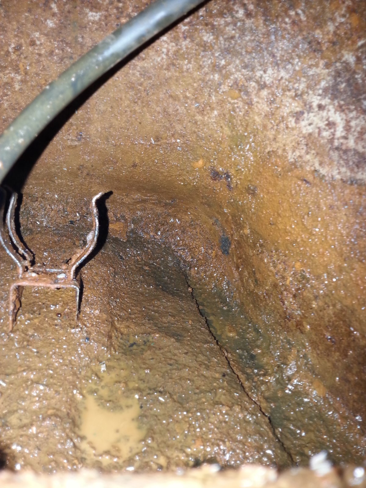

  3. 20150822_192059.jpg 20150822_192054.jpg 20150822_192044.jpg 20150822_191910.jpg So made a bit more progress today. I have finally got the old filler neck out of the tank with minimal damage to the tank. So here's the horror that is the inside of the tank
    The last shot is of the pump and the fuel sender which I think will both need replacing
  4. The bike. Was it ... was it stored in the sea?
  5. LOL.... Not quite but it could have been, it has spent 18 or so years living under a tree along with two other bikes, I've had it in parts for the best part of a year in my garage and I was still getting water out of the very bottom.
    The tank seems very solid, though that could be all the rust holding it together. I had a quick look at the POR15 treatments but quickly got confused by all the different types, could have been the celebratory glass of wine (or 3) that added to the confusion;)
  6. First picture I thought was a couple loaves of bread ;)
    Think the fuel sender has a little life yet and I'm sure someone here will help you repair it :)
  7. I think you are been a bit optomistic...the pump should be ok,mine was solid but after a clean and lube it freed off,mine wasnt as rusty as yours but after i had removed the rust it had holes all over. 20131031_210639.jpg

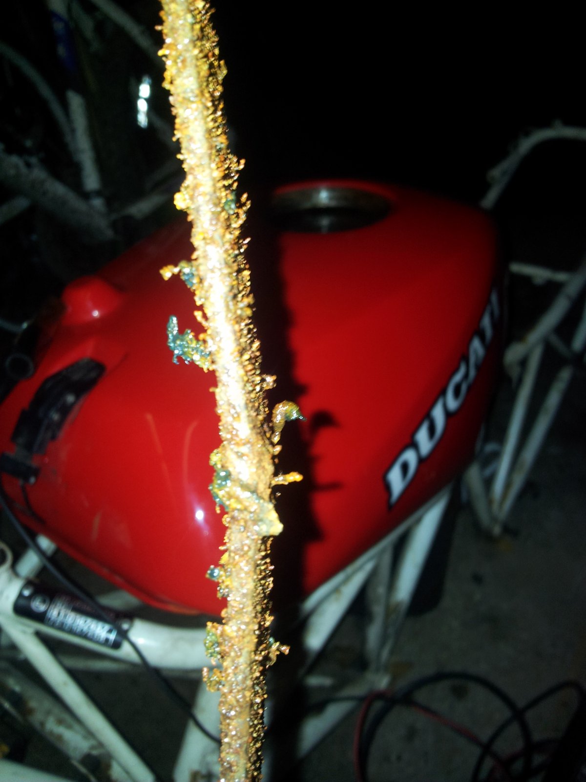

  8. So what is the best way to clean out the rust, some form of chemical clean?
  9. electrolysis (probably not spelt right)
    place small gravel in tank wrap well place in a cement mixer
    very securely and leave rotating then clean out
    I would go for the electrolysis personally
  10. I was thinking of putting a bottle of coke or iron bru round it first as they seem to be able to dissolve most things
  11. What johnboy said is best(not the mixer the other). Just need a battery chargers, water, catalyst and a piece of steel, cleans things up a treat. You will need to fix the holes first!! I then fibreglass resin line mine to stop the rot.
  12. Eloctrolysis works well,there is plent of info on google for this,i would strongly advise against fibreglass resin,use POR15 you wont the full kit with the cleaner. 20131119_182856.jpg
  13. with the electrolysis when cleaned all the crap out
    reverse the anode and cathode and replate the inside of the tank with clean metal
