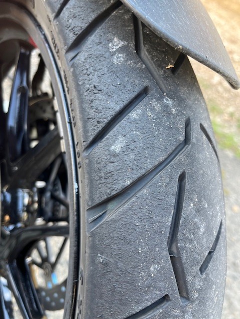

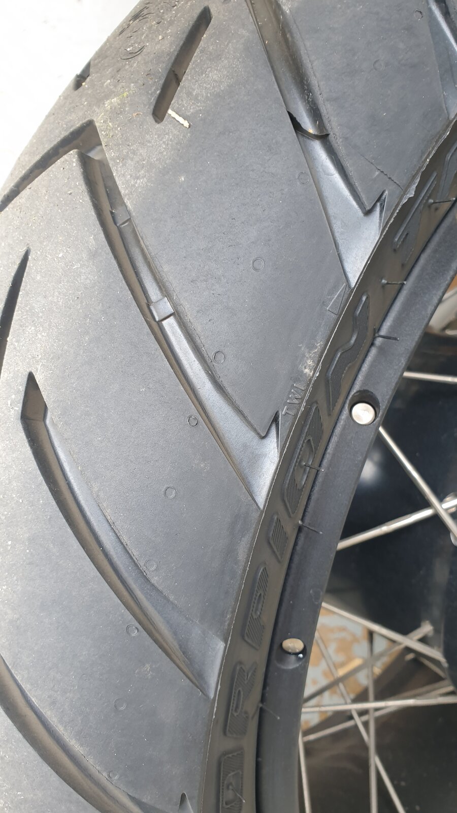

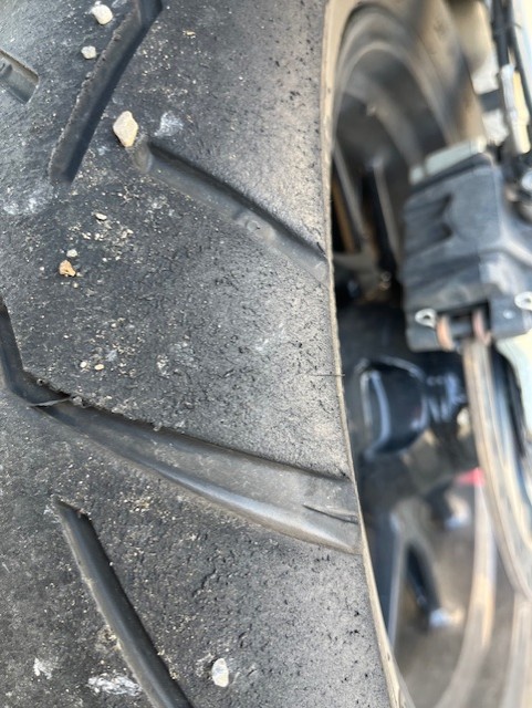

  12. I've got a Rally, not PP or RS or GT. I can see from the tyre wear, the rebound is too slow. I ride on auto preload, and touring pretty much all the time. UK roads too broken for a sport mode if you ask me. Now not having the option to tweak rebound alone, what would you all suggest then?

  17. I’m genuinely interested to see a photo of the wear if you have one so I can learn from it please. However, you’re correct there is no separate compression and rebound adjustment, as Andy says above it’s Hardest to Softest and that’s for the both of them.

  19. Here you go mate. You'll be able to spot sharper leading edge, and round-over trailing edge. Now before you say that's bugger all, this tyre has not done much distance. I'm on my second tyre in the rear due to a puncture. The old(ish) tyre had the same phenomena, just more pronounced.
  20. thumbnail_IMG_0450.jpg thumbnail_IMG_0449.jpg The Scorpions for some reason do deform , normally for me after 1000 miles , great tyres but for some reason the serrate the treads . Conti TA3 ....after 1000 miles and still good 1000 miles later you really cannot get a better tyre to run with the V4s . These were Spain but you can get almost the same in the UK , they just work and will last around 2 to 3 k . Sky hook V4s
