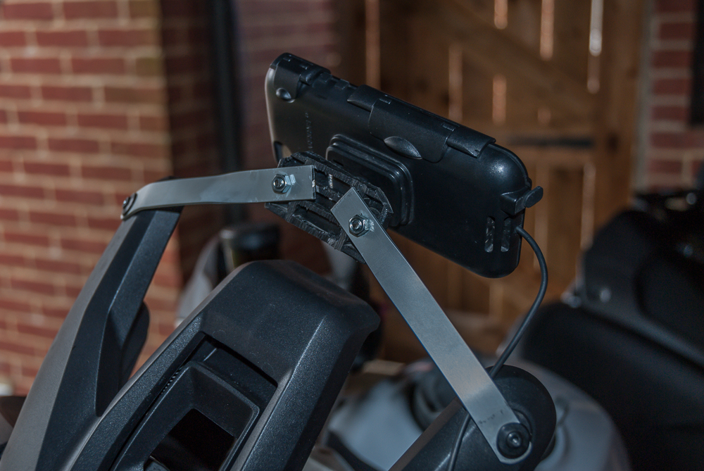

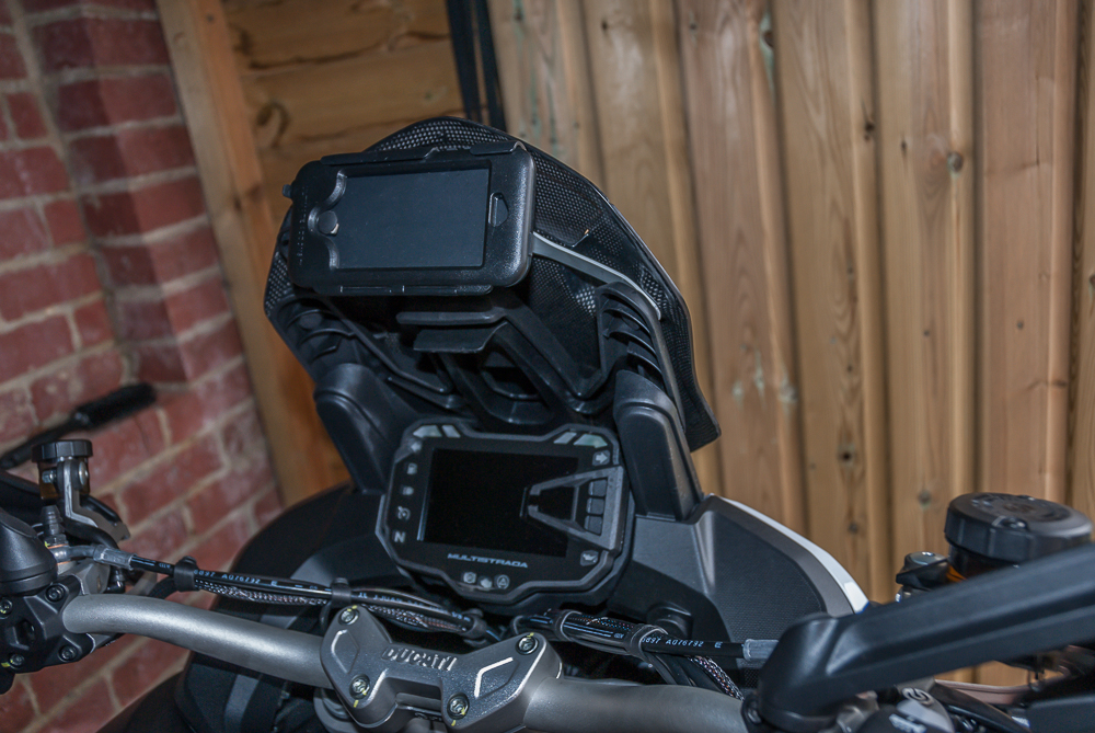

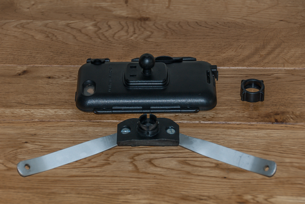

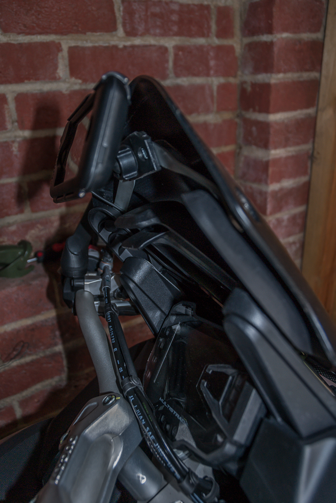

  4. Hi, sorry it took so long to post these.
    I bought an Ultimate Addons iPhone 5 holder that's pretty waterproof (sometimes water gets in when jet washing but never when riding in the wet). It comes with several methods of attachment but I used the one for attaching to the handlebars.
    as you can see I have the Carbon race screen which it sits behind (the top corners of the holder are visible from the front just, I could have dropped it down a bit further to hide it more). You still have plenty of room to grab and adjust the screen hight.
    I bought some lightweight aluminium strips from B&Q (2mmx16mm) placed a small bend at each lower end then a slight clockwise in one and an anticlockwise twist in the other. I cut down the Ultimate Addons ball and socket mount a little but you don't actually have to. the two holes to fix it to the handlebars are well placed for the aluminium struts. The bolts that come with the screen are long enough to hold both the screen and the extra width of the struts.
    I will get round to soothing it off a bit more and sparing them black but wanted to test it out first. after a 300mile round trip last weekend I can say that it worked well, didn't more at all, didn't interfere with the air flow and didn't vibrate. it's at a perfect hight so I can easily read it without ploughing into parked cars.
    If anyone wants more info please let me know.

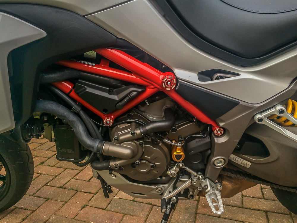

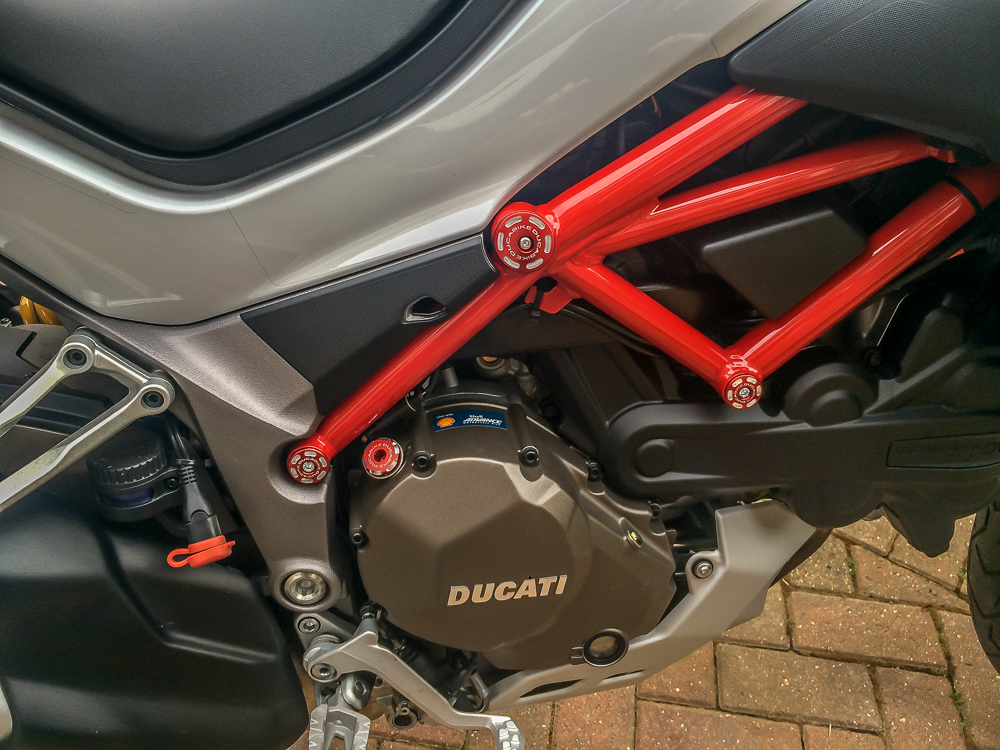

  9. As promised here are the pics with the frame plugs. been on some great and long rides since fitting them and never had the problem again, especially in towns where you find yourself having to keep put your feet down. The Oil plug is also fitted as you can see.

  10. I even noticed the leathers/frame plugs resistance on a test ride. Will be looking into these alternative items later in the year when I get my Mutley. Wish they weren't so blingy though but at least they also occupy the two other unfinished looking gaping holes on each side of the bike.
  11. :eek: Certainly a very 'interesting' approach to the Ultimate Add-Ons phone set-up, however, I prefer the U-A-O handlebar clamp arrangement, which is clean, effective and works better for me.
    Good on you for adapting something that suits you, definitely each to their own.:upyeah:
  12. @ColT what size clutch slave have you fitted and is the difference noticeable..
  13. Indeed. I would rather like to get some properly made plugs; the original rubber things are hopeless. Pity the ones in the photo are so trashy looking - like something a backward 12 year old would fit to his push bike. I wonder if any frame plugs for grown-ups are available?

  14. It's a Ducabike CNC slave that has a larger volume and makes the clutch 30% lighter. really makes a difference.

  15. Way to make friends Pete1950. So far everyone that's seen them in the flesh has liked them a lot and they were all over 12.
  16. Horses for courses, I think these look better, would be even more so to my subjective eye if they were plain (i.e. without the dimples, do they serve a purpose?).
  17. Thanks ColT - I think they look pretty good (and I'm well over 12), and I also like the CNC ones... (decisions, decisions)
