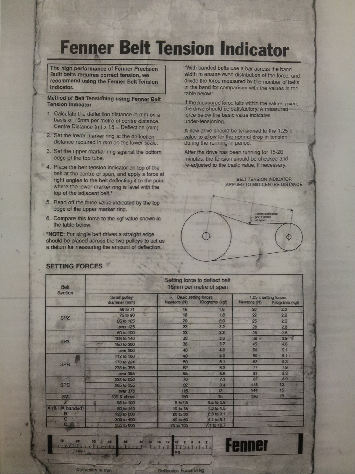

  19. There are many factors to take into account when tensioning belts.
    Here is an example of what I use for belts at work.
