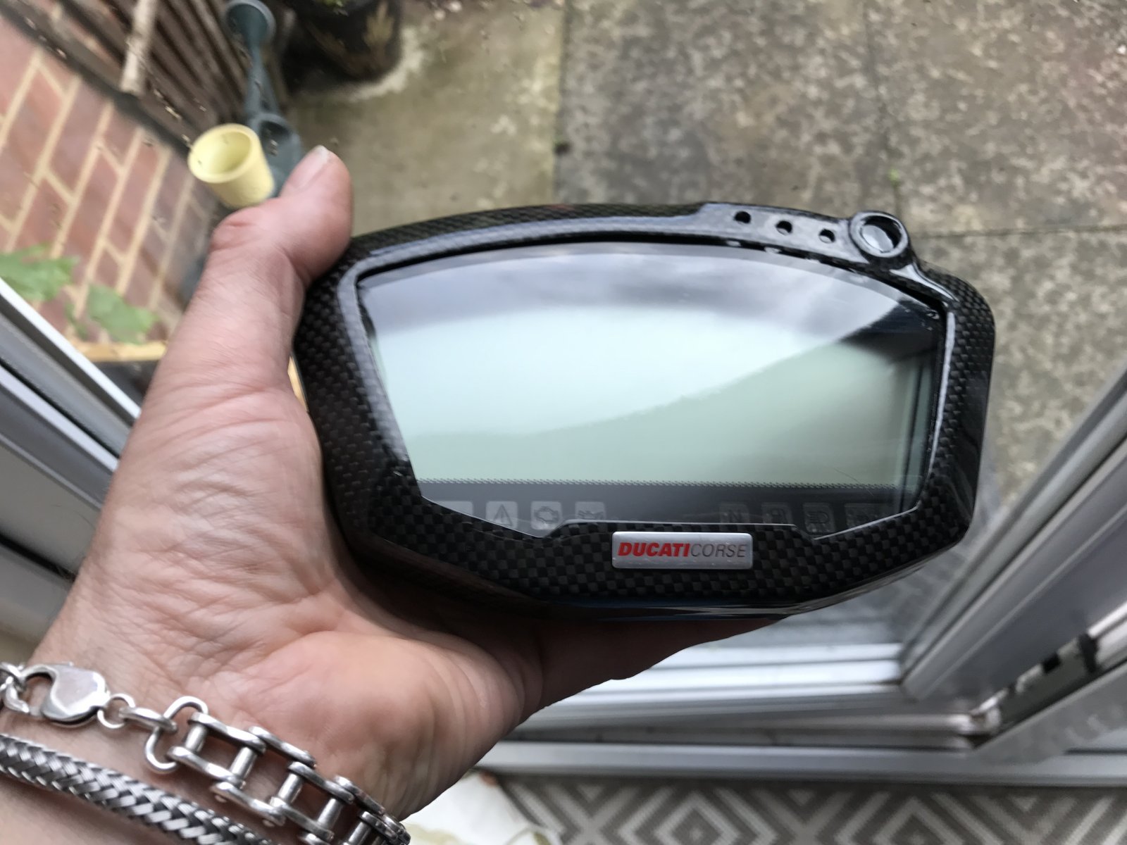

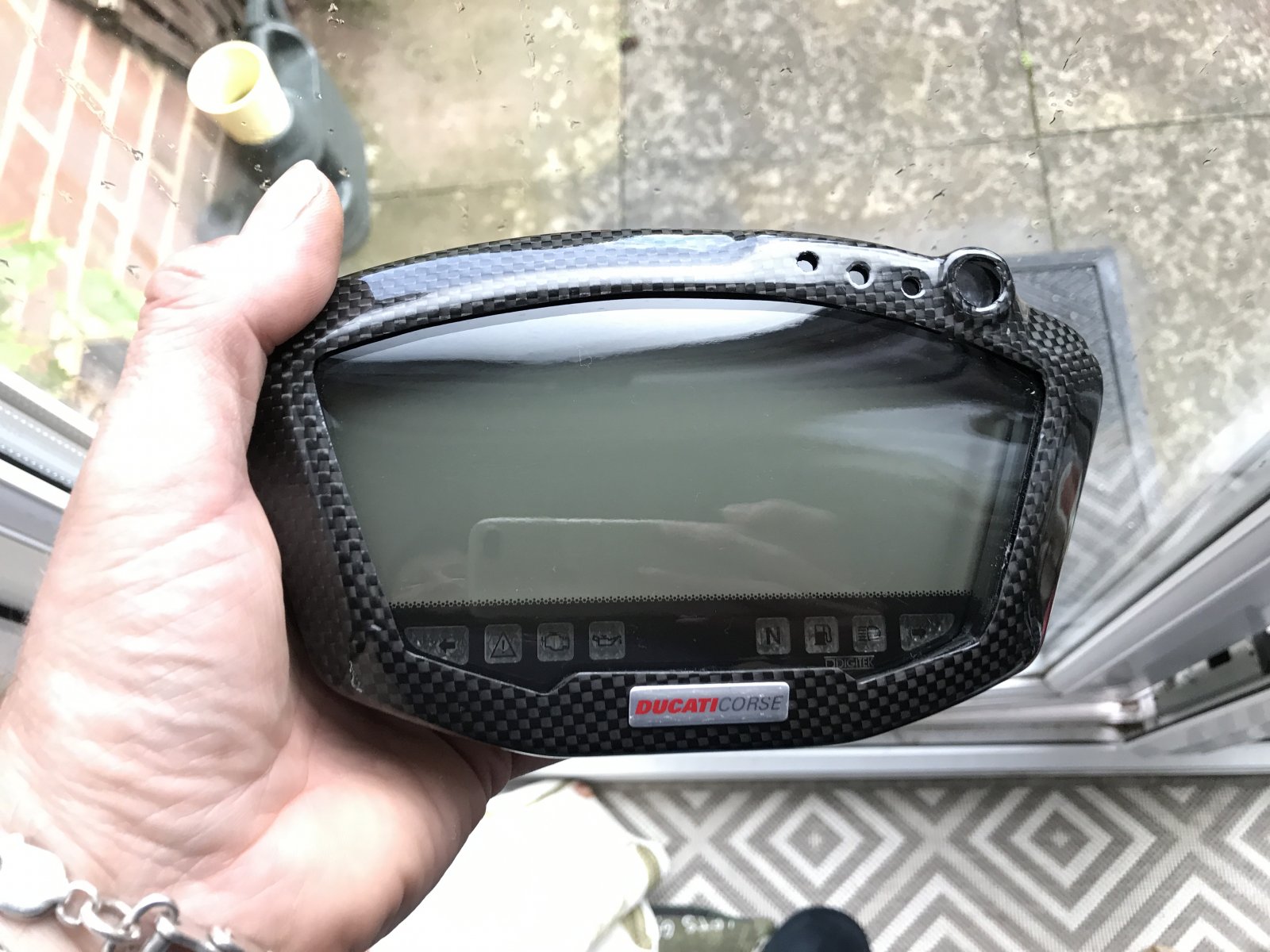

  1. Well it's finished I'm happy I doubt if you didn't know you could spot the fix.
    If anyone wants to have ago don't to be frightened, it's time consuming but not tricky really. A band saw is the one tool that really makes life easy so if you have access to one your laughing as for the oven about 150c is what I found best just keep an eye on it and when it's soft go for it.
    P.S
    Buy enough Perspex to make 3 or 4 so you can practice and use the best one.

  2. looks spot on. mines got a tiny hairline crack so i guess ill be doing thins at some point:(
  3. You want to be using U.V stable perspex or the screen with go yellow as its bleeched by the sun.
    Great job; TLmark'

  9. Making acrylic screens is the easy bit.
    Its cutting away the original screen thats the tricky bit not to mention making it fully waterproof.
    Its one of those jobs that you do at your own risk.
