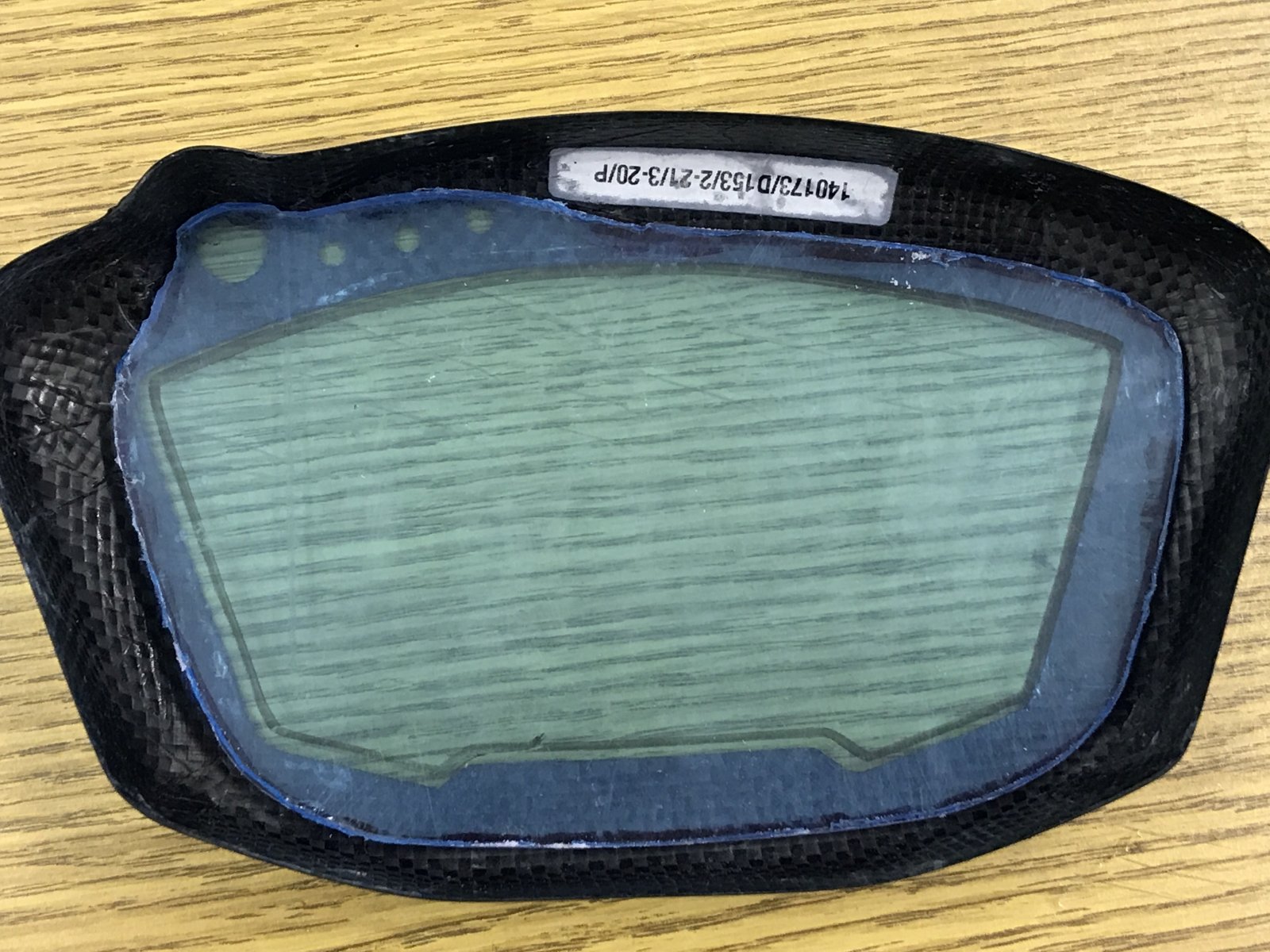

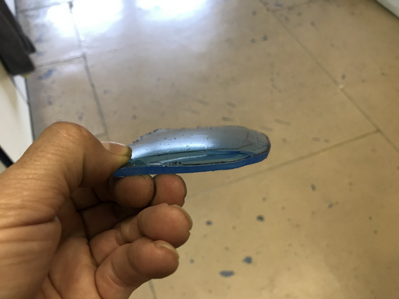

  5. First attempt at forming the new screen
  6. Hi Mark How are you forming it?
  7. Looking good mark, interested in seeing how you get on with this ;)
  8. the stock screen has the crease at the lower edge, so I'm using the same method as in the thread I posted.

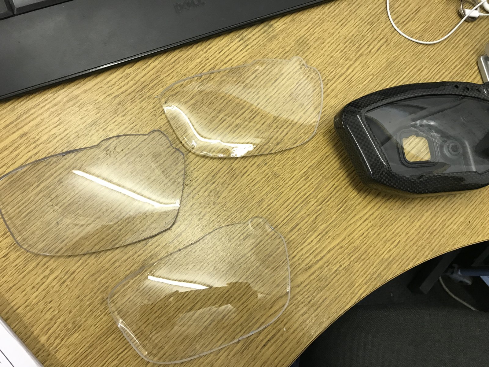

    that is to heat it in an oven. luckily we have small lab ones at my work so this is easy for me to do. the first attempt was with polycarbonate and that takes more heat to soften. I'm going to try some acrylic next. I bought enough sheet to have several goes so I learn as I go.

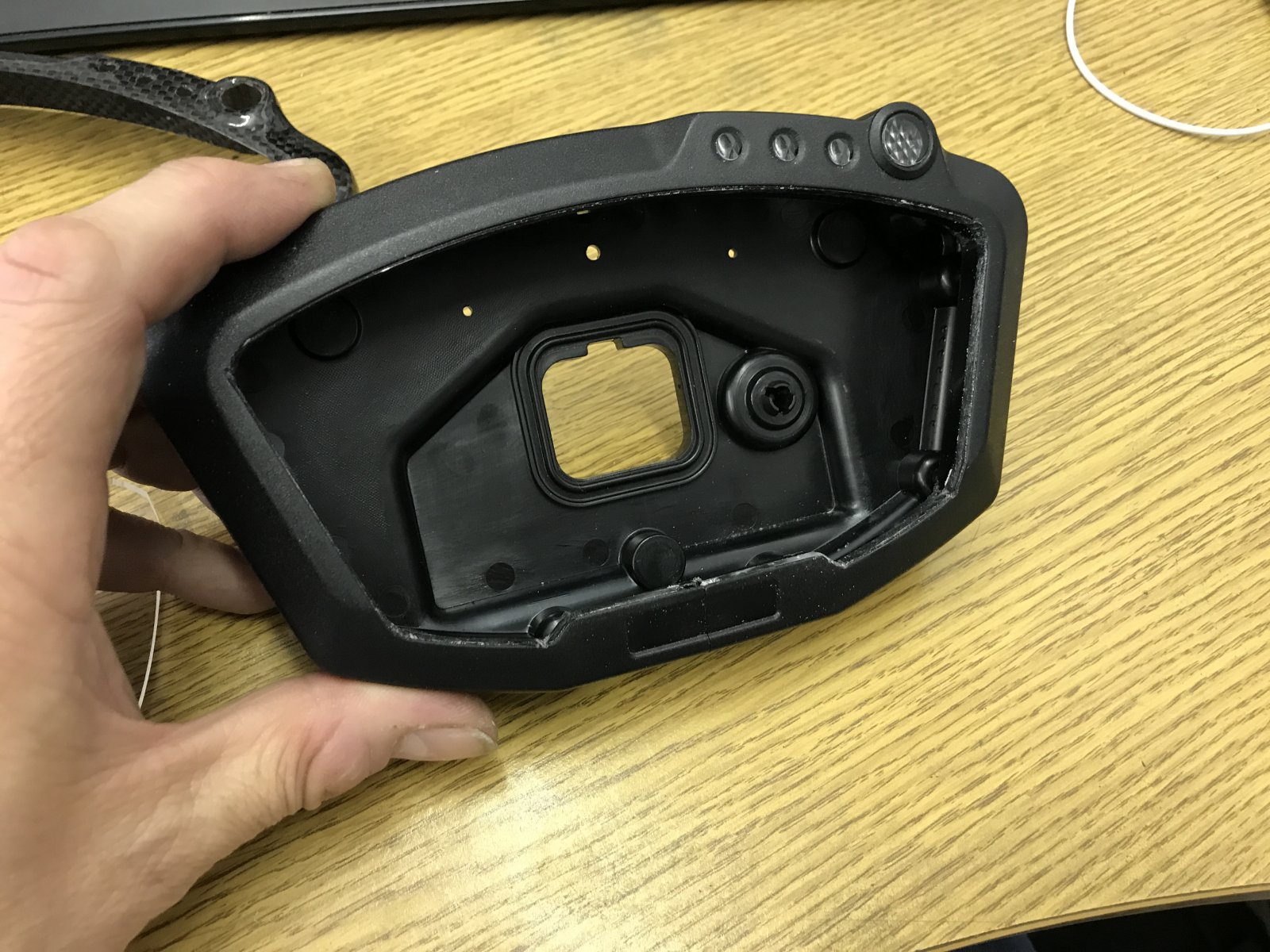

  10. So here is simple explanation of what is involved.
    You cut the Perspex/ polycarbonate up to you. Into a rough shape to fit inside the carbon surround. Then heat the cut out screen in a oven until plyable and force it with the surround over the old dash this forces it to take the shape of the dash and fit nicely into the surround... hopefully

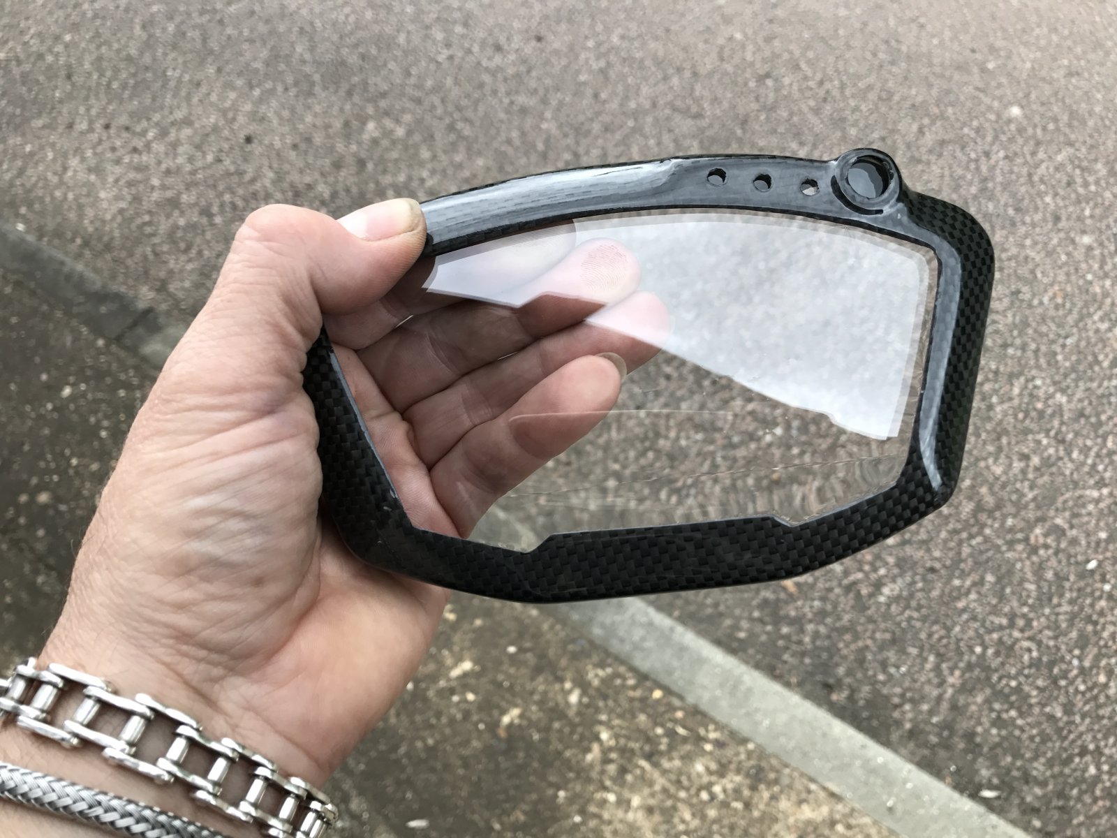

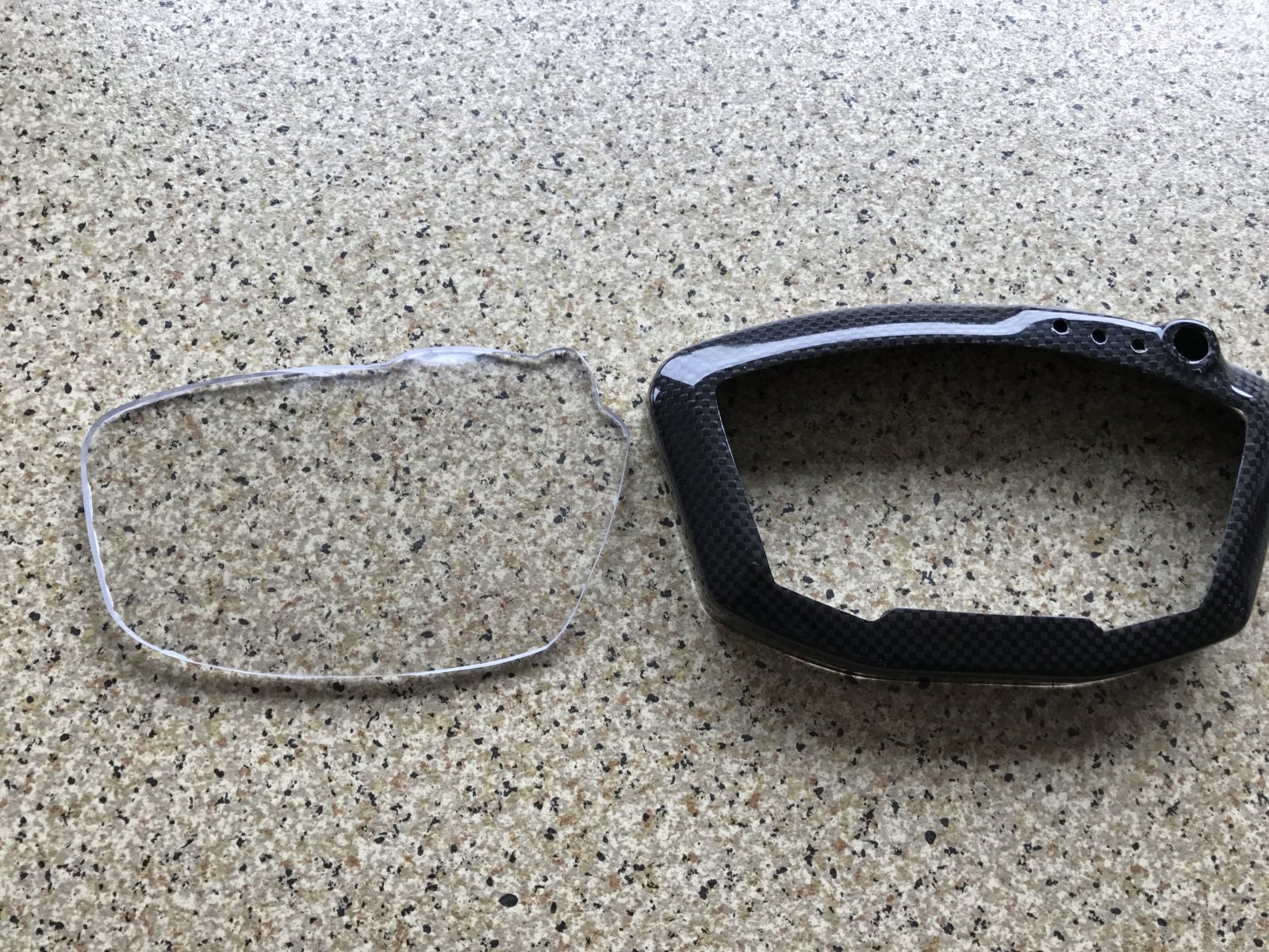

  12. Ok here is the Perspex done. Once the protective film is pull of it looks pretty good
    Next stage is to cut the cracked old screen and then reassemble.

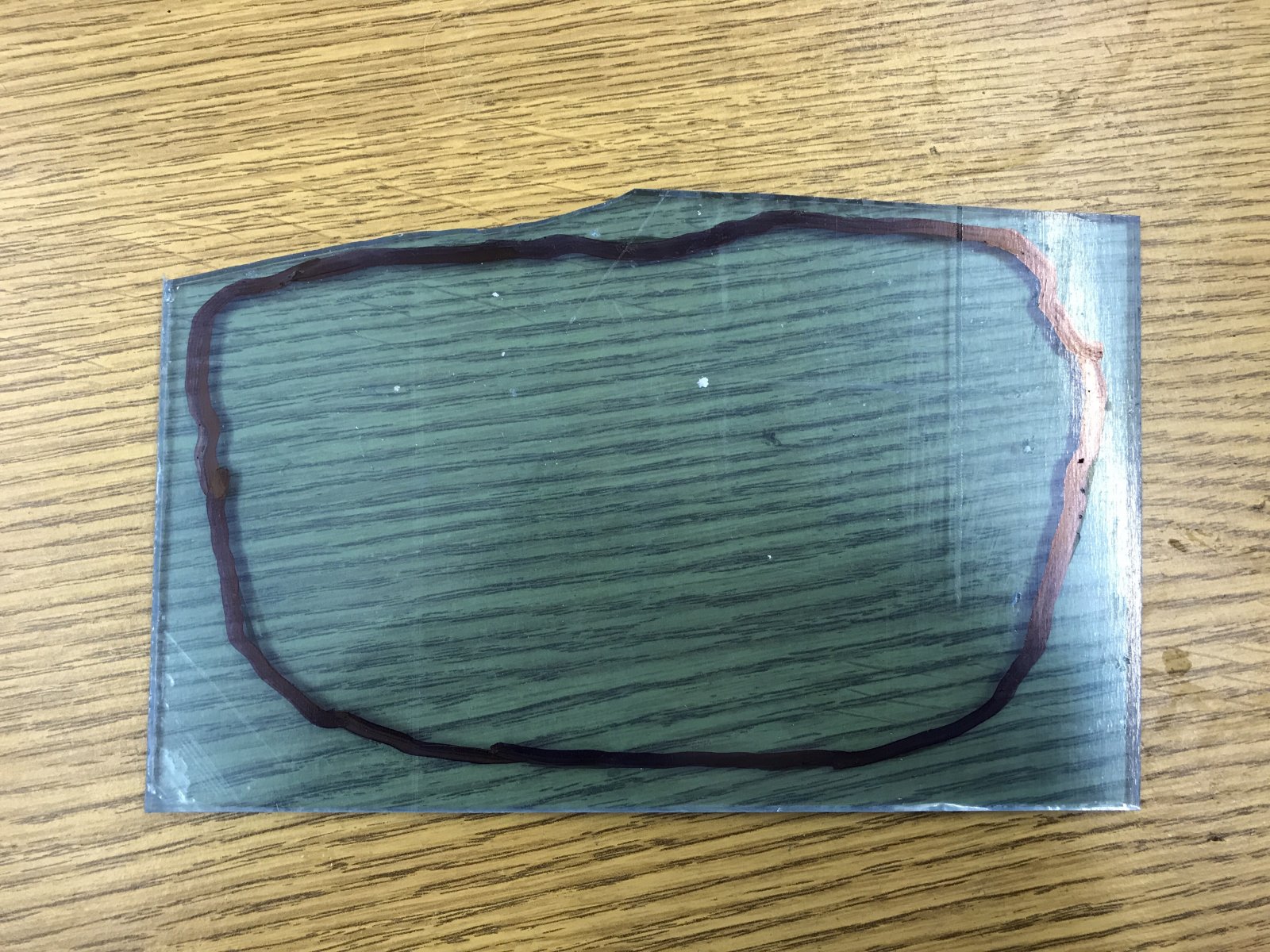

  16. The trickiest part of this is cutting out the old screen. And filing it back to give a smooth edge. I made a few lenses the polycarbonate ones are a no go. It needs to get too hot and cools too quickly.

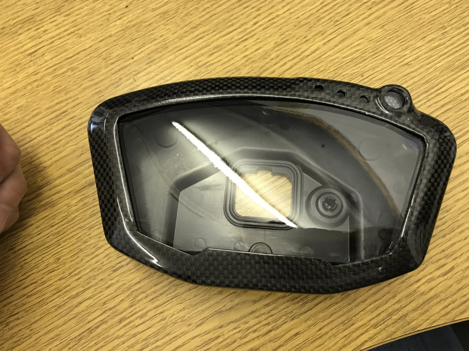

  17. So here it is. It's not glued but you can see much better it looks. IMHO.
    I will put a coat of black paint around where the old screen was removed as some of it showed up lighter the the rest so some paint will hide that.
    I'm leaving the carbon look surround I'll get used to it.

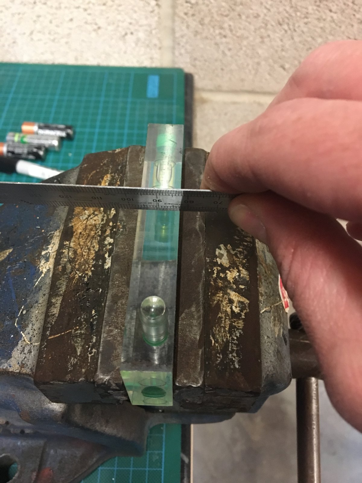

  18. Instead of filing the edge try scraping a steel rule across it, Effectively draw filing it. Works best with the edge of a freshly guillotined piece of stainless. works wonders on plastics :upyeah:You'll get an amazing edge (Apologies if you already know this)

    Draw the rule towards and gets a great edge. What I do when cutting/shaping plastics
