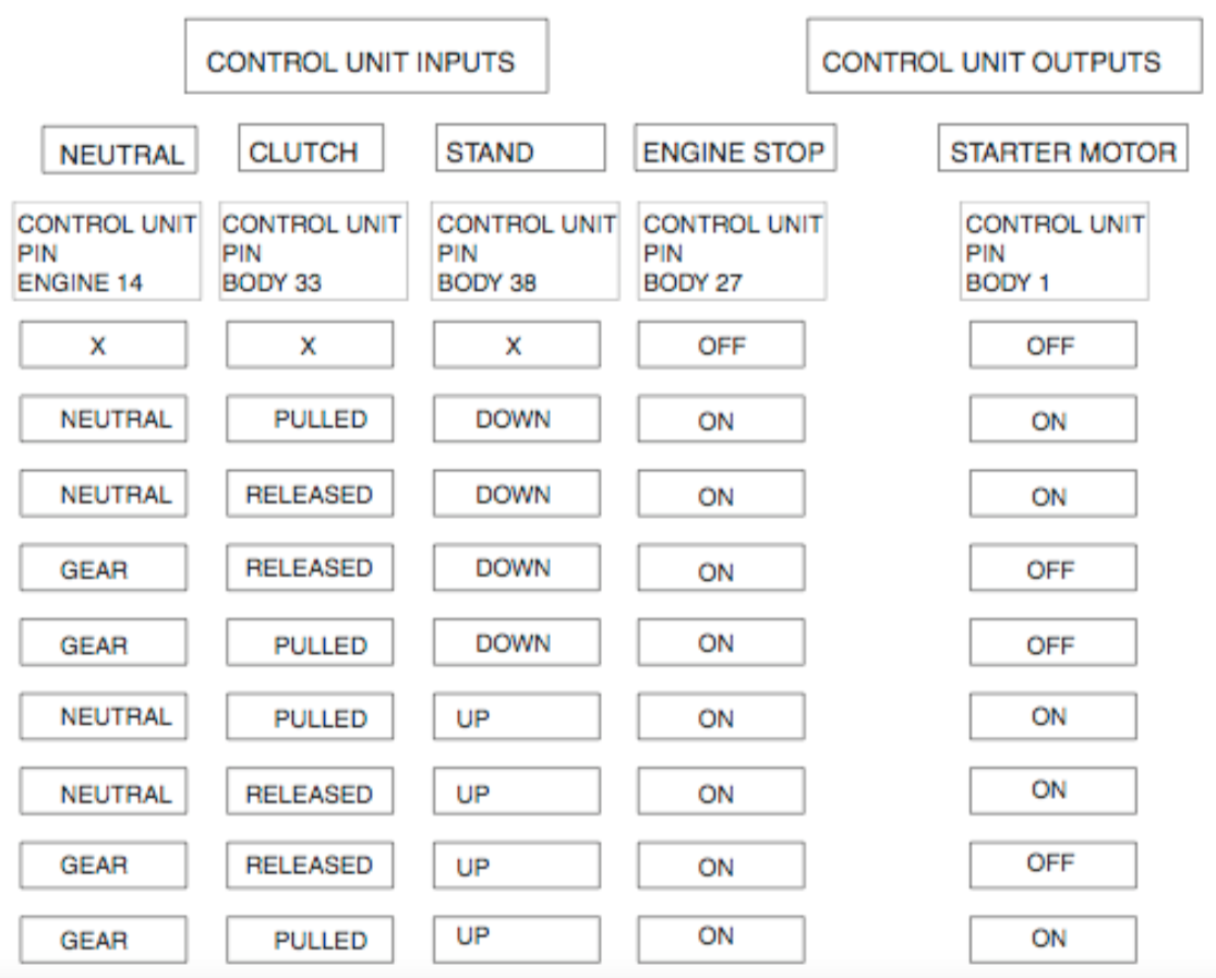

  5. Not correct. The red/white wire to the starter solenoid is ignition switched 12V. The red/black wire to the solenoid provides a ground energising the solenoid when the button is pressed. This ground is provided by the ECU as long as the conditions with regard to neutral, side stand and clutch switch are met.

    • Useful Useful x 2

  7. ok, a negative, grounding 12 volts then, that will teach me to rely on memory, certainly a simple test to do either way.

  16. it feels like some condition isnt being satisfied for spark.
    so far am told:
    1. side stand up
    2. bike in neutral
    3. cps working
    4. kill switch down
    what else is there?
