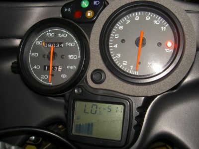

  4. so bike doesnt have a check engine light, just has the fuel pressure light am guessing and that never goes off.

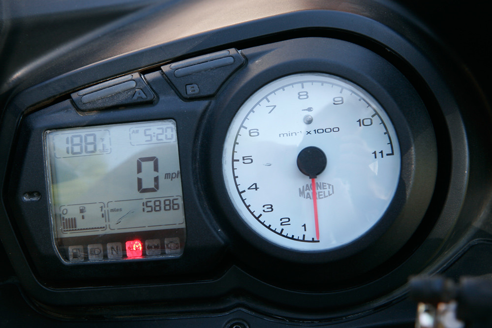

  5. is yours like this?
    sorry, forgot - you supplied image earlier:-
  6. Nah its the old one, 2002.
  7. just looking for a guide to show idiot lights up close. waving the white flag on this one, but will have a search for more details on your instrument, hopefully someone on here can add more.
  8. thanks for your help anyways :) am going to post in the jpdiag forums.
