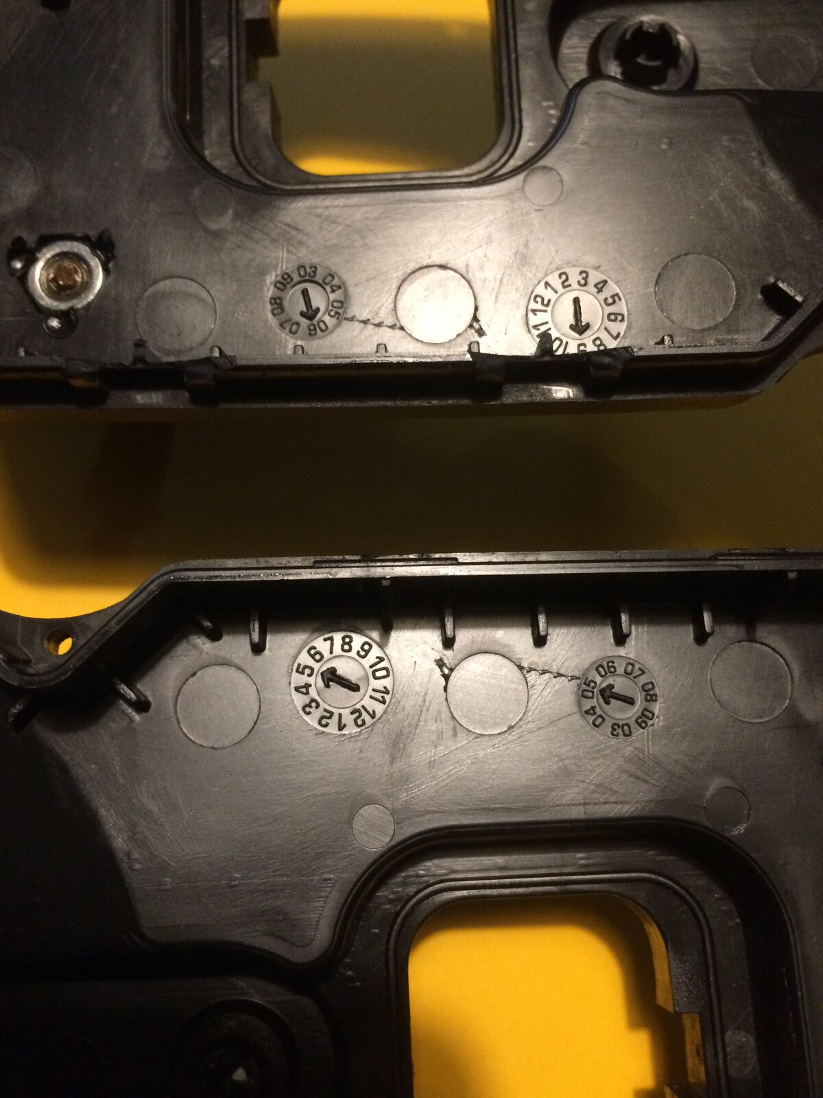

  15. Good news, hopefully you’re nearly there! With this thread in mind, and a rogue engine light problem, I bit the bullet today and split both instruments belonging to my early multiStradas.Glad to report that no corrosion or moisture visible but you can see from the dates of manufacture that both have been replaced in a short time from new (my bikes are 2003 and 2004) confirming the extent of the dashboard problem. 67C833FB-3732-49CE-8BCA-B2589563EBD9.jpeg

  16. my dash was already replaced as part of a km to miles conversion.
