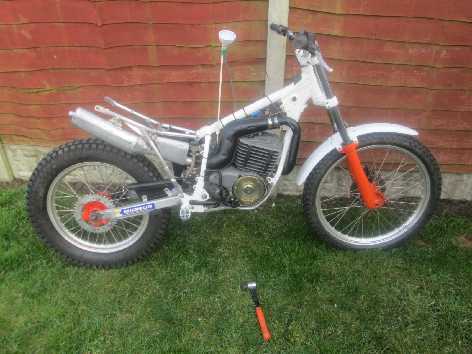

    Coming on.............slowly.
    It`s not all been plain sailing. The rear shock is a Marzocchi Duo with a remote damper control. I removed the spring to get it powder coated and then dropped the shock, this broke the flexi pipe. It`s going to need a full strip down to fix it.
    One set of bearings in the suspension linkage came out easily, the other set required my mates 50 ton press to move them. The first set wern`t particularly worn but at £1.90 each it would have been silly not to change them. The bearings that were stuck had most of the needles missing so were well over due for a change.
    On the good side, the crankshaft oil seals are done, the engine is a 249.4cc not a 212cc, so this makes the bike a Fantic 305.
    I`m waiting for a new chain rubbing strip for the swingarm then that can go back on. I will then have to face up to repairing the shock, can`t believe I dropped the bloody thing.

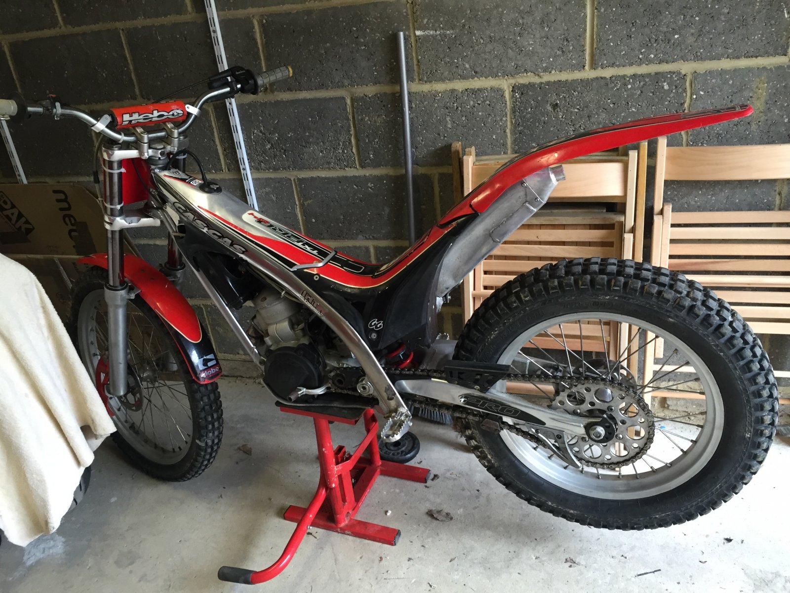

  8. Off the bench and on it`s wheels, well, one wheel.
    The front brake was dead easy to bleed, probably the easiest I`ve ever done.
    The Marzocchi Duo shock ended up being uneconomical to repair. As well as the damage I`d done when I dropped it, the piston rod was bent as well. I`ve got a second hand aftermarket shock that fits so that`s ok.
