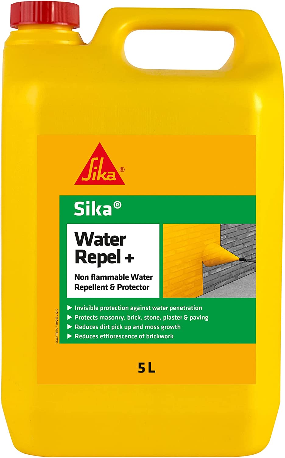

  16. I've seen exactly this, not saying it is the same reasons, but just the same results... The shortest distance from the outside to the inside is exactly where the damp is seen. We have a house that has been waiting for exterior cladding/rendering.. and when the wind blows the rain in a certain direction it causes the damp to make it diagonally through the blockwork. Personally I would be treating the outside of the house around the window area with a product such as this:
    https://www.amazon.co.uk/Sika-SKWATREP5-Water-Repelent-Kit/dp/B01JYXFRCY/ref=sr_1_60?keywords=sika+waterproofer&qid=1680624869&sprefix=sika+water,aps,427&sr=8-60
    In fact, now that I think on.. we were getting the same issue in the bottom corners of the inside bedroom windows.. the water was coming through the stone window ledge...again shortest distance from outside to inside...:upyeah:
    Edit: PS: bloody 'ell that 5L container is actual size...:D (sorry cut n paste)
  17. That’s a hell of a lot cheaper than the Storm Dry I used! Wish I had seen it at the time!
  18. Sika is a good brand, used by the pros here in France :upyeah:
  19. We’re on certain tasks only allowed to use Sika, we switched to 3M briefly but had a lot of issues with their product.
