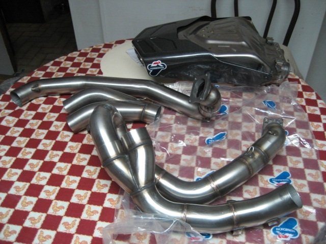

  12. I'm pretty sure I know now. The one with the angle to clear the rear shock had to go on the vertical cylinder. That's the larger header.
  13. I'm pretty sure I'm sure I don't know what you mean :Happy:
  14. Ill try that again in English!
    The two headers (54mm full system) are different lengths and have different angles. I couldn't work out which one went to which cylinder. I now know, for sure! The smaller straighter one is on the horizontal cylinder and the longer one with a bigger angle goes to the vertical cylinder. This angle is to clear the rear shock.
  15. Try again?
    He thinks he has the same length as in the serpent system - this is what I have (70mm) and I'm still unsure if it will fit as I've read different opinions. The small pipe on the asymmetric system goes to the rear vertical cylinder and the long one to the front.
  16. I've got this system
  17. That looks like a 70mm serpent system with equal length tubes like mine. :Happy:
  18. It's a 54 mm mine. I've measured it with my verniers. Thanks for the info, I've finally worked out what system I have! Looks doubtful that its going to fit my black swing arm though. Guess ill be going down to JAC - Wayne Jackson in Nottingham to get him to fabricate my link pipe.
