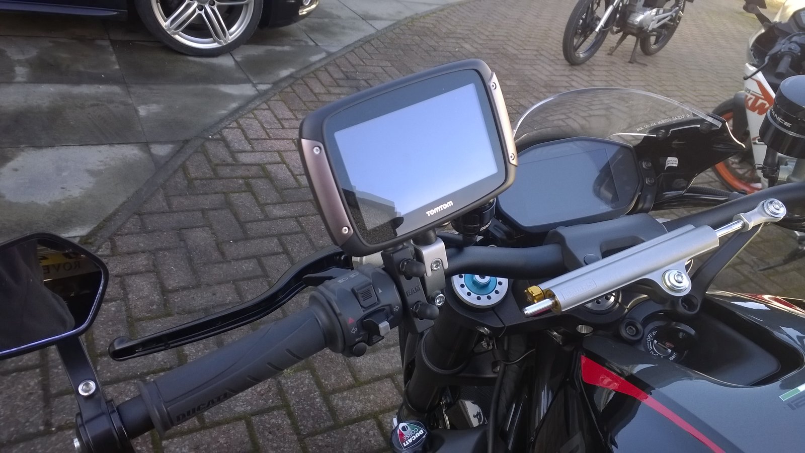

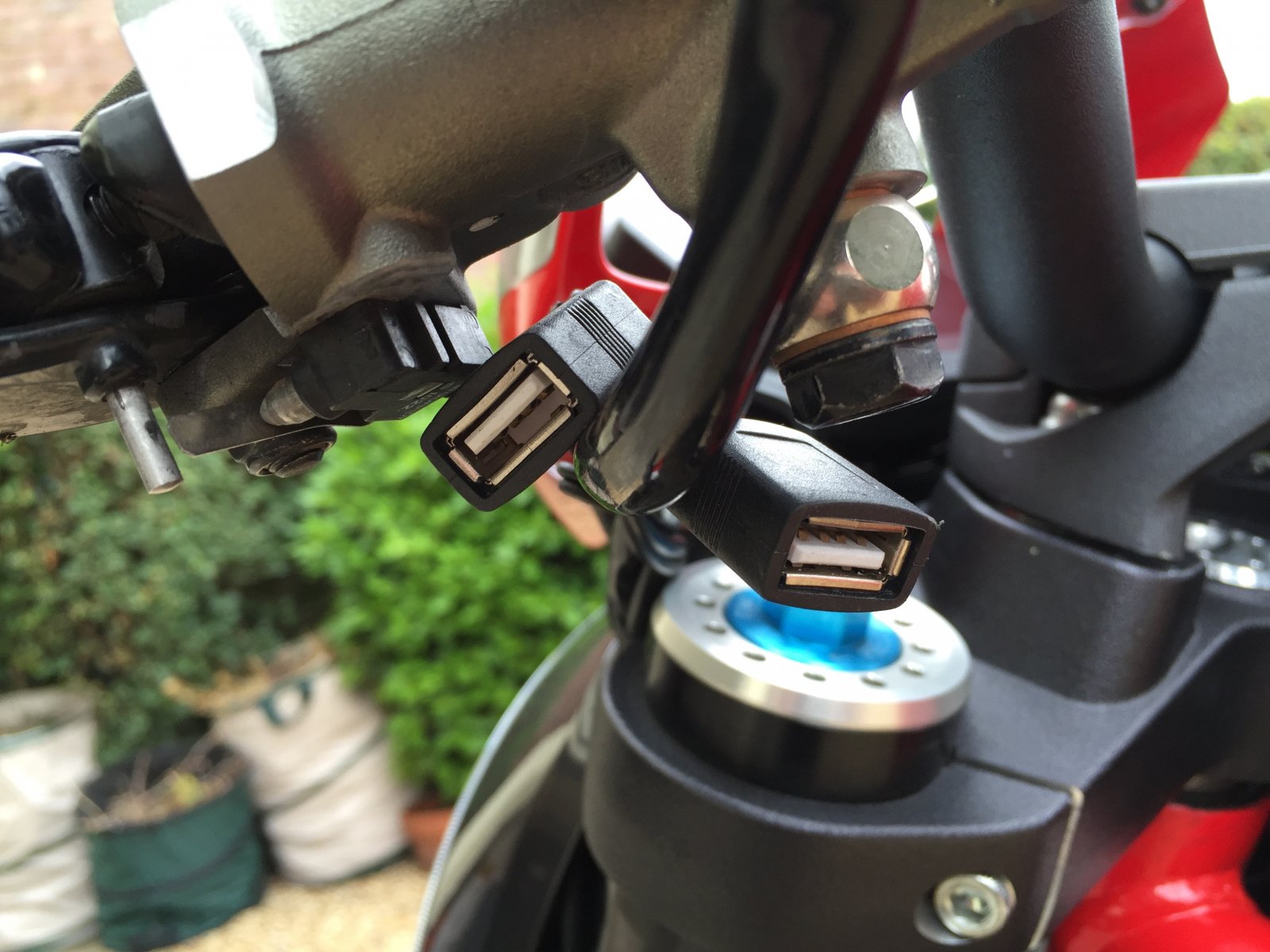

  9. Success. Soldered in a feed for the new TomTom and one for a neat little handlebar mounted usb port. Both working fine and the fact that its switched with the key is great...no flat battery.
    Thanks very much guys, great info and great solution.

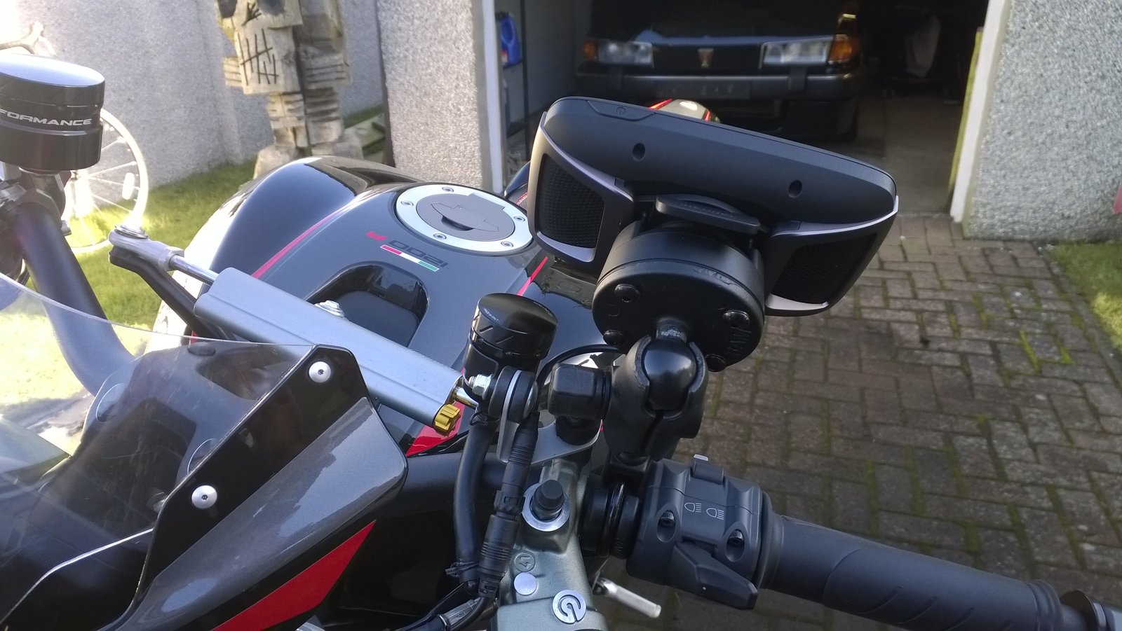

  11. Good to see a solution here. I need to do the same thing but didnt really want my satnav/phone holder hanging off one side of the handlebars. I realise there are not many other options tho.
    Would there be any way to mount a ball/ram mount off that steering damper fixing? Just wondering as might keep things more centralised and out of the wind as such. Im also keen on any advice for a decent waterproof holder for a iPhone 6S
  12. PM me. As I've paid up for a Tomtom I don't suppose I'll be needing my 6s mount any more. Yup it's waterproof and mounts on a Ram ball mount.

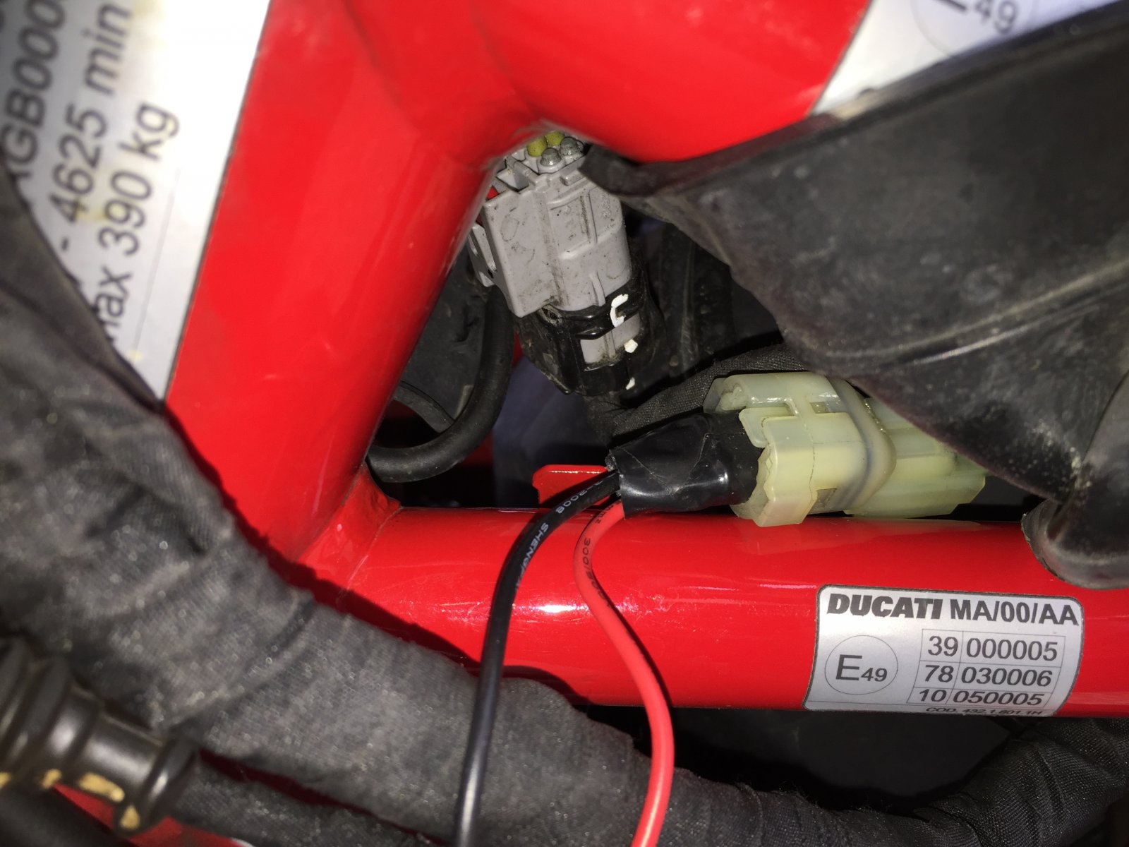

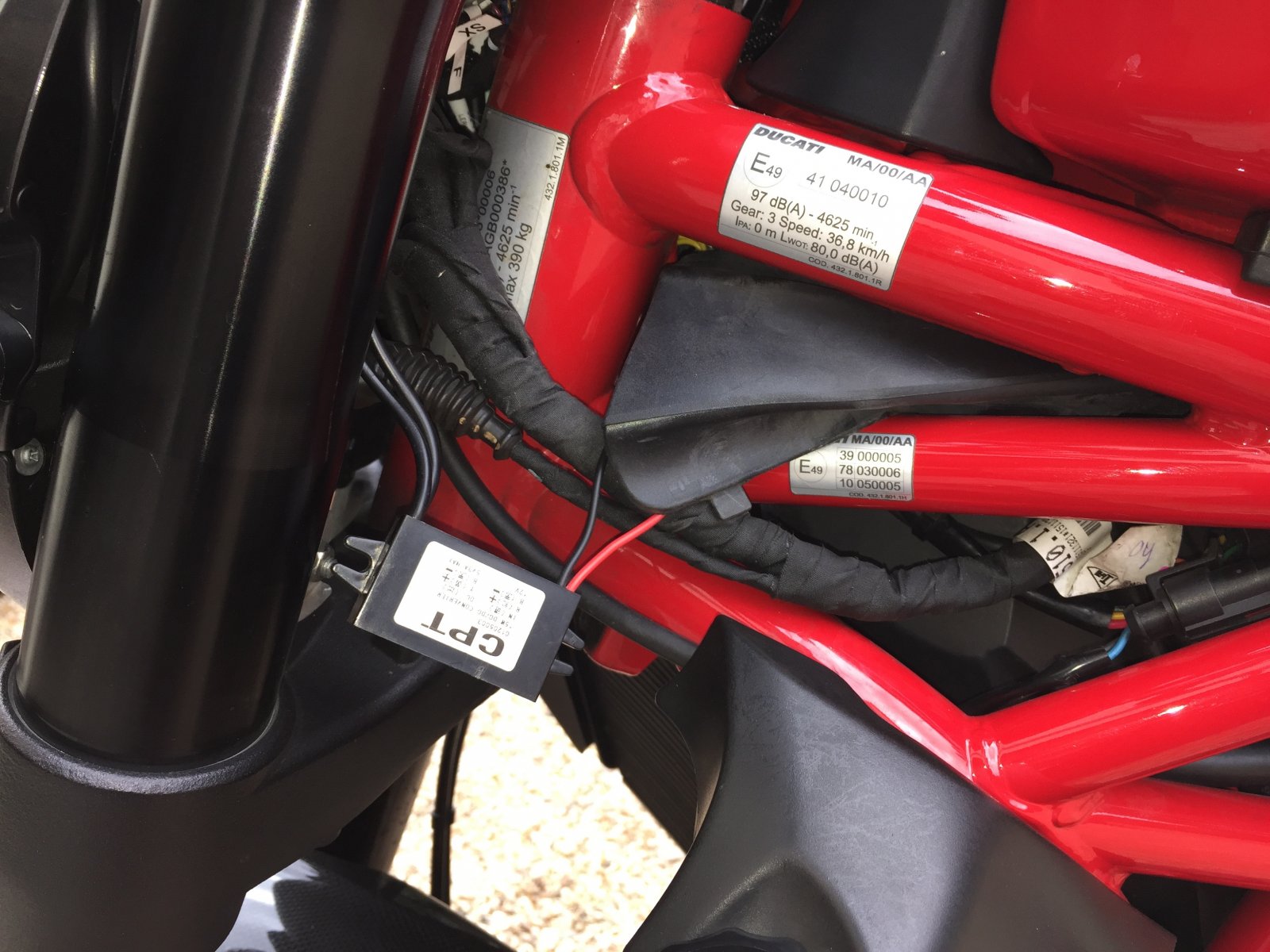

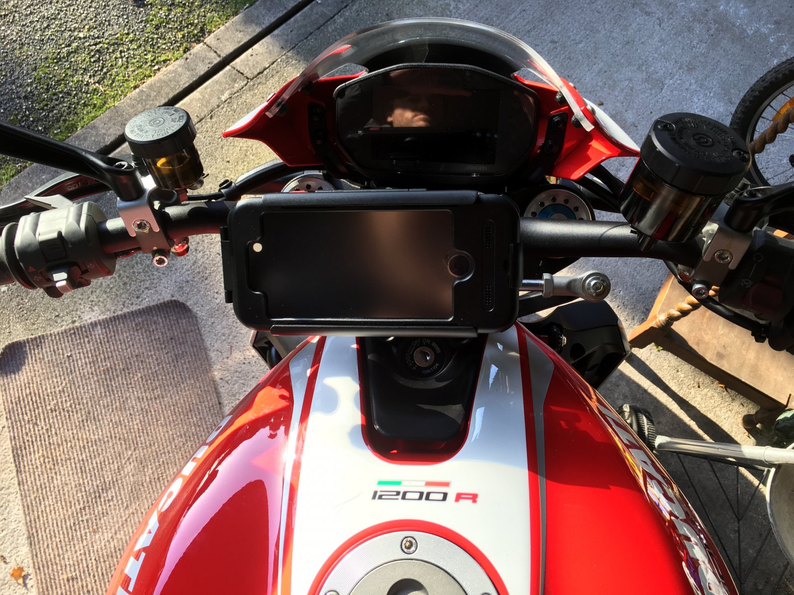

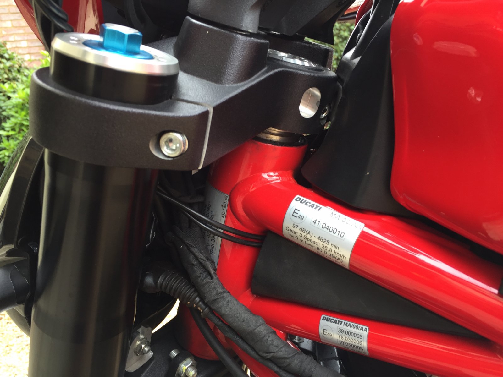

  16. Not a bad idea... In the end I went with the waterproof tigra option mounted on the RAM... with a sumitomo plug and a waterproof USB feed which I mounted on the frame on the right side. I just plug in a wire to it when I need some juice for the shat nav. See pics..... Cost about £26 all up

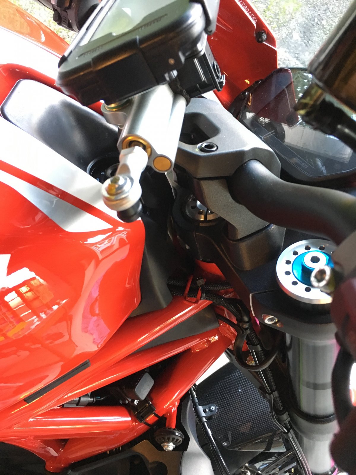

  20. Would just like to say a BIG thank you to everyone who posted on this thread. Fitted my SatNav to my bike with no problems at all. Wired it into the plug on the left side of the frame. Made easy by all the previous posts. Now ready for my trip to the Aragon MotoGP. WP_20180210_001[1].jpg WP_20180210_003[1].jpg WP_20180210_004[1].jpg
