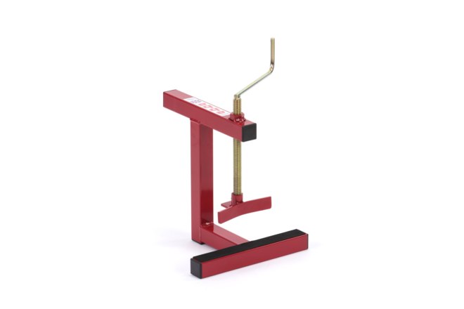

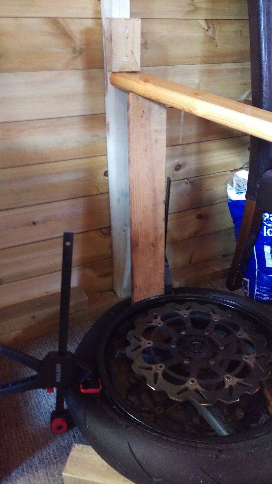

    On breaking the bead .. at first I used a diy system much like the "shed wall" arrangements that others have pictured (I particularly like the one with the hinged "pusher" fixed to the lever, btw).
    But on recommendation, I bought an Abba bead breaker and I'm well pleased with it, on three counts.
    1) It works very well and eliminates the chance of slipping with the lever.
    2) It was relatively cheap.
    3) It is much smaller and simpler than most types I've seen and is therefore relatively simple to store in an already crowded shed (they're all crowded sooner or later).

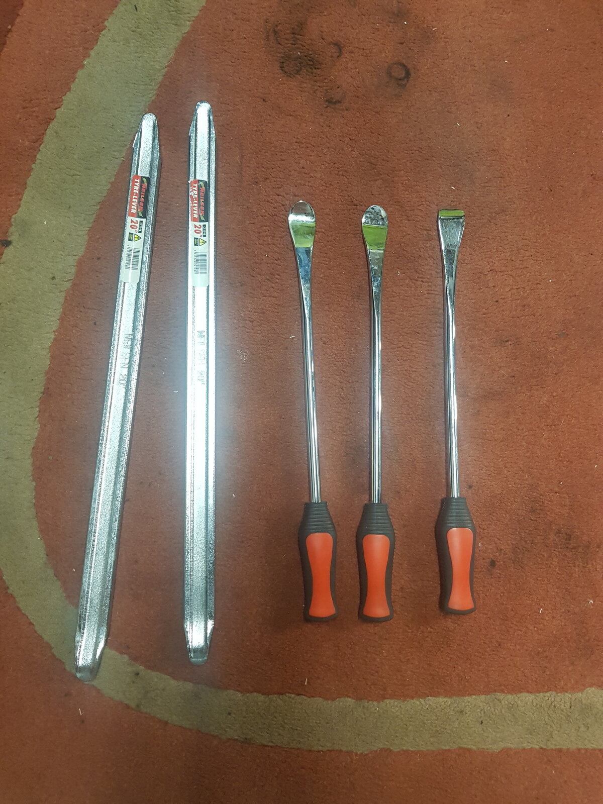

  6. Ok here we go....first ive got one of these....
    To break the beads. Then these to get the tyre off...ive got more levers than i need as i dont think 2 is enough...sometimes ive used up to 4 but it just makes the job easier...
    Again most people use 2 but i put 4 in as you never know where youre going to need to put a lever in to get the tyre off...

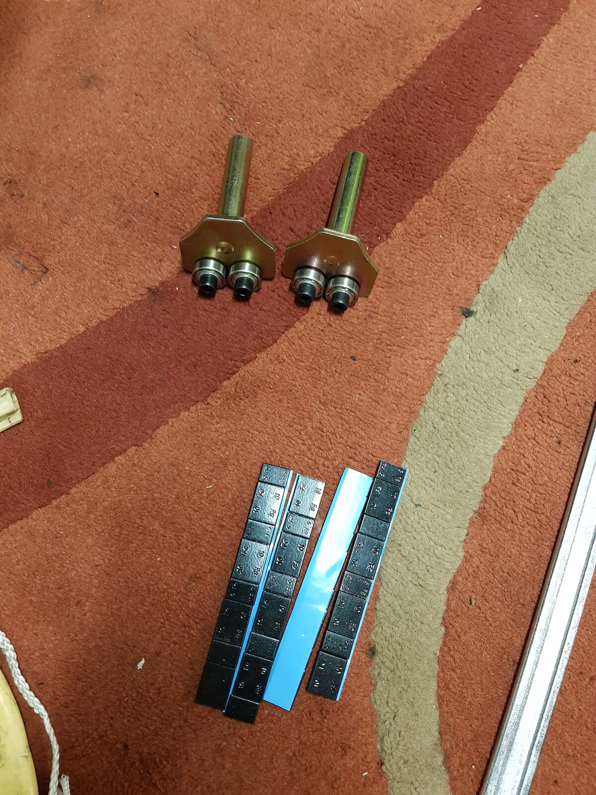

    At the point i break the beads i wipe a thin amount of WD40 round the bead so the levers slide in easily and, the tyre comes off easily....ive got these paddock stand mounts for wheel balancing along with weights but, i did order a roll of 3m tape and up til now ive been using the same weights and just putting new tape on them...

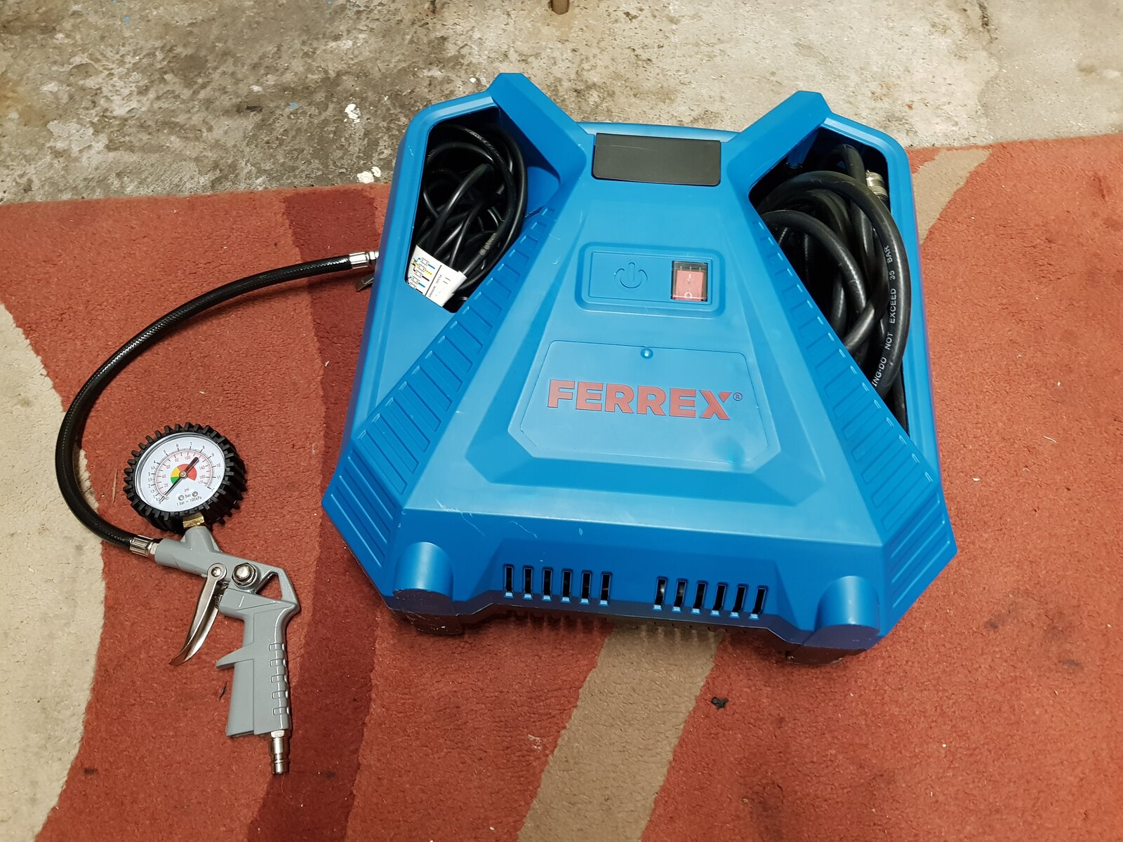

    This one thing made the whole job easier....when you break the bead on the tyre and are getting the tyre off on the opposite side of where youre going to put the levers in, make sure the bead of the tyre is located in the middle of the wheel - this means youll get more play on the opposite end where your getting the tyre in (makes everything way easier) same goes when putting the new tyre on....finally this to inflate the tyre...got it at Aldi on the special buys - 50 quid. A bit noisy but you only need it on for a few mins....its got the legs to push out a 200 section tyre so 50 quid and very small it was a fucking bargain...

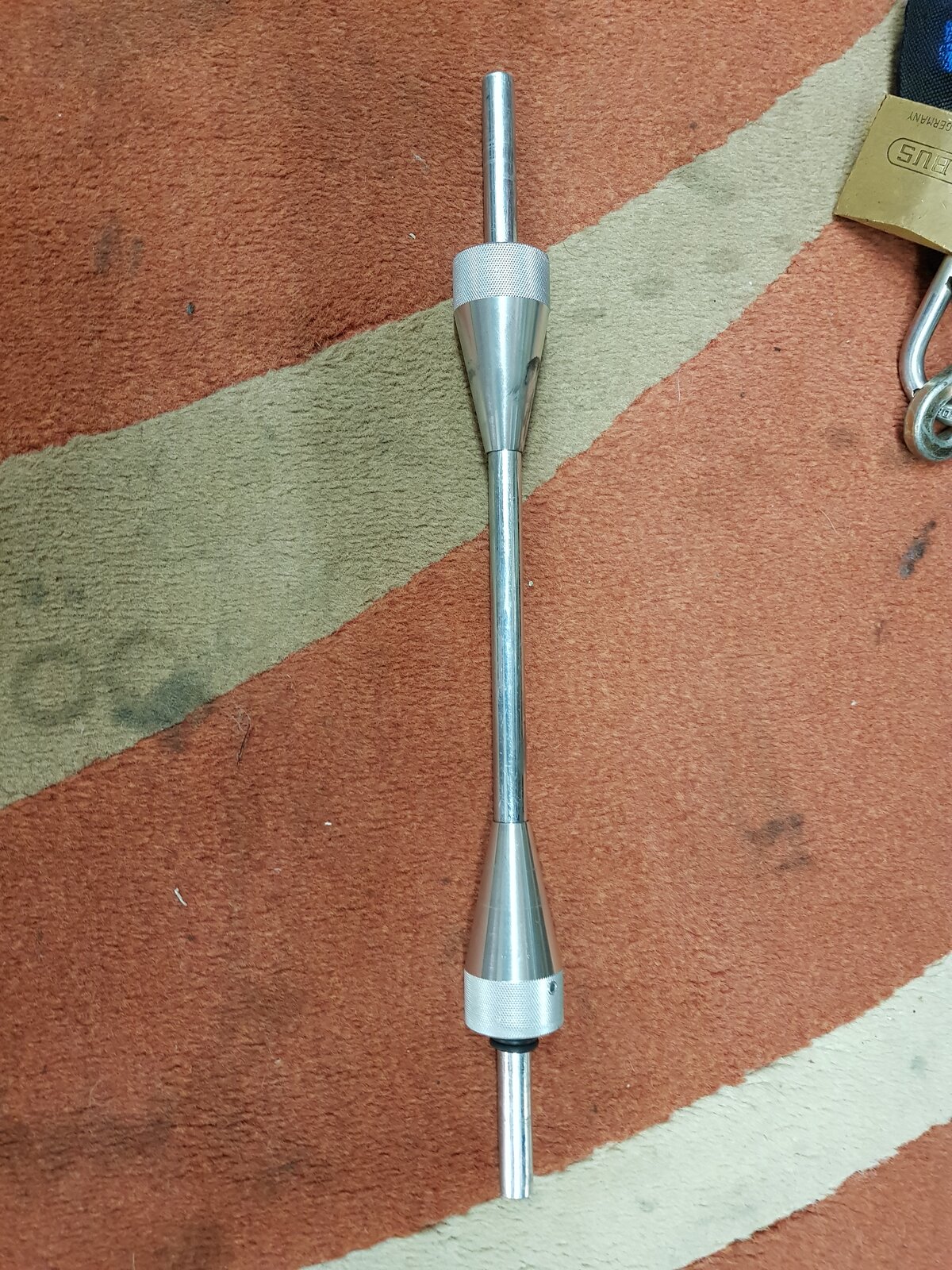

    Oh forgot to put it in...this is the balancing bar which goes through the wheel and rests on the bearings that in turn go on a paddock stand....word of warning the 2 bearing balancing things didnt fit either of my paddock stand but, by lucky hap, ive got an articulated front paddock stand that goes in the yokes...they fitted in the bottom half....
