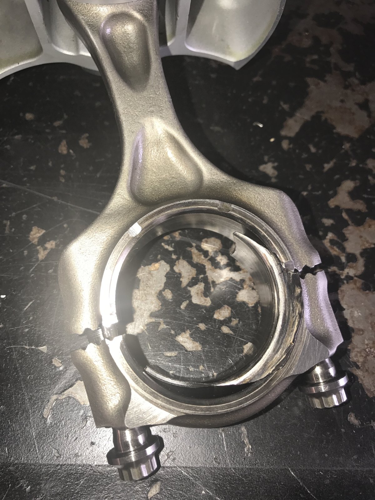

  4. Not under warranty. Loooong story!
    - Started with nobody wanting to pay to strip it to verify the very broken engine. I paid that (~£500) after waiting about 2 months, thinking DUK would see sense.
    - then, after another month or so, Ducati UK agreed to pay parts (~£9k).
    - then a long wait (another month?) whilst everyone refused to pay to rebuild it. Eventually my dealer (Ducati Aylesbury) stepped up and rebuilt it for free. They didn’t have to, but it saved me the thick end of £3k. I am very grateful to them, and they have a customer for life.

    when and how did the engine go wrong?
  6. Riding down the road. 3rd or 4th gear the rear locked up. Just lucky it was a straight bit of road and I wasn’t going silly speeds. Pulled in the clutch and coasted to a stop.

  8. Do you know what caused the engine failure?
    10k WTF...
  9. Not sure why, but stems from the conrod/crank connection. The bearing shell (if that is the right term) disintegrated, and the reason it cost so much is that some of the debris got between the crank and the crank case, scoring a few groves in it... so crank/conrod/crank case/oil pump all starts to add up (I think the crank is about £2k).
