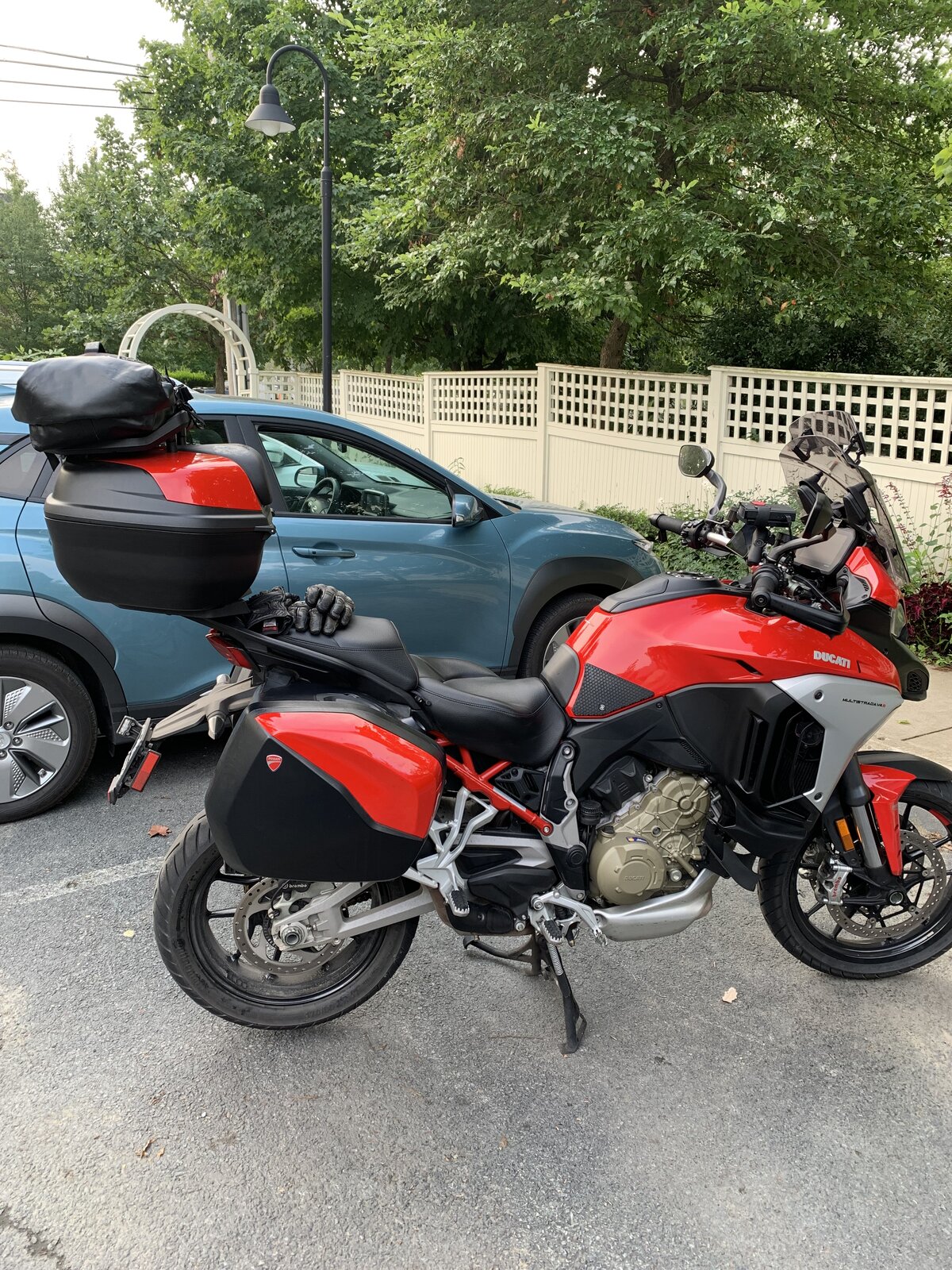

  4. Yes, you can make the older topbox fit. My friend with my old V4S did exactly that. Seems somebody makes an adapter.
    Ducati in their literature claimed to have made the seating area longer for the passenger. The truth is they meant to and never did it. They added a 25 mm spacer to the tail light assembly so they were planning to make the seat frame longer probably by the same 25 mm but when it came right down to it they didn't. The seat frame which they call a hand hold, is identical right down to the casting numbers between the V4S and the Rally. I don't know what happened at their end. I can only guess that somebody came up with an issue and they canned the idea after having already ordered modified tail light assemblies. They did move the mount for the aluminum top box back 6 mm so that is at least something if someone was going to use that mount and box with a passenger. My dealer was advertising the added length as well until I showed him :)
    All of the V4S bikes have had the ability to locate the passenger seat in two positions. This is to go along with the high and low setting of the front seat. When you raise the front seat it mounts further back so they made it so you can move the passenger seat back the same distance.
    The phone pocket not only has a USB plug in it but it is also equipped with a fan in the cover to keep the phone from overheating. V4S owners can also have the fan cover for free with the caveat that the dealer install it which in my case cost more than the cover was worth. The Rally pocket is quite a bit bigger so larger phones that wouldn't fit in the V4S might fit in the Rally.
    The bash plate on the bottom is not only bigger but is made of thick aluminum that might actually prevent some damage wherein the V4S piece is made of thin sheet aluminum more for style. That is if anybody is daring enough to even venture off-road with this $30K behemoth :)
    In the States all the bikes came with the big aluminum boxes mounted to a frame assembly. I took all of it off for now. My wife and I will do another round the country ride this year so these big ones will come in handy. I'm still running the original plastic top box. I mounted a rack to the top of it which worked out well during the last couple of trips with her and all her "stuff".
    Marc
  5. They definitely did something in the rear for the passenger. I couldn't use the steel frame to hold my panniers from standard V4. Had to be Rally specific.
    Power socket, you have the USB in the phone pocket on the left, round socket next to the display on the right, and one more under passenger seat.
  6. If you remove the Rally pannier mounting frame and buy a set of the lower aluminum bag mounts that attach to the passenger pegs part#s 86611951A and 61A, 83019871AA and 81AA the plastic bags mount right up :)
