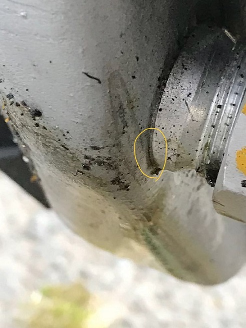

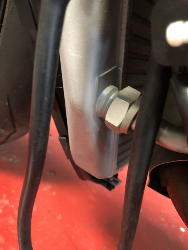

  10. Im wondering how long before the oil cooler recall hits the UK. There have been a couple of well documented cases online of oil cooler failures covering the rear tyre in engine oil, thankfully with no accident or injury as a result. It seems Ducati have responded (at least in the US) as there is a modified oil cooler design where the outlet port on the LH side has been braced for added strength. There is no change to the part number as yet and I am surprised the UK dealers seem unaware of it, since at least in one of the cases it was a UK owner who suffered the failure/s.
    Here is a pic of the offending area where the boss cracks and weeps oil and the second showing the new bolstered design. I think it's clear from these two images that Ducati have responded (see US recall notice https://www.asphaltandrubber.com/recall/ducati-panigale-v4-recall/), so if in the event yours fails you need to ensure they fit the new style part onto your bike under warranty.
    Original design
    Modified design

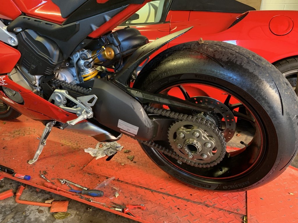

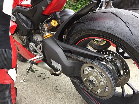

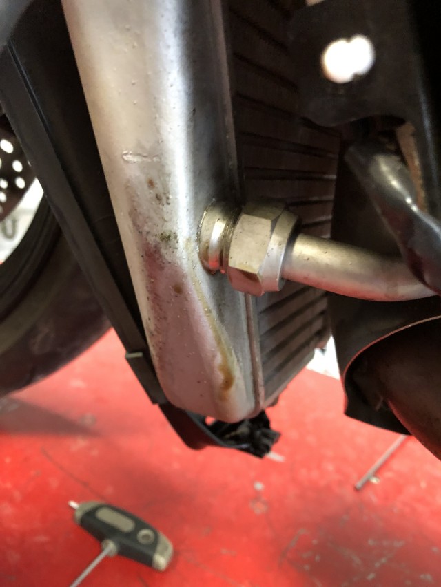

  11. It was me who has had 2x oil cooler's fail (and 2x water pump seals)
    first time at this years TT when I was going over the mountain, lucky it didn't result in something VERY serious. Then had the it fail again a couple of months back. I rejected the v4s as a result as I lost all confidence in the bike after very nearly coming a cropper!
    Each incident was scary to say the least! :(
  12. leak at the TT
  13. the failure point
  14. 2nd oil cooler fail!
