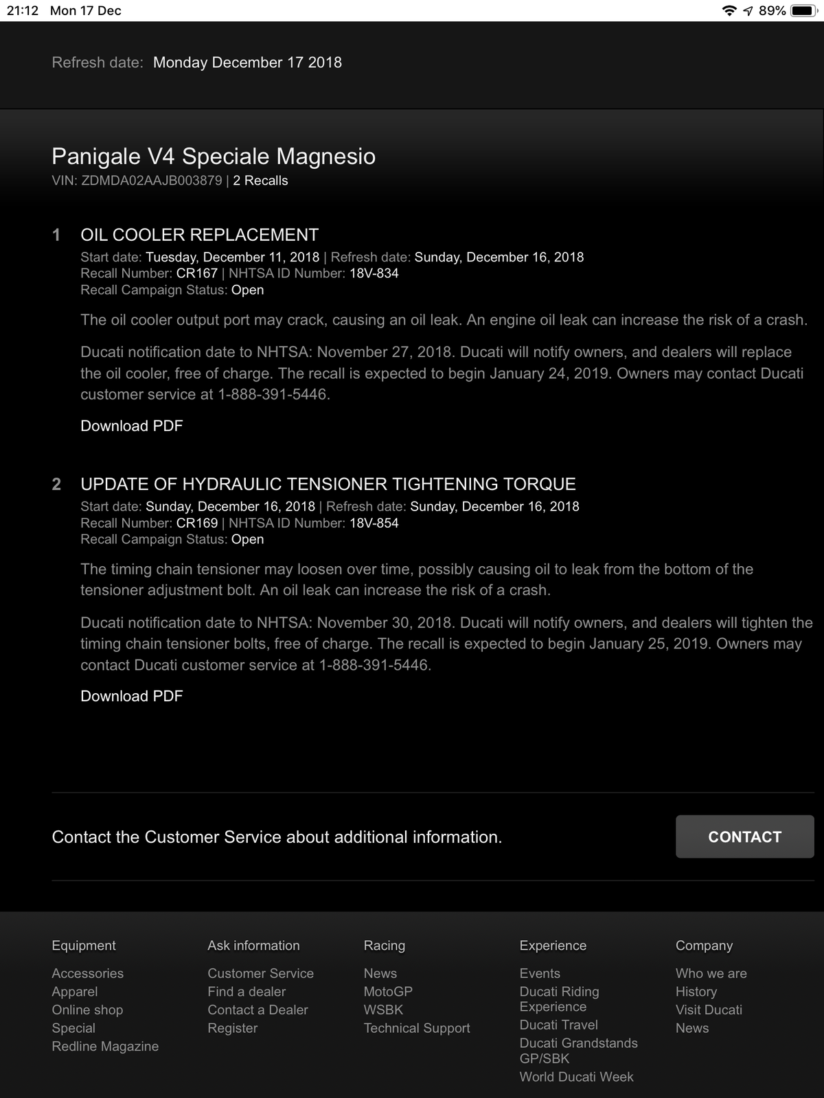

  1. 32F50D9A-4F3B-436A-8502-B6B83D4F6EBA.png Hi All
    Sure this is all old news now but just put my VIN number into Ducati and this popped up, so just thought I’d share ☺️

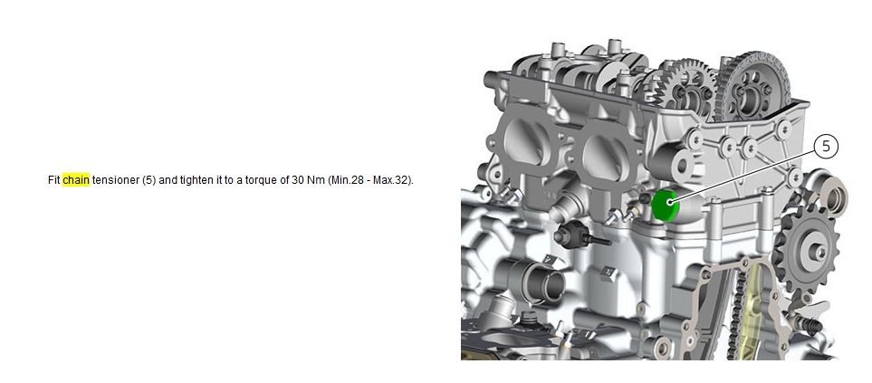

  10. In all honesty, I think Ducati have reacted fairly quickly to all known cases of failures or symptoms that have thus far come to light. I am not sure if the front sprocket oil seal was amongst them but many of these issues are resolved on the production line as the factory becomes aware of them, so chances are anything coming out the front gates now, will have already had these shortcomings fixed. The oil cooler recall is doubtless going to cost them a lot of money as there are well over 1600 bikes affected in the US/Canada alone, not to mention the lost revenue in labour time. As far as I can see, the chain tensioner bolts are relatively easy to access, so if all they are required to do is check torque them, it should be a fairly quick job (the time is takes to remove the side fairings, check the bolts and refit the the bodywork). One bolt is behind the ABS unit on the front cylinder head, the other is next to the thermostat housing on the rear cylinder head. Here's an image of the rear tensioner bolt.

  12. If you are talking about the tensioning bolts, I'm not sure R&D would predict a component potentially working loose, if indeed that is the problem with this bolt. Most likely is that there has been an issue at the assembly stage (as opposed to an inherent design flaw) where an incorrect torque value has been used, so this smacks of a preventative "belt and braces" approach, so any that slipped through the net can be checked, as I am certain they will have corrected/checked this on the assembly line now. As far as the oil cooler is concerned, it's rubber mounted but any flex puts a degree of strain on the unions/bosses where the delivery and return pipes attach. The bosses are angled on the oil cooler itself but clearly given enough movement of the oil cooler under normal use, these can crack. The new design has a plate around the base of each boss, to strengthen it and cope with any stress placed on it.

  17. Had formal notification of CR167/169 Safety Recall Campaign for the oil cooler swap and cam chain tensioner torque in the post today. Andy
