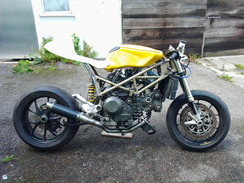

  1. Well its coming home tomorrow, mark sent me these pictures earlier.
    • Like Like x 8
  2. Tell him to park it next to a high kerb...:eek:
    Looks chuffin' good though:upyeah:
  3. do they make alpinestars with a platform sole?....looking good,nice zorst.
  4. Cheers guys, it does look high but just compare the seat height to the 748 in the background, the actual seat height is near as damn it the same as the stock height. It looks higher because the seat unit is much more slender and there are no exhausts underneath it :upyeah:
  5. I ride in heels ;)

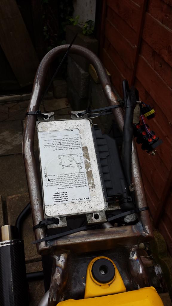

    I have also settled on a position for the ECU
    It sits really nicely in the new rear subframe Mark has made for me, I will have some tangs welded onto the frame when its all stripped down for de-lugging and smoothing before its powdercoated. Once I had the ECU location sorted I started to run the loom back out to see how much modification it needs.
