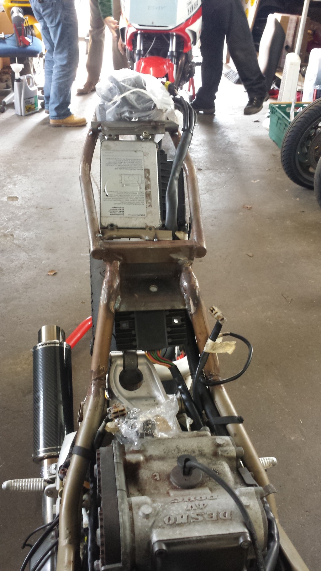

  3. Not really an update, mark has just collected the bike to fabricate some mounts for the battery, ecu and clocks etc.
    It's starting to come together now, I think I'm on track to have it finished for the summer.

  10. Bit of an update, we've started to strip down the loom. I've cut a load out of it that wasn't necessary and we will be shortening it as its waaaaay to long.
    This is the part I have been dreading, electrics are witchcraft!
    The layout of a few bits has been tweaked too.

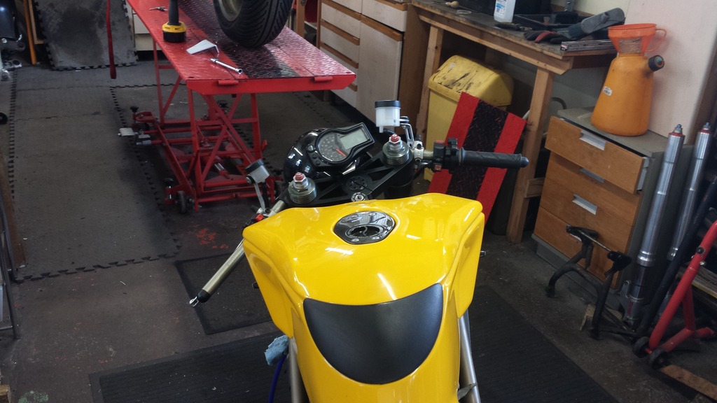

  11. Just a quick update, we have fitted the dash in its final position.
    Progress is a lot slower than I initially wanted as I'm struggling to find time to work on it, I'm still hopeful that I will be riding it this year. Its not going to be cosmetically finished but should be mechanically about there.

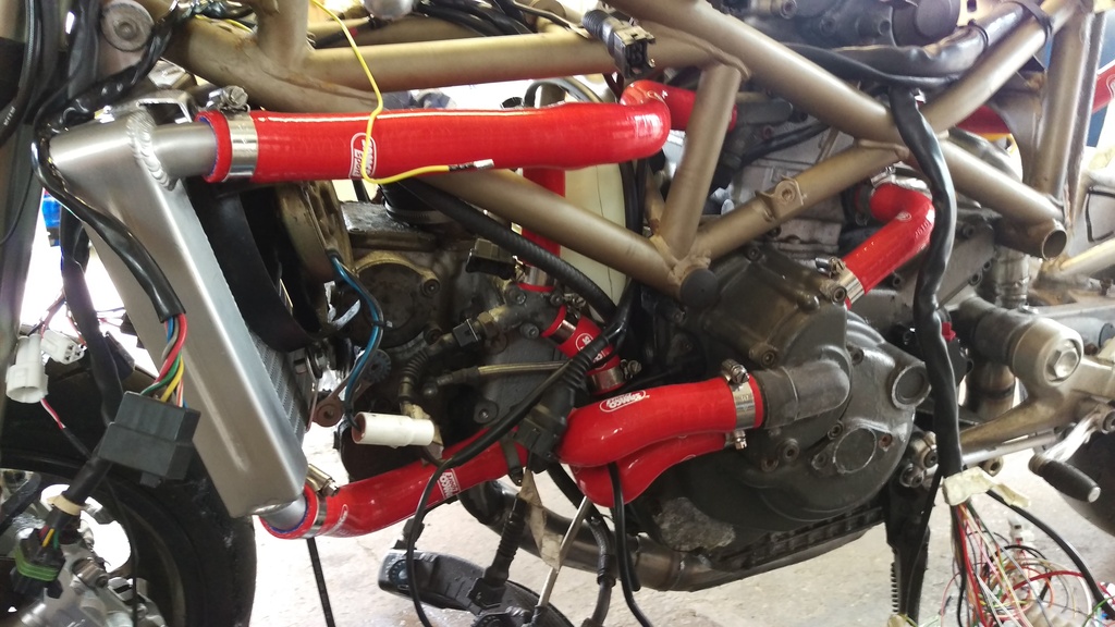

  15. A few more bits and pieces done on the project bike, new clutch pressure plate and samco hoses fitted and the water temp sensor has been removed for modification. The wiring loom is stripped down and ready to trim to length too. It needs a service and new belts then it's ready to test fire, next weekend the Beastie should roar...
