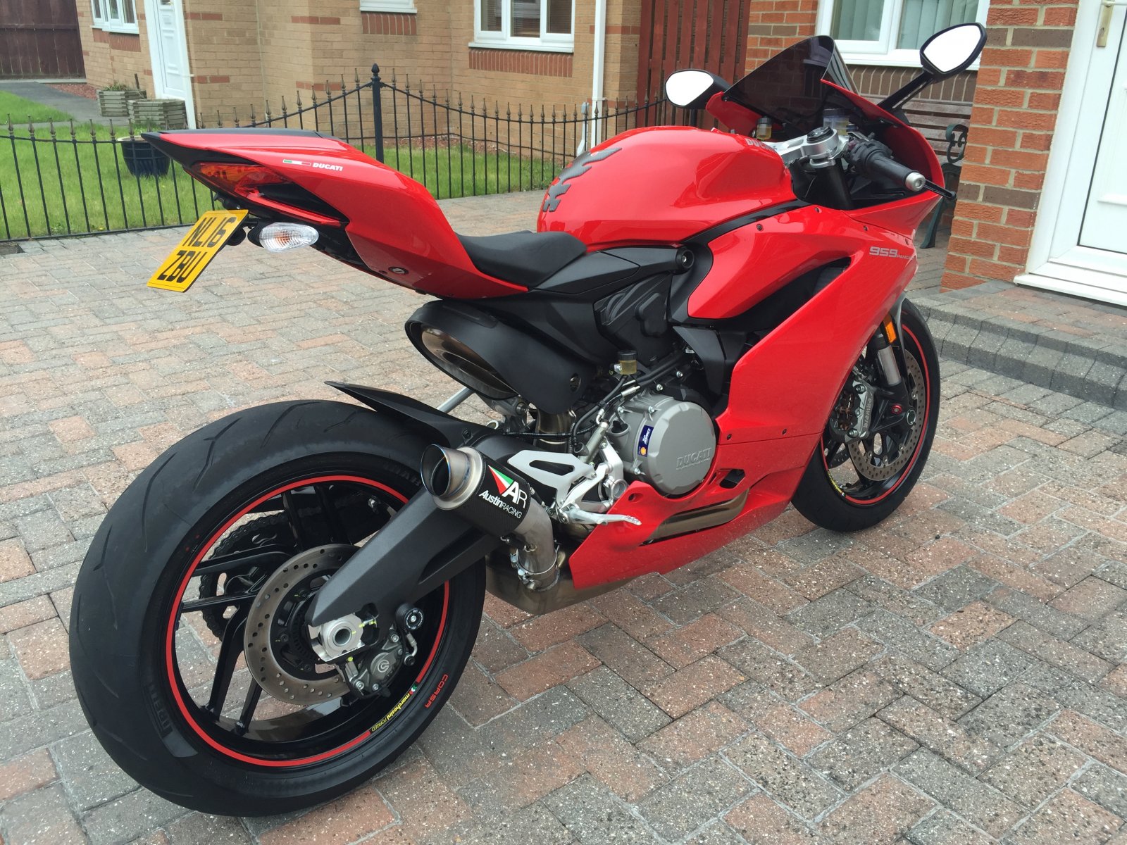

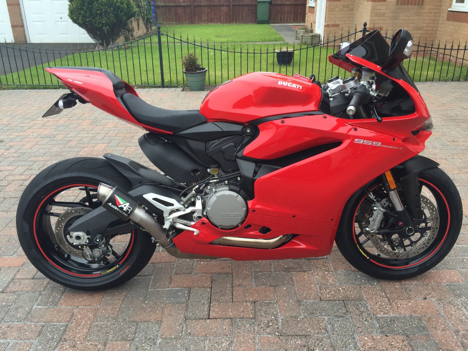

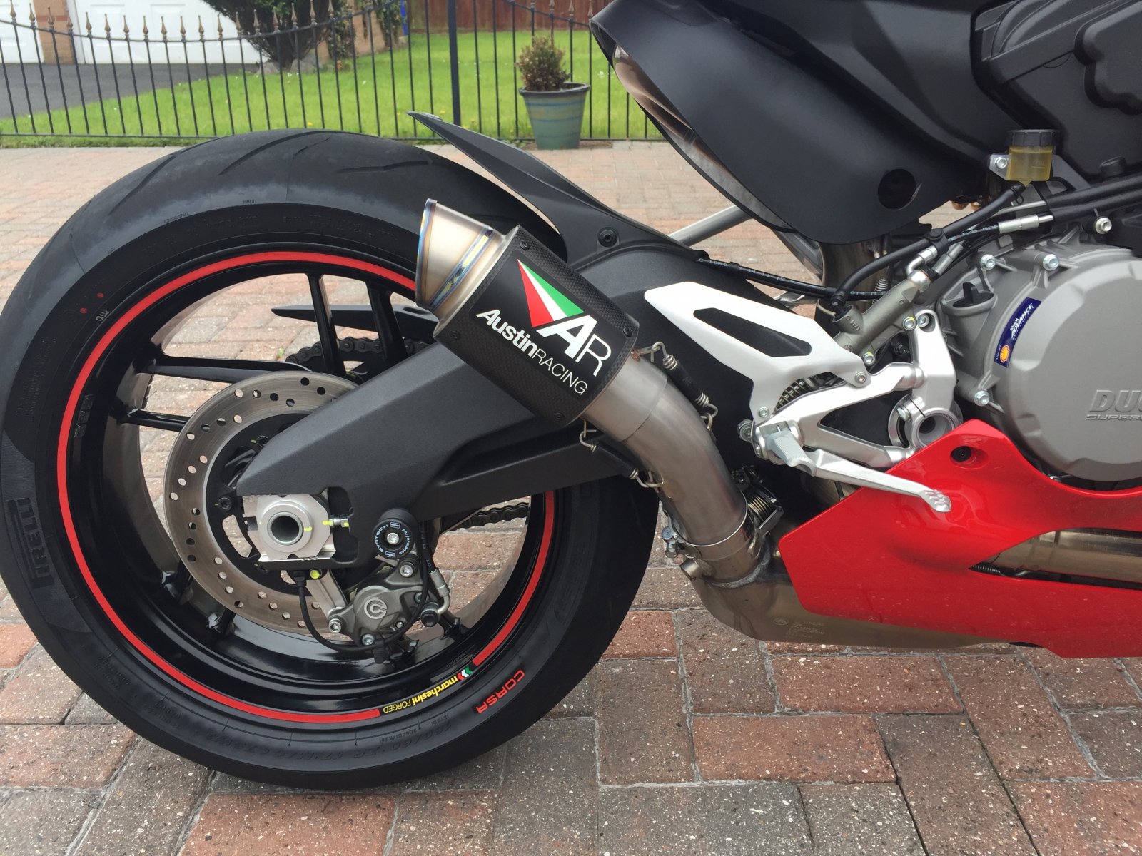

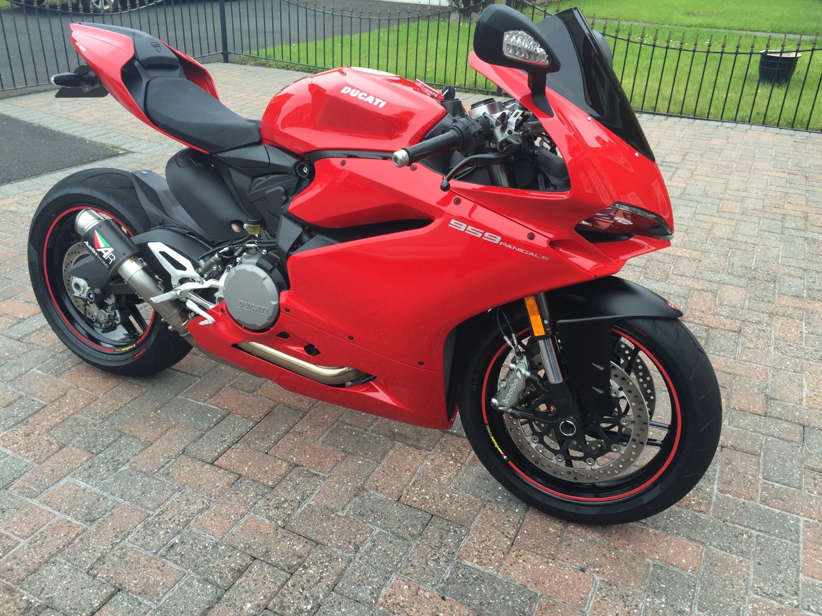

  1. The full retail price is £720 + delivery so that is a decent price on eBay
  2. Import duty was only $90, not like it matters now as this system has sold.
  3. I would be the purchaser of said eBay item. I will let you know how I get on, but it looks as if I will only have to change the under belly section and not the whole system (it has the same fixing as our 959 going up to the headers, which is different to the 899/1199/1299 systems). The added advantage of that is that our flapper valve is not above that join like on the US version, so it will be flapper valve-less if it works. I was thinking about cutting my existing fairings, but have picked up a set of lowers from my dealer because all the second hand ones were scratched/damaged or nearly as much as a new set. I may mark mine up and cut them when I do the switchover to sell on.
  4. Good stuff, just be aware that removal of the flapper valve on the 959 will give you a warning light on the dash.
  5. Yes, but I have a fix for that ;) I just hope that is the only problem I have!

  9. I am sure £2700 is what everyone is doing the slipons for, so I am not sure it is much of a deal. However, I would push for less because the panels are £400 and I am sure I have seen the Akra slipons with up map for £2200. The up map is because there will be a lot more resistance in the cat and end pipes of the Euro 4 compared to the race use only Akra replacement.
    Flapper valve is just noise on tickover from what I can work out. Arguably slightly more flow, but negligible. I would not have bothered, but it will be an added bonus if the swap works out.

  11. £2700 included the fairing panels so you are basically getting them for free... still expensive!
