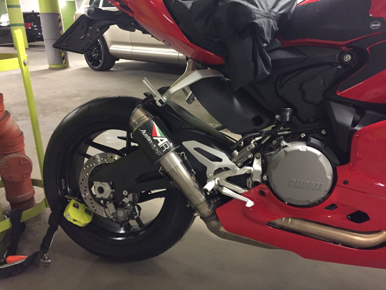

959 Austin Racing Exhaust Fitted
Discussion in 'Panigale' started by iang27, May 7, 2016.

  5. I just installed the same exhaust yesterday :)
  6. My first comments were that it was at the wrong angle totally, but having seen a few fitted I think it looks okay.
    I have seen Akrapovic Shotguns advertised for £1000 so these are still about £250 cheaper? and I imagine a bit lighter.

  12. Hi,
    I disable the exhaust valve cable to check if it sound louder but the engine management light came on so I re connected it but the light is still flashing.
    Does anyone know how I can get the light to go out or do I have to contact the dealer?
  13. We also disconnected the valve and the light came on.
    Once you refit the cable and ride the bike the light goes out.
    On the AR website they only show the new cans but my brother wanted the angled exit so they made INE up for him and have now added it to the range.
    Much cheaper paying 'cash'
  14. I refit the cable and ride the bike for about 10min and the flash is still there.
    Do I have to ride it longer for the light to goes out?
  15. His light went out before he got to the end of the street.
    You have put it back into the correct hole I presume ?
    It goes into the first hole where it is easy to get in. It also fits in the second hole but the cable is very tight and this leaves the light on.
  16. Okey thanks, I will try to refit the cable today. My light is the engine, not that with a warning triangle.
  17. I think I solved the problem :)
  18. What was wrong, cable ??

  20. I run the bike for about 20min then i turn the ignition off and on. Engine flash where not there anymore :)
