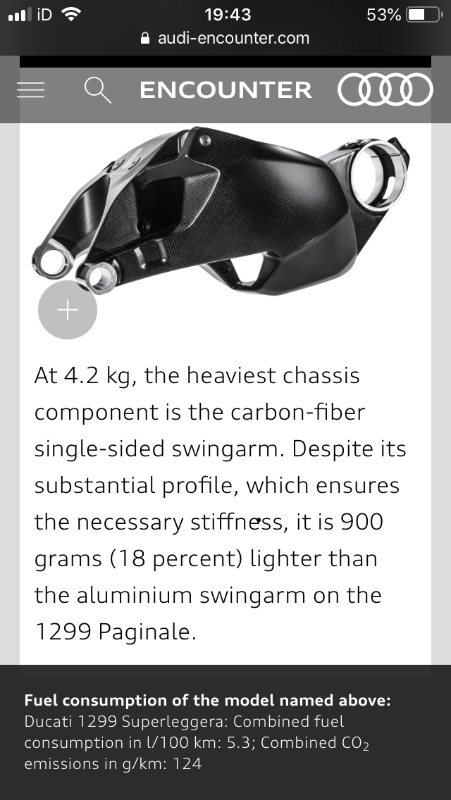

  6. 2BA8D0C8-2640-4877-9159-BCFEE02903F1.jpeg As a comparison:
    From the 1299 Superleggera

  10. Beautiful piece of engineering!
    This got me thinking.
    So does this all count as unsprung weight or not?
    Given the massive weight reduction for this - plus the already super light wheels - what tweaks to the rear shock setup will be needed?
    Is there a point where you lighten a bike so much you have to drop the spring rate to suit?
  11. Yes and yes - but he's quite a fatty :worried: not much boinging going on here :bucktooth:
  12. Yet not as fat as you. :bucktooth:
  13. The bike is rock hard anyway, being set up for the track by the previous owner.
    TBH, I just jump on it and ride the thing. I'm not a mentalist on the road and just fancied one of these swing arms because I'm shallow like that. :laughing:
  14. :eek:
  15. So aside from everyone being fat (there’s and theme here :D) if one was to wish to take this to the track.....
    A reduction in rider weight means a reduction in spring rate.
    Rider weight is sprung weight - and usually the likes of Ohlins give a recommended spring rate based on the stock weight of the bike plus the weight of the rider.
    So in my logic if you reduce the sprung weight of the bike then it’s going to require a reduction in spring rate as if rider weight had been reduced.
    For unsprung weight, the logic isn’t so clear for me - the spring isn’t supporting that weight - so would a massive reduction in it require any reduction in spring rate?
    I can see it requiring adjustment to rebound and compression- but i’m less clear on the spring.
