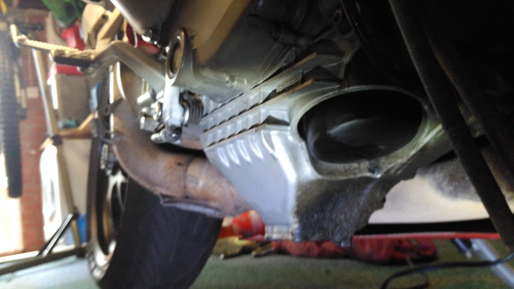

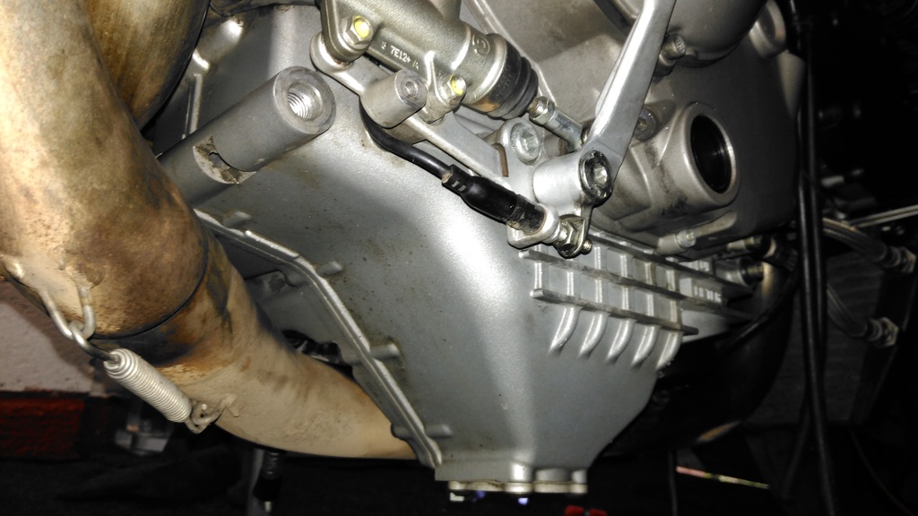

    ve not got started on the cleaning, pics and random rubbish yet. Although I have just polished the RHS fairing to see how it looks and it looks good. Does have a small scratch I'd not noticed before, but its not a new bike of course.
    The underneath of engine etc needs a good clean but I've got an hour of cycling to do before we get around to that stage of things.

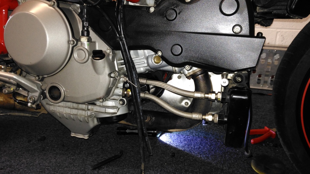

  7. Cleaning has begun as it's a quiet day and no plans for anything else. It's far from terrible, pretty decent really.
  8. [​IMG]

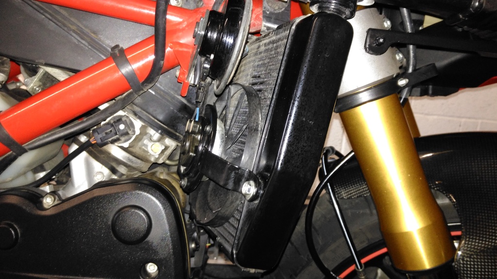

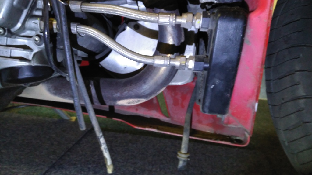

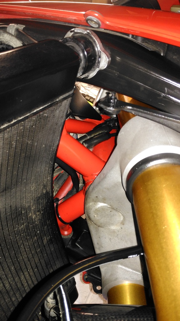

    Need to crack on this afternoon with getting the radiator and oil cooler a bit prettier...

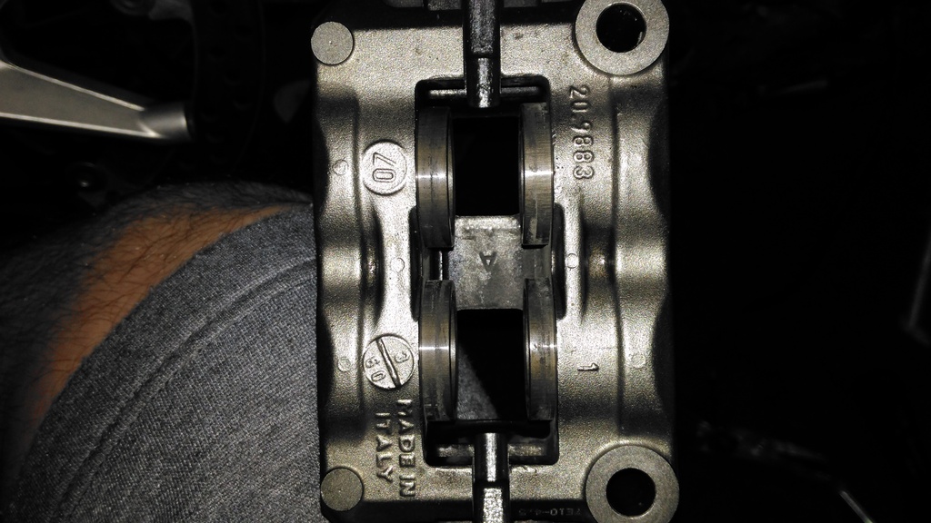

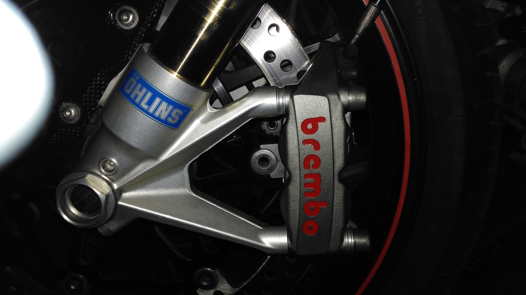

  9. Mrs Weeksy decided to cook a roast, which gave me another hour of spanner time.
    Stripped calipers out to check pads, pistons, movement and give them a clean.
    Under some circumstances I'd completely stop them, but these were pretty good, pistons nice, so they were just pushed out, cleaned, turned and given red rubber grease. Everything all cleaned, grease on bolts and stuck back together

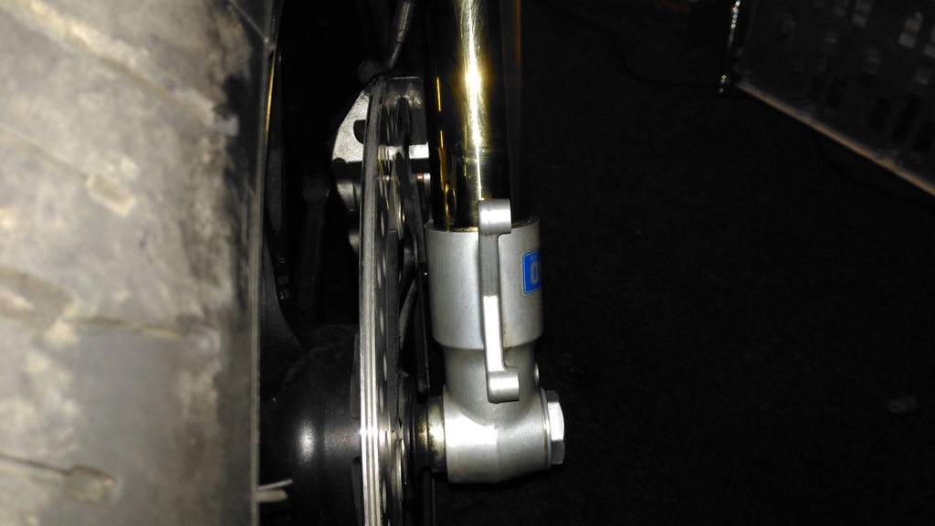

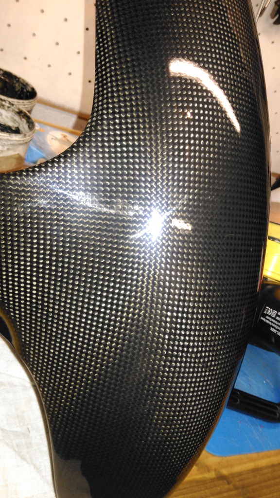

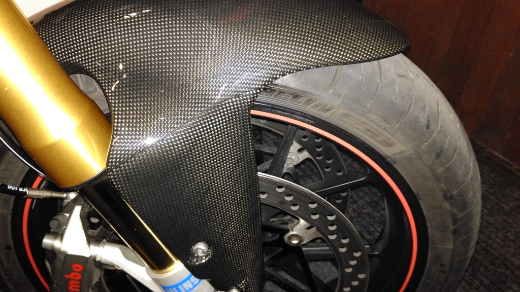

  10. Strictly come dancing, so that means garage time.
    Removed front mudguard and polished, obviously cleaning fork legs too. Not done brake discs yet though as still no paddock stand

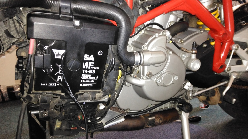

  11. I'm sure you've all seen and heard tales of woe with 1098s.. but here's another
    I'm now sitting wondering where to begin. There are reports of an ECU flash from CJS, there's exact start cables from Exige on here, there's valves/throttle bodies/TPS....
    But as you guys see these things a lot i thought i'd ask on here.
    Battery will attempt to run the bike 10 times before it starts really struggling.
    Attempt 1 in the video was with no throttle at all.
    Attempt 2 was with a tiny bit (after reading wisdom on the WWW)
    Thoughts appreciated.
  12. Your not supposed to keep the button pressed or use any throttle.
    I'd start with new spark plugs correctly gapped and clean all terminals battery, starter motor, etc, then new battery and @Exige cables, then off to CJS or similar.
    I think you can reset TPS yourself with a couple of cables and a tablet.

  13. I know you're not supposed to... but many seem to have to.
    We'll see what happens next.... thanks for the info.

  19. Start (no pun) with new plugs
  20. My new to me 1098 struggled to start with the exact symptoms of yours. I fitted a new battery and now all is well. No throttle just press the starter and release and after a couple of cranks the bike fires and runs perfectly.
