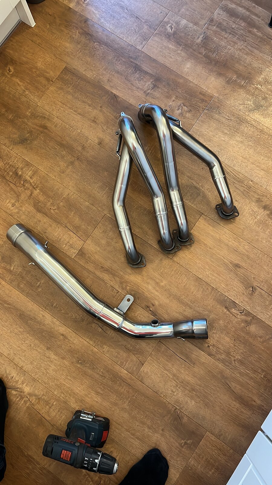

  2. I’ve a set of downpipes that need a spruce up, could you do them say any week in February?
  3. For the right price, anything is possible
  4. Four bags of Wotsits?
    • Dislike Dislike x 1
  5. Ok. I cracked. Just for you Adam @Advikaz

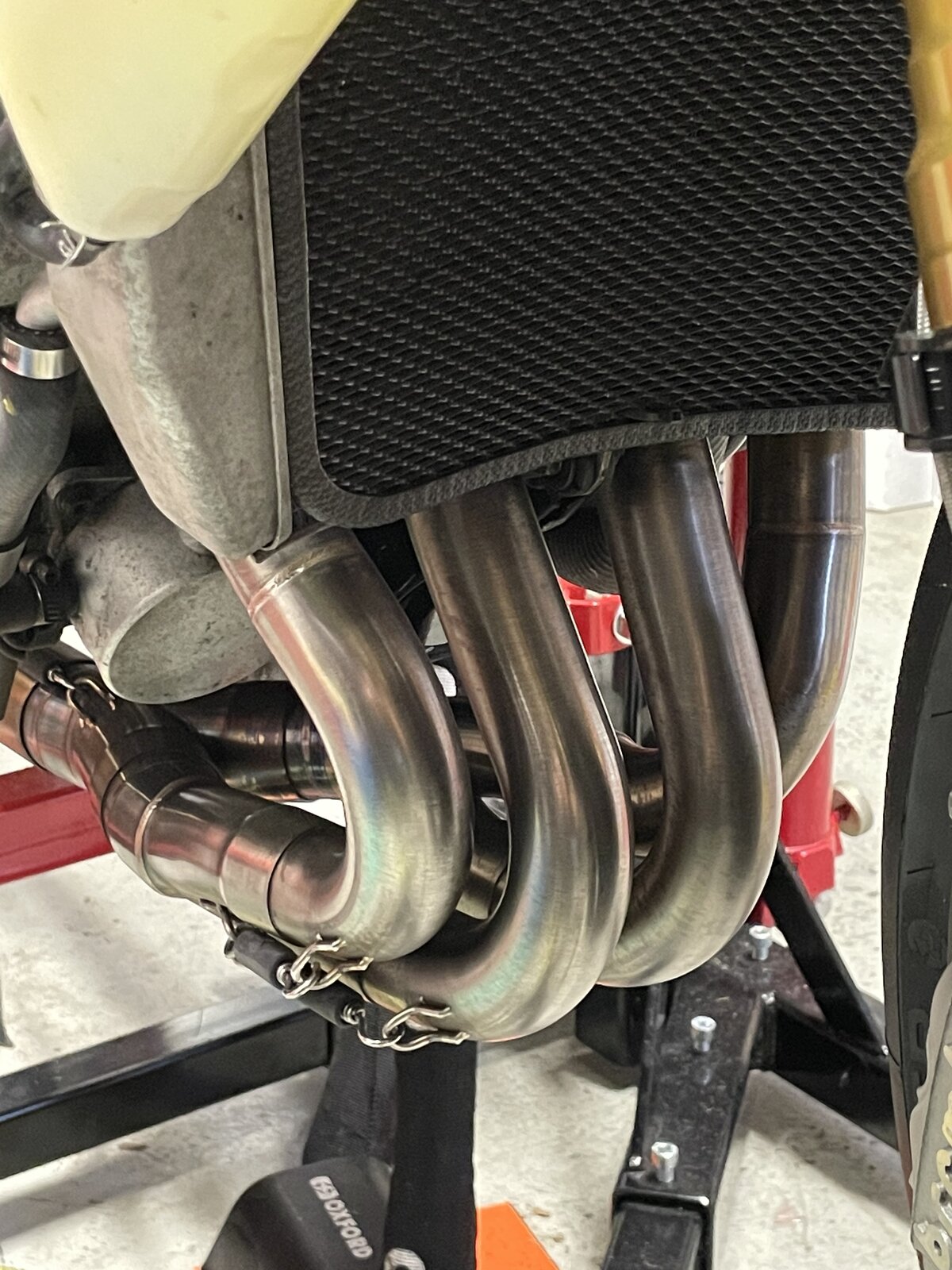

    15 minutes with a rag and solvol and that’s as good as it’s going to get. I couldn’t even be arsed to take the springs off. But I just don’t care ;)
  6. That’ll do donkey !

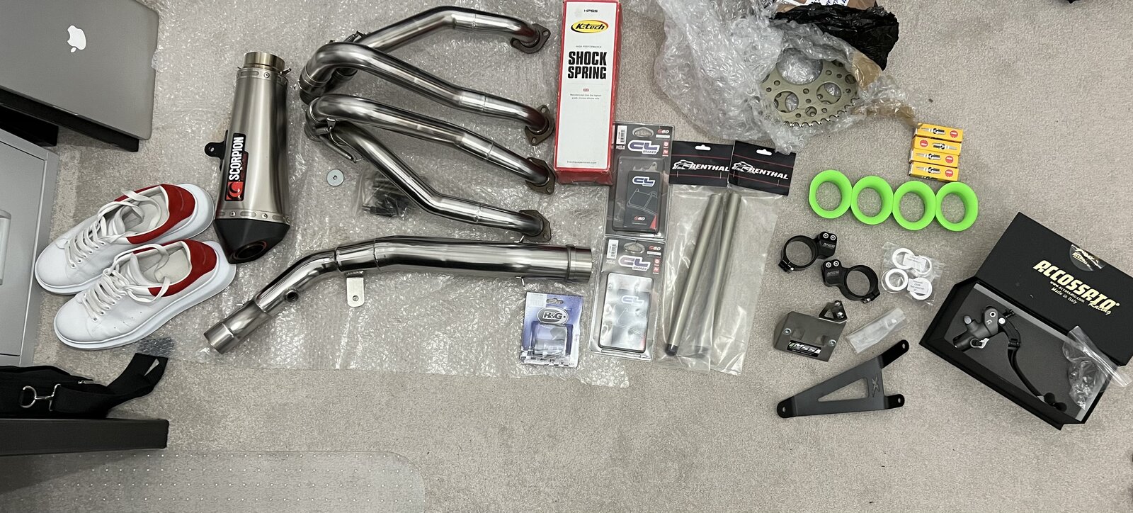

  7. Some bits ready to go on the new girl once I muster up the courage

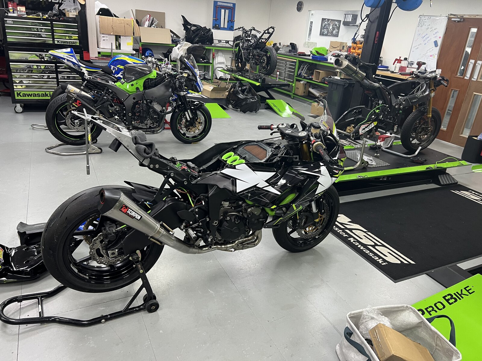

  8. Rather financially damaging day over at MSS today sorting out some issues, fitting new bits and mapping her up.

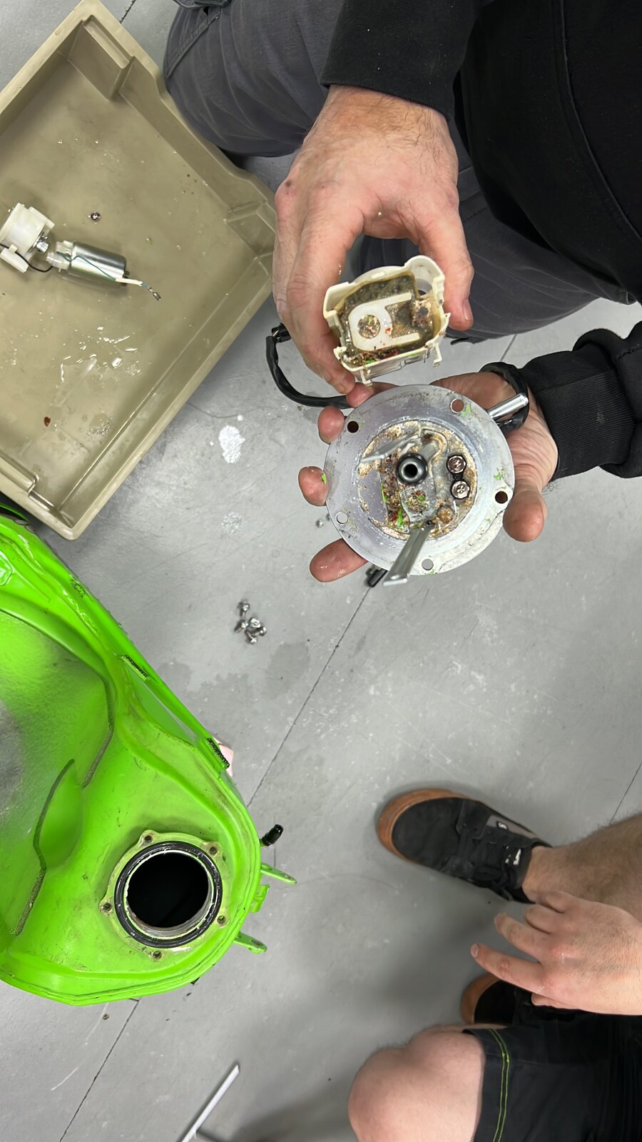

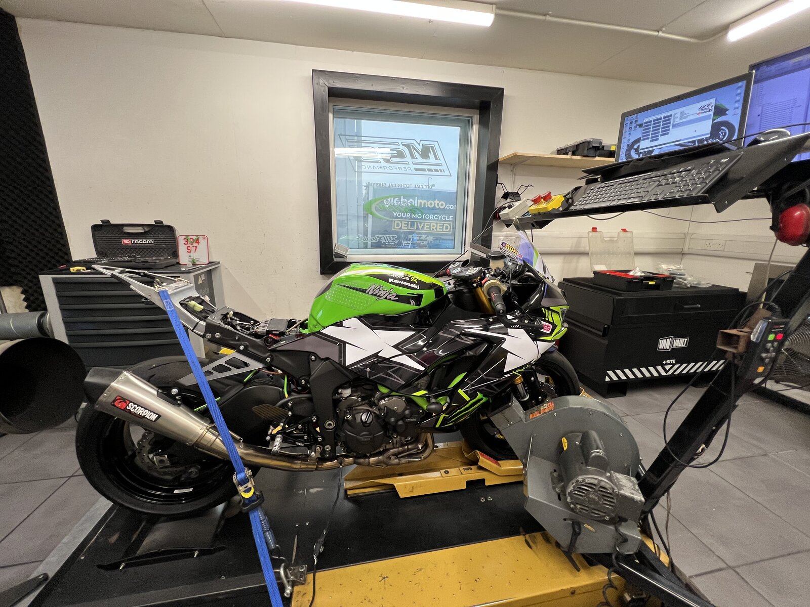

    fitted the rest of the bits to the bike, got her up on the dyno and she made a whopping 90bhp! Errr somethings wrong here chaps..
    Luckily, it was plain to see, even to my eyes that the bike was massively leaning itself like it was hitting a brick wall at 11k.
    The lads at MSS identified the issue within minutes,
    take a look at the state of this fuel pump!
    cleaned out the tank and the pump ran her up again, tweaked the AF and ignition and she made a healthy 120.45bhp.. I’d been warned before hand that the MSS dyno is conservative but, I must say I was expecting a little more.
    The guys said the worst air pressure they’d ever seen was 994 and mine was 997 so pretty bad, also humidity was high so not ideal conditions for dyno work and suggested on a better day it would be around 125/127. Pretty happy with that.
