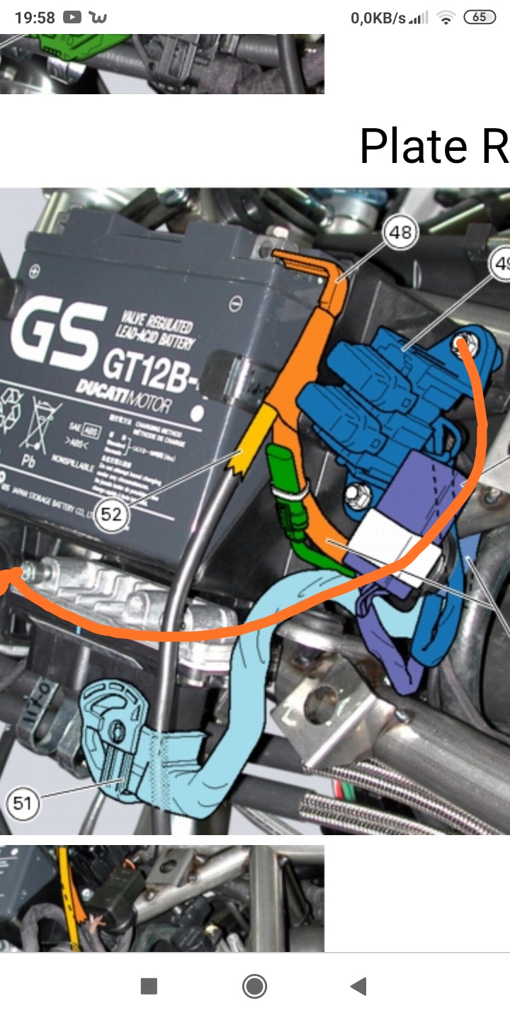

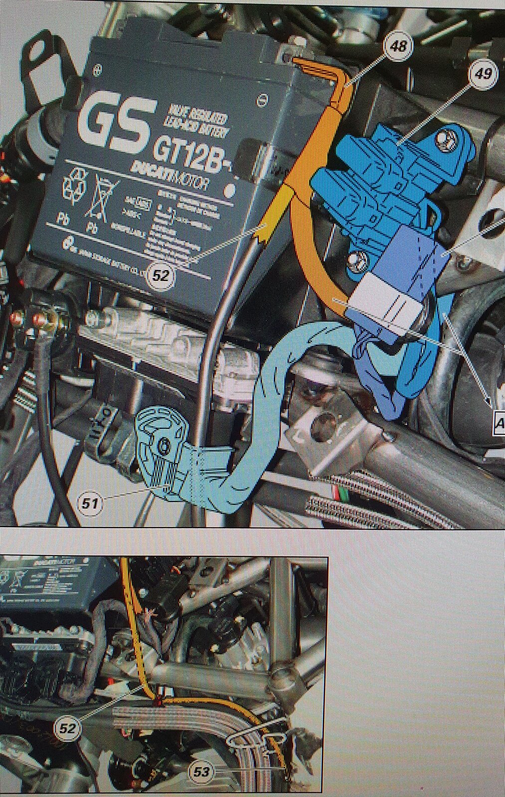

    This is the cable (52) that I need to improve?
    Thanks
  6. Yes 52 is the ground cable.Clear on the point 53 (screw on engine case).In your first picture down from 2 fuses( number 49) is the injection relay.Check with multimeter or test lamp if it closed when starter motor turned.

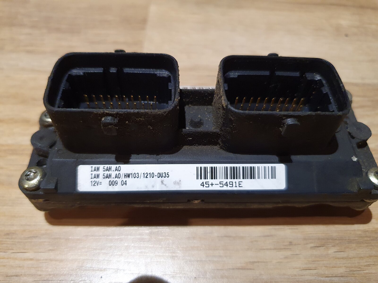

    The ECU that I have mounted is one that came with the Termignoni exhaust kit, because the original ECU was damaged by the previous owner by changing the polarity of the battery.
    This is the original ECU.
    When this ECU is put on the bike, it gives an engine error and does not allow to start it, the error that appears on the instrument panel is Er 19.2

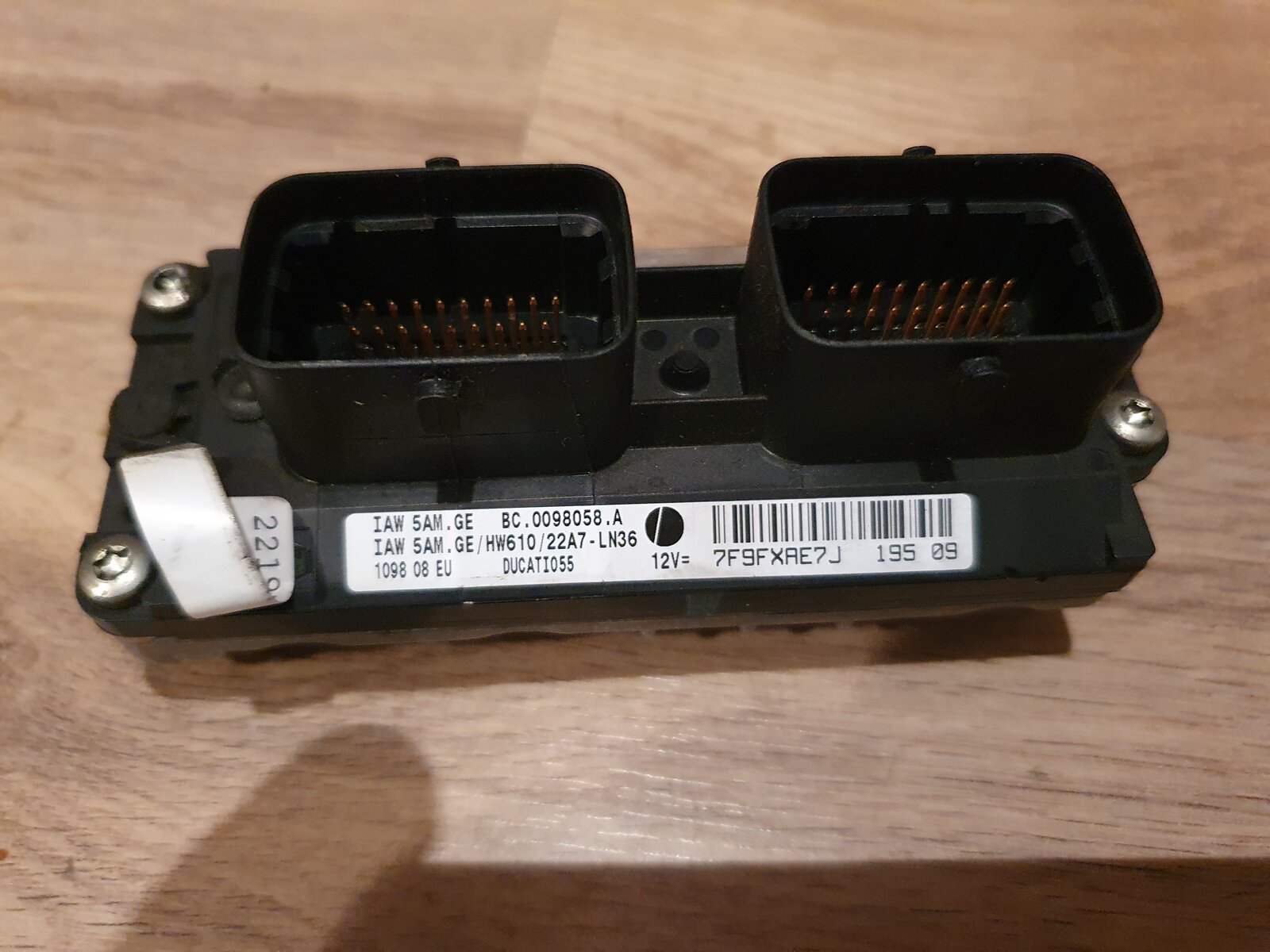

    This is the Termignoni exhaust kit ECU.
    With this ECU no error appears on the instrument panel or on the JpDiag.
  11. The newest multis 2005 have an extra small ground cable to ecu,as a picture.Do you have?On body ECU connector must you have 12vols at pins 4,17 (key on) and 27 (kill switch on).Read this post is the same as you but unfortunately without solve..https://jpdiag.xooit.eu/t4701-Ducati-Multistrada-1000DS-cranks-over-but-won-t-fire-up.htm. Maybe your starter motor draws the current from the ECU.You can try using extra battery only on starter motor.I Think your ECU is good.Your ecu looks reflash ,your map 965118203.BA i think isn't dp map, but that's not a problem.It is ok for termi IMG_20210427_145136.jpg s .

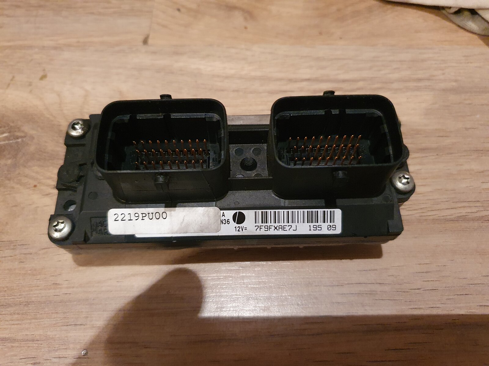

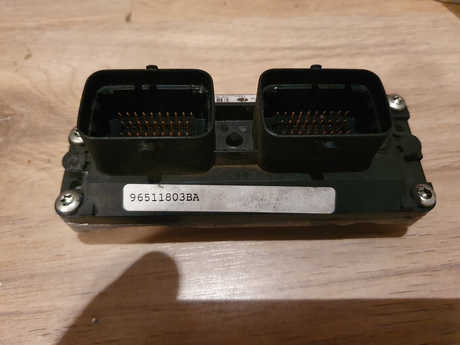

    These are the photos of my Termignoni ECU.

  16. Hi "Kraken
    In picture which you had uploaded your termi ECU serial 7f8....7j has a 965118203BA map but in the sticker writes 96511803BA.I think the dp map for full termi is the 96511803B.In my multi ( full termis) I tried some maps OEM ,803B,..etc... In the last 3 years I have the same map with you ( ....203BA).I believe is better than 803B.None of these are the actual problem.Your bike doesn't have strong spark and pulse on injectors in the start phase.Also the injector test doesn't work .There is something wrong with ECU grounded or current ECU supply.Can you try with your first OEM ECU if the injector test works.I had the same problem two times.In the first time after a week ...I found when I pushed the kill switch the bike started and the second time I cleared the ground cables.Another time the bike had started when I ground the neutral switch cable
  17. The OEM ECU is bad and does not do the injector or coil test.
    Regarding the ECU Termi, I think they replaced the 203B map with 803BA and that is why it has the label stuck on top of the original sticker.
