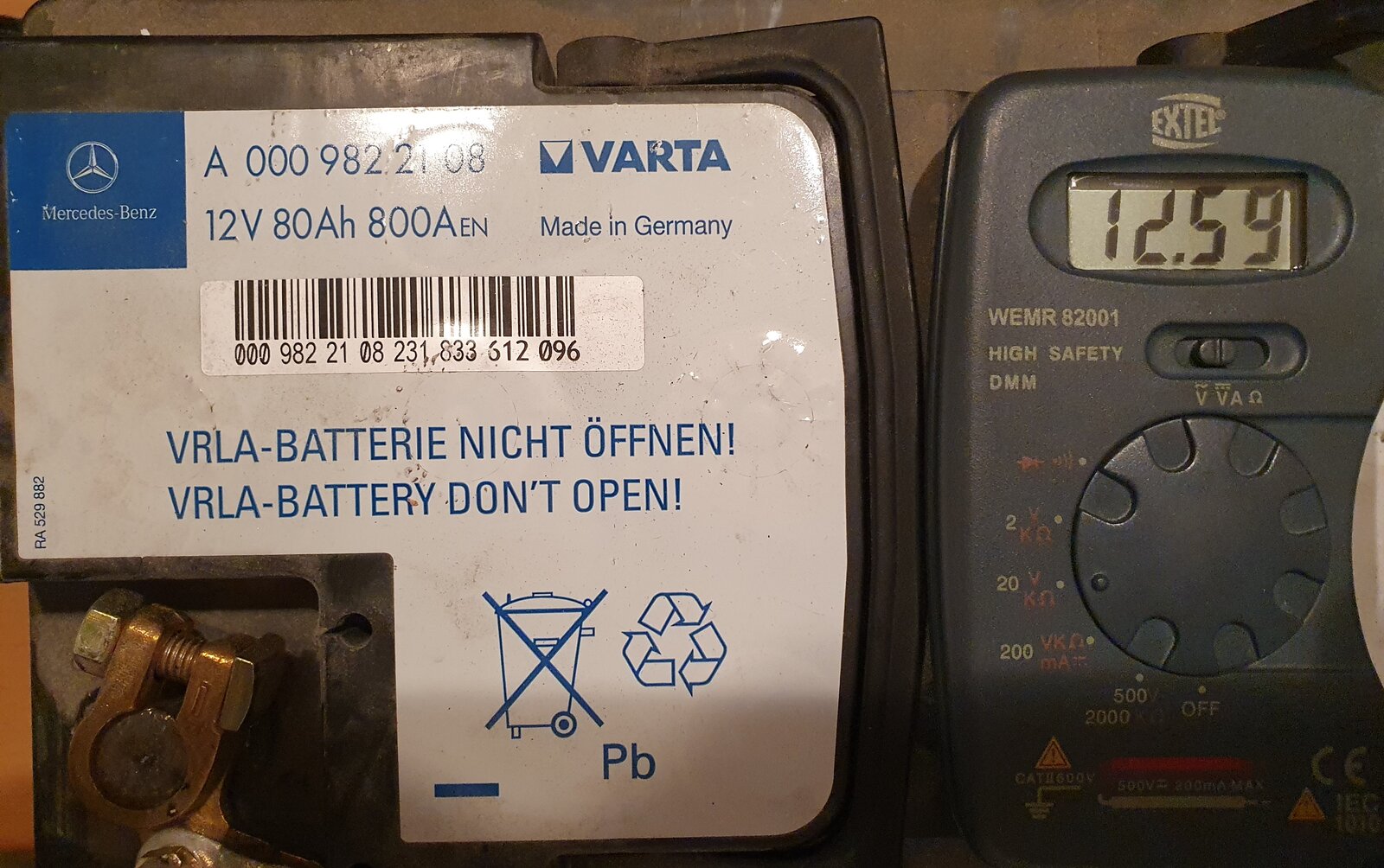

  3. The battery I use is usually connected to a battery maintainer and has a voltage of 12.6V.
    When I connect it to the bike, a voltage of 11.9v usually appears on the JpDiag.
    I use this battery to start my wife's 3.0 diesel V6, and she starts it perfectly several times in a row, so I don't think there is a lack of power.
    And the starter motor turns with speed, not poorly.
    I don't think a new motorcycle battery will move the starter better than this one.

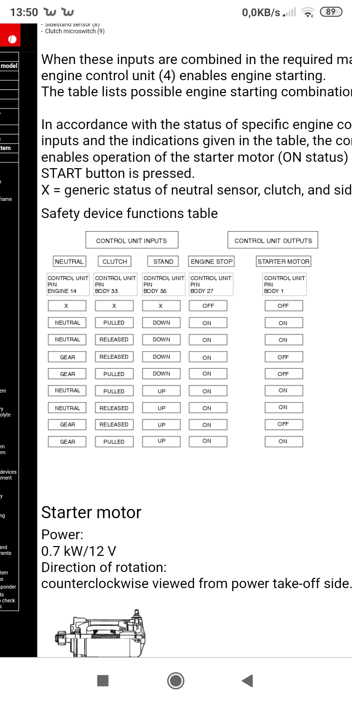

  6. I wrote for neutral switch because it was happen .For this reason I wrote to grounded his cable on engine case.At the start ,the ECU see neutral but when the starter motor turned ,a faulty neutral switch change parasitic the status in the ECU.

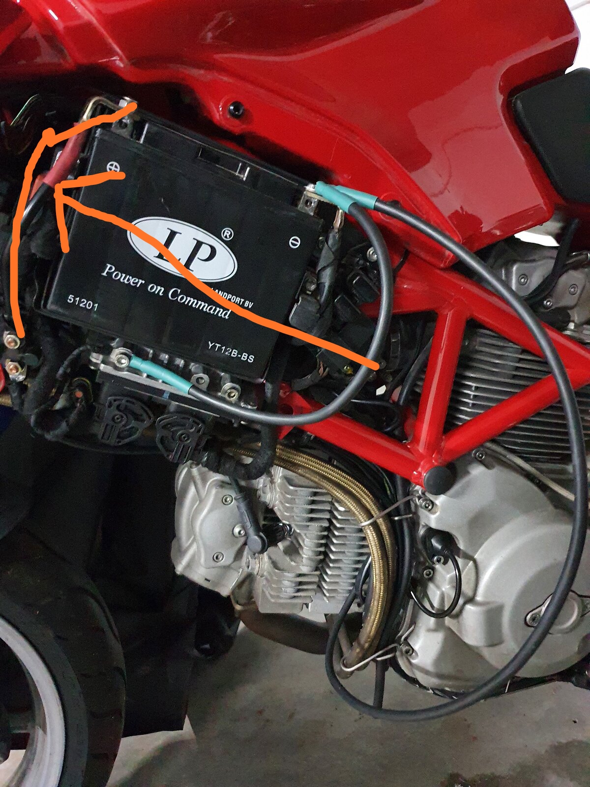

    Is the ECU damage? If you put off the 20A Fuse 49 ,which errors the ECU show at the software?If she shows coil, injectors,relay errors I think the injectors ecus drivers working and the ECU is ok..You can disconnect also the injection relay or once injector to see the errors.If the ECU is ok why she doesn't working? The current supply at the ecu is faulty or the cable lines between injector and ECU are wrong..The ground cable which you put is very huge.You can transfer it as a picture.Between + battery and starter relay.It was happend in another multi .This cable was faulty and the ECU current dropped in a another multi

  7. If the neutral switch did what you say, the ECU would stop the starter motor, right?
    I have noticed that sometimes the green light on the instrument panel goes out, and the starter motor works, but if I engage a gear it stops immediately, so I think the sensor works.
    I will change the cable to the battery positive, but the starter motor turns very well.

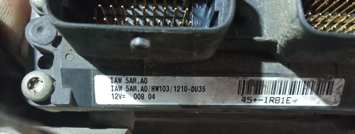

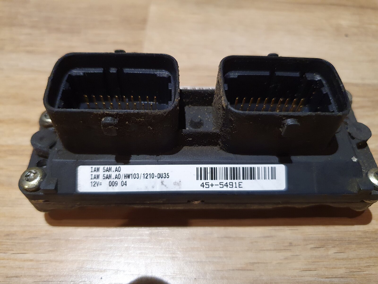

  16. As we continue, I have bought an ECU compatible with the original mine.
    This is the Original
    This is the one I bought.
    Now I have to find how to remove the immobilizer, because logically it does not work.

  17. ohh friend ,your 2nd ecu (iaw5am 610,map....203) is compatible for your bike...Anyway try with new ecu .
    free software is here https://www.von-der-salierburg.de/download/GuzziDiag/
    download the IAW5xReader V0.28 (5AM, 59M) copy and save the map of your new ecu.The process lasts about 20 minutes
    download the IAW5xWriter V0.24 (5AM, 59M) and write a map which i will sent you (bybass immobilizer,dp 103).Remove the .pdf eding before write the map.This map i had found i n the net.The process lasts about 5 minutes.
    download the GuzziDiag V0.50 and choose breva 1100 or download IAWDiag V0.50.They are diagnostic software.Reset the tps and do the tests coils,injectors pump,etc..
    becarefull your new ecu 103 is sensitive to read and write maps.The 610 is stronger for this job.You must have very good contact between diagnostic ground cable and bike.Also in the positive cable.The battery must be above 12,5v on the bike.
