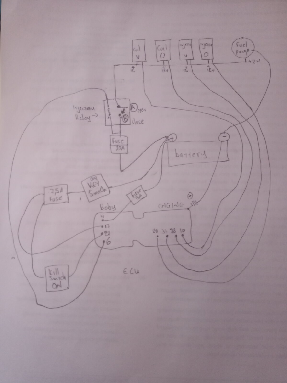

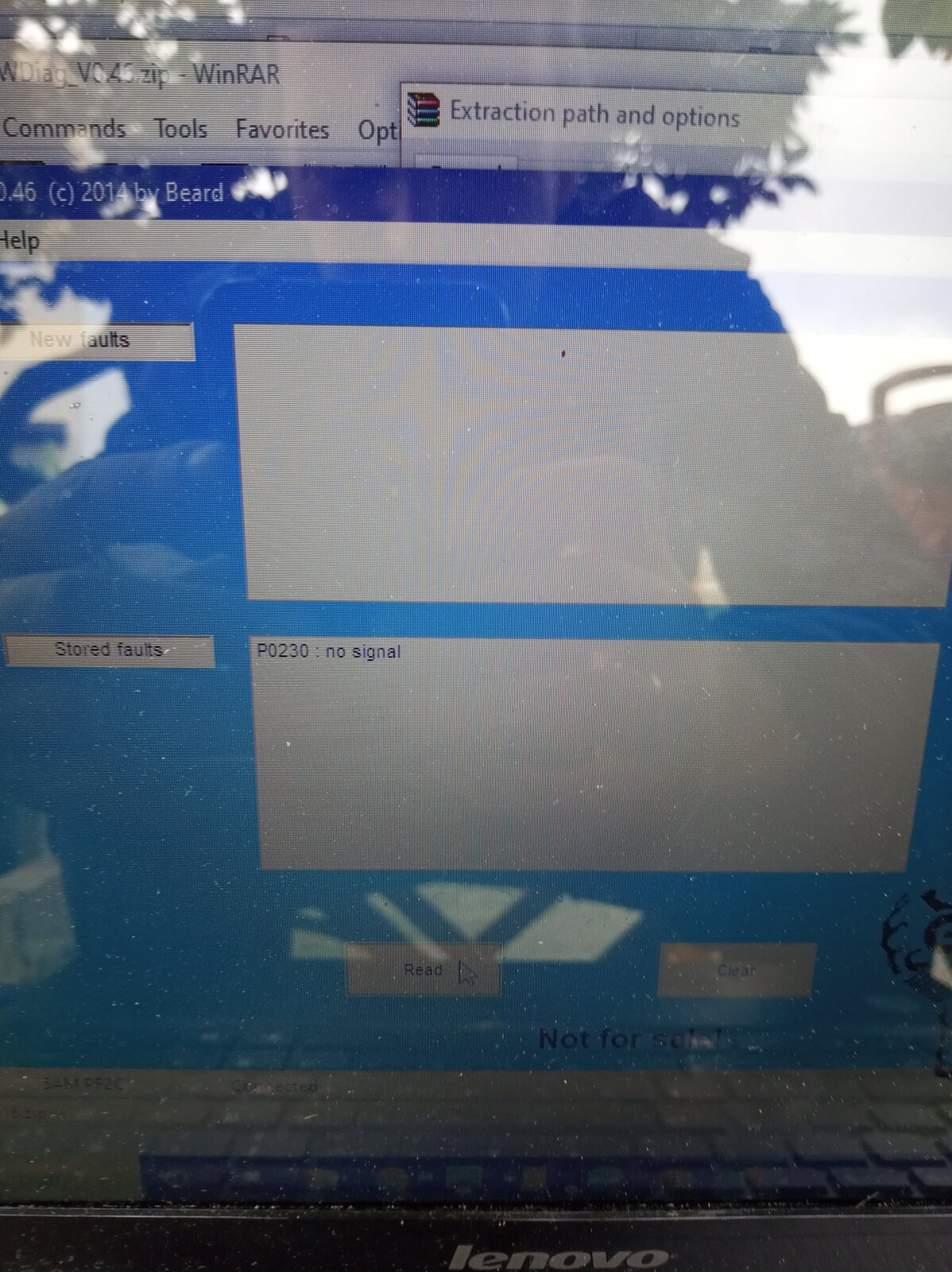

  1. Kraken I think your ecus are ok.I removed the 20 A fuse and injection relay in my bike and I got with iawdiag P0230 error.The coils and injectors get current from the injection relay.When this relay closes, you must have 11,5 volts at Bn/W cables on coil, injectors connectors.Coils and injectors are grounded digitally by the ECU (pins 10,38,37,27 engine area).The injection relay is also grounded by ECU (
    pin 6 body area ).If these lines are ok something blocks the ECU or there isn't a current supply.Remove the lights relay and replace the injector relay.It is the same. Disconnect the fuel pump connector and do the injector test.
    Disconnect the starter relay and do the test.
    Disconnect the engine temperature sensor and do the test.
    Do the same for neutral switch,stand switch,oil pressure sensor ..
    Clear all fuses contacts.Remove the dashboard connector and try with your 103 ecu
    I know is difficult problem, stay strong!

  3. the bulb will only illuminate during cranking (flash) if working correctly. 12v constant when ignition on. with the earth supplied by the ecu during cranking. i think you should expect around 16ohms from the injectors.

  14. You mention that you have tested the relays. Have you tested both relay functions/channels on each relay?
    When my Multistrada refused to start a long way from home, I phoned a Ducati technician who suspected the ignition/injection relay. He told me to reach up into the fairing, alongside side the (left?) fork leg and remove the relay for the lights which is identical to the ignition relay and swap them over. BOOM! the bike started immediately, but because one of the 'channels' in the ignition relay was blown, it meant that when used for the headlight, I think it was only high beam that worked for the ride home. This is a very quick, easy thing to check, just swap the two relays to see if it makes a difference..
