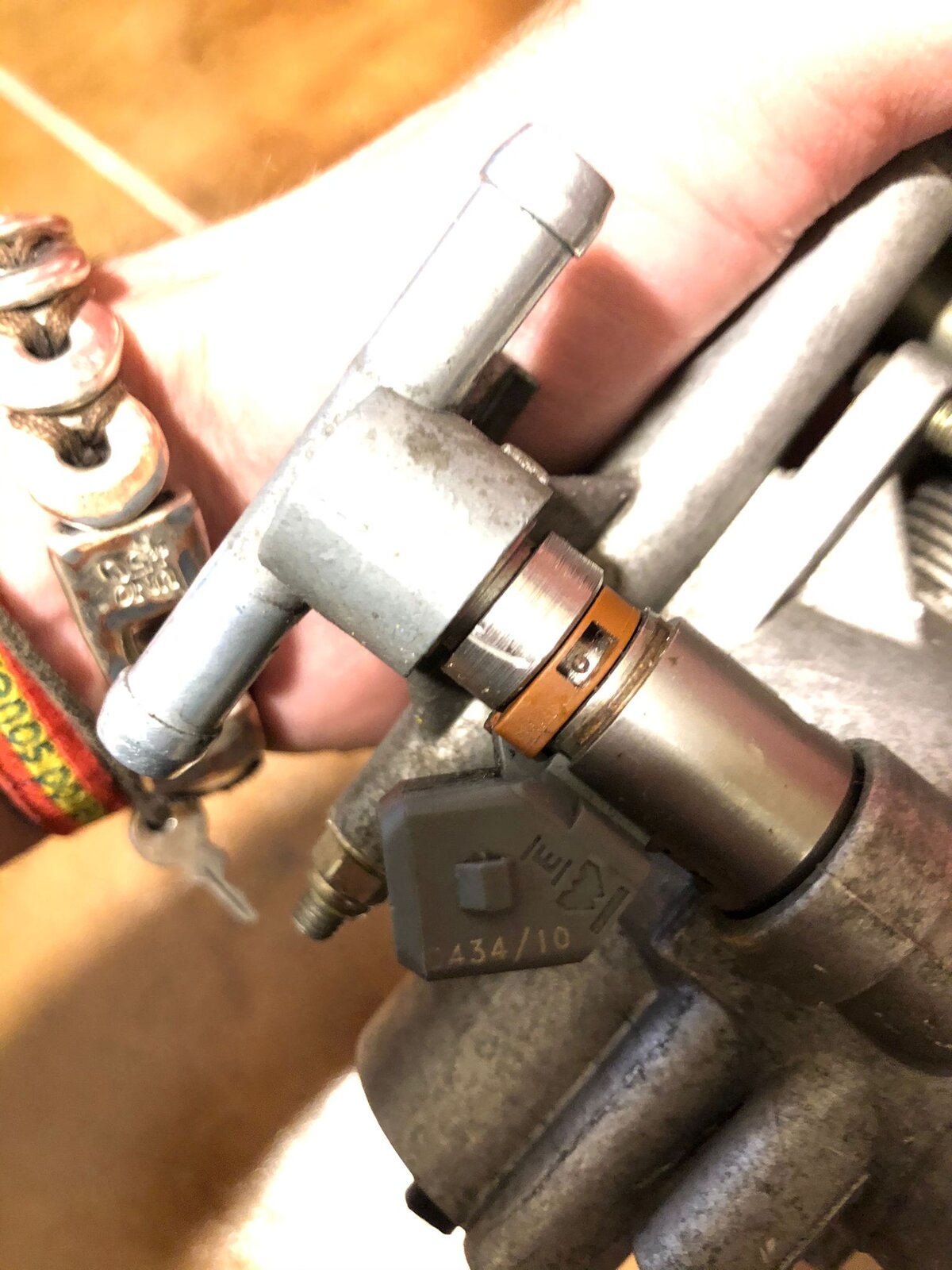

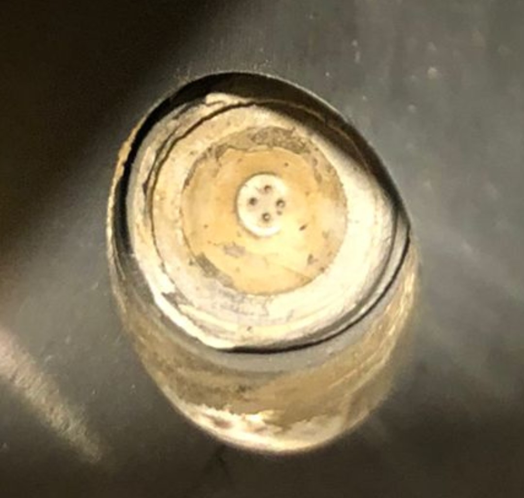

  8. I do not remember where I read the equivalence of the injector, I think it has to do with the color of the body.
    This is a picture of an injector from a friend who has a Ducati 1000 GT, which has the same DS engine. It has a brown body and 4 holes, I have to assume that mine will be the same.
    However when I disassemble them I will confirm it.
    Indeed Seville is a wonderful city, with a warm climate and great people.
    Do not forget to let me know if you come to Seville, we will have a few beers while we talk about our hobby.

  12. Multistrada 1000DS = IWP043 (Brown)
    Multistrada 1100 = IWP162 (White)
