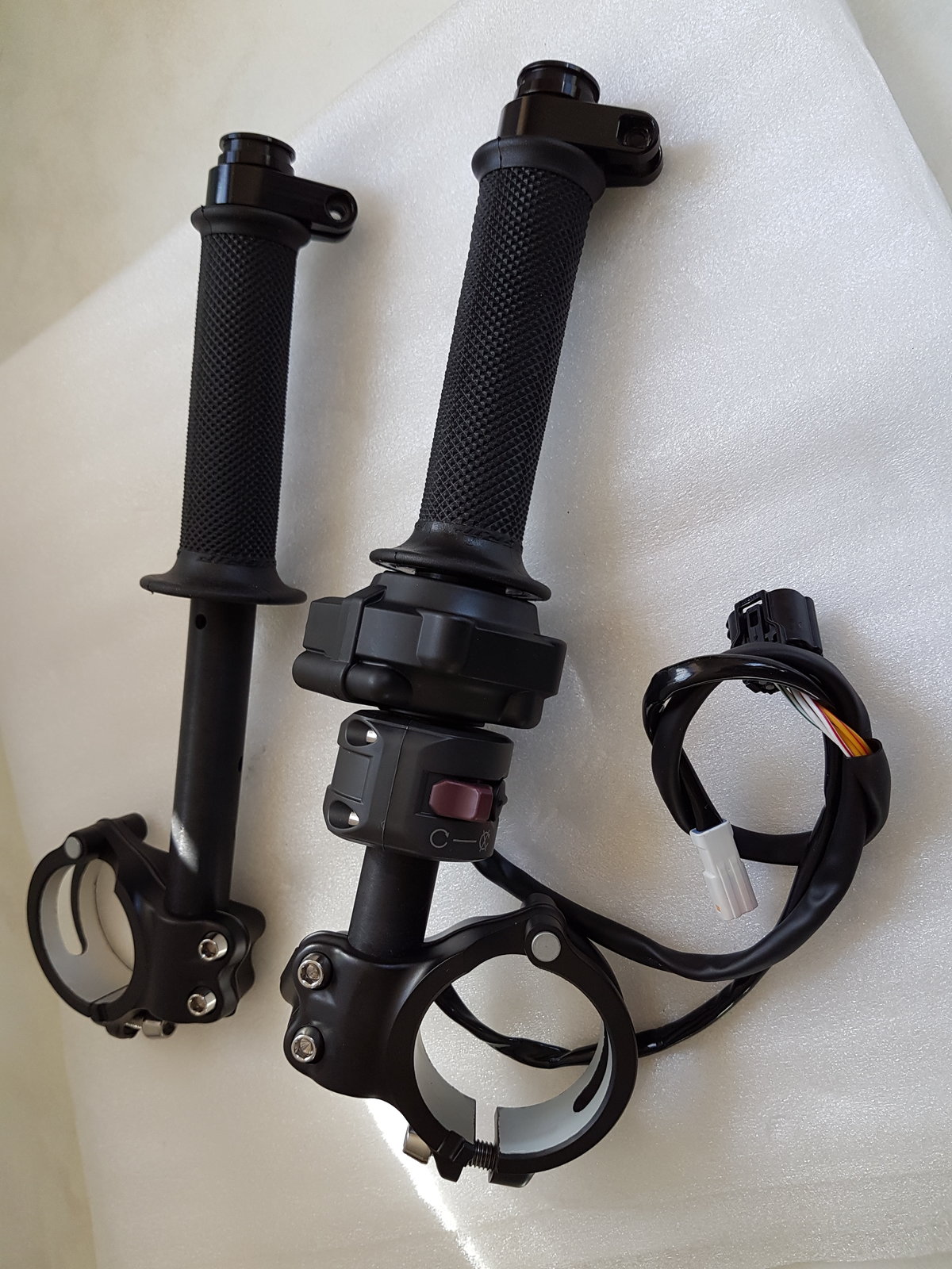

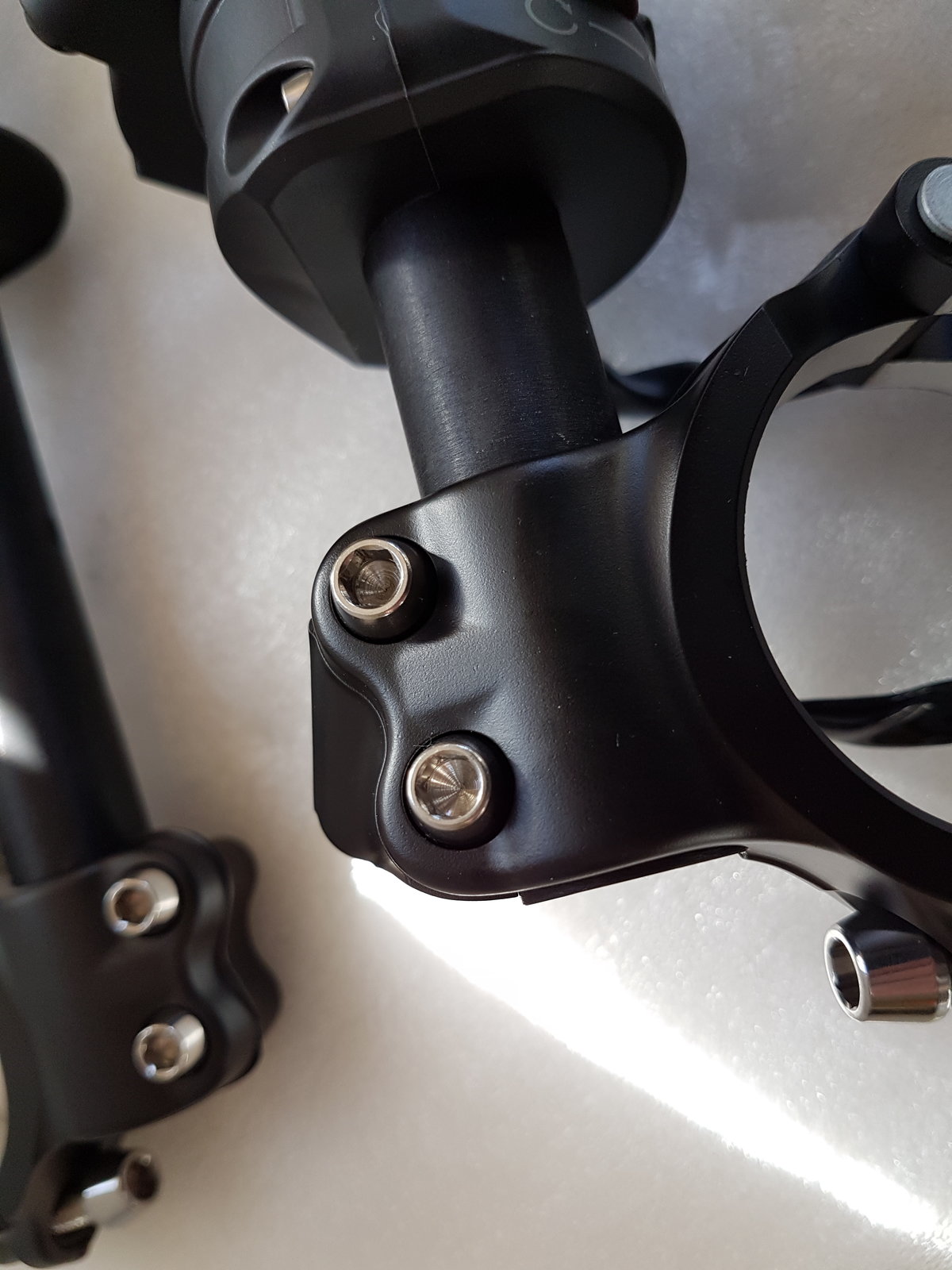

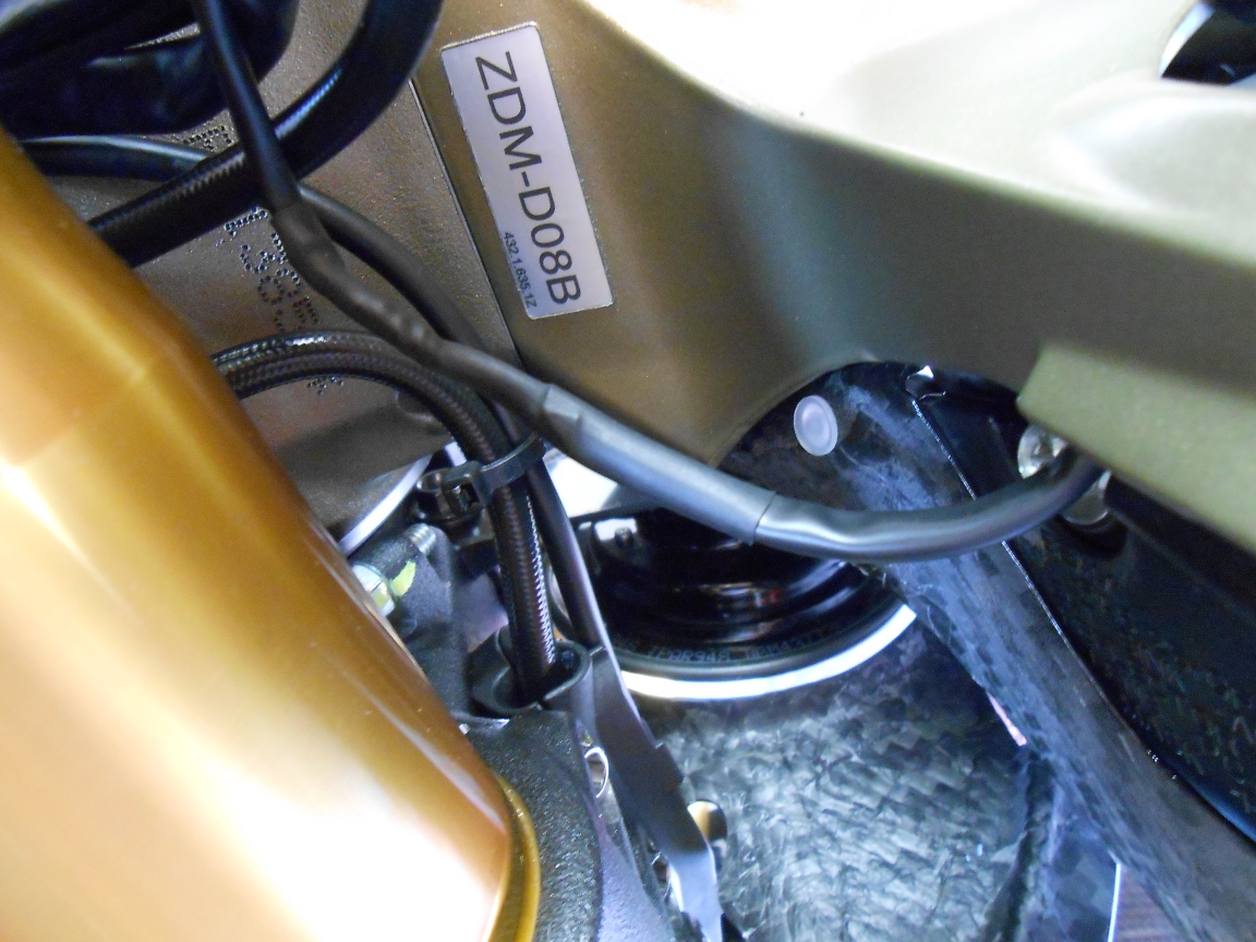

  3. I have Rizoma fluid reservoirs that use mounting brackets that fit into the inboard ends of the bars, so I coudn't route the Oberon signal wires out that way. Instead I drilled small holes into the underside of each bar and fed the wires out through there. Once they are tied in with the rest of the loom from each bar's switchgear with enough slack to allow the bars to move freely, they are then fed in through the back of the front subframe and I also fitted OEM connectors, so they literally plug straight in to the connectors behind the nose fairing. Ive included a few photos for the benefit of the OP. Hope these help. If you need any further advice then please send me a PM. If you want to use the Oberon signals, you will need a billet alloy threaded adaptor which MotoWheels sell. The adaptor also doubles up as a mounting for their bar end mirrors.

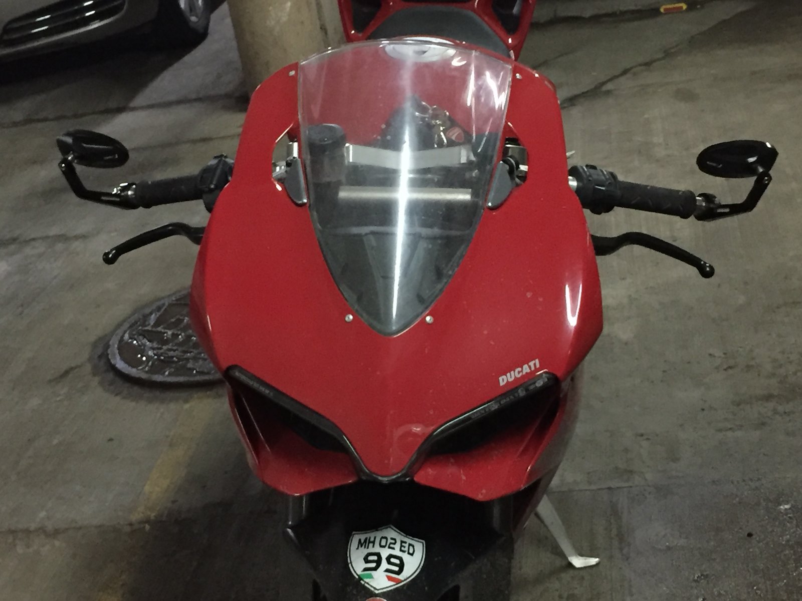

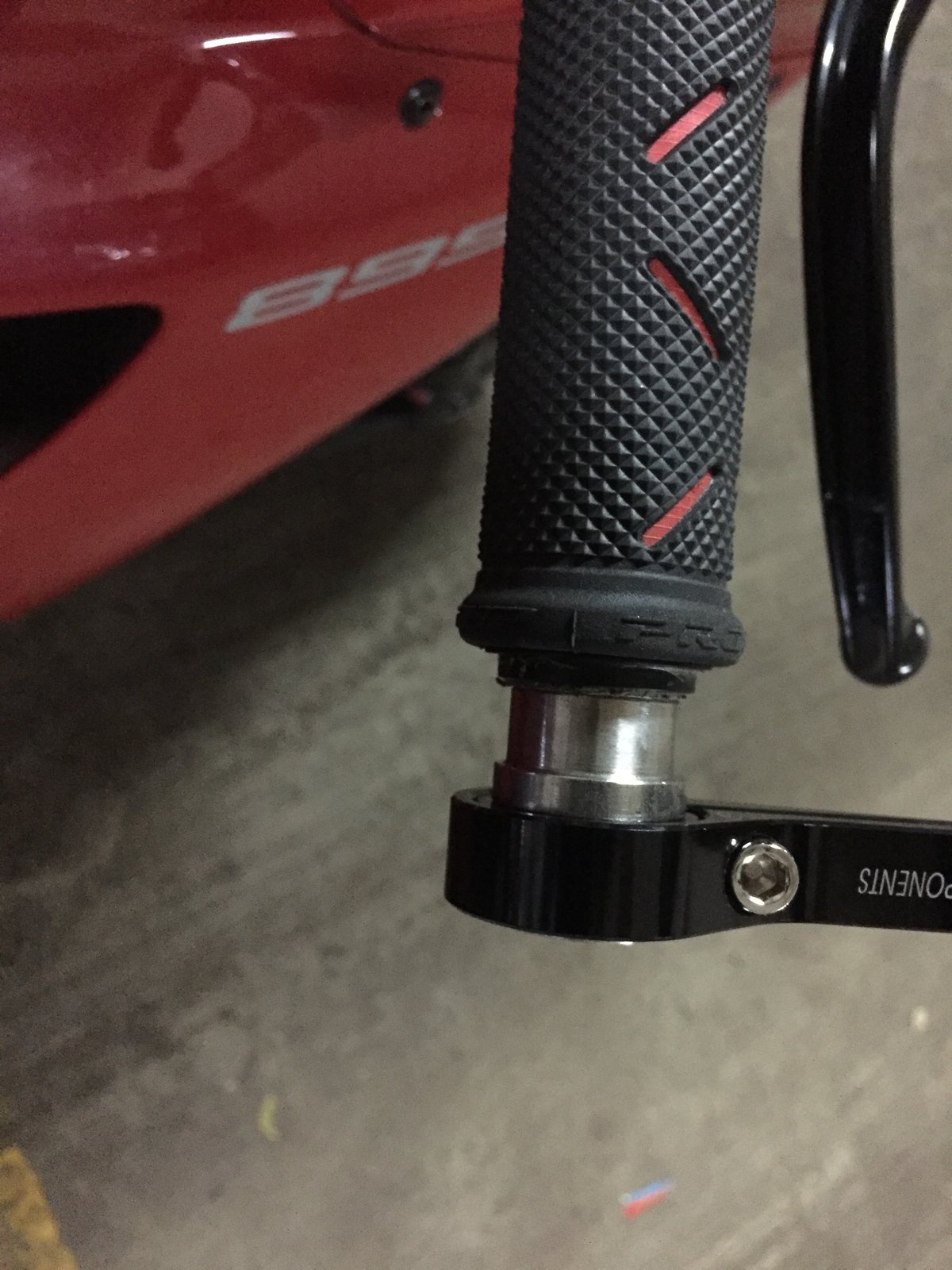

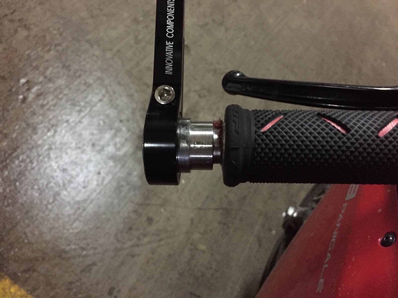

  4. Hi, thank you for your reply. Here's what I have achieved so far. I still need to receive the bar end indicators, as the first set I received broke and had to be sent back. I actually made my own adapters which thread into the stock handlebars and have room for the mirrors and the bar ends to thread into them. I made the adapters in such a way, so as to increase the overall length of the bars by about 10-15mm. Also, the adapters are drilled through, so I'll be running the wiring through the bar and out the other end through the plastic end caps.
    For some strange reason this one won't thread in all the way, so I'm going to have to take it to my workshop to have it seen to.
