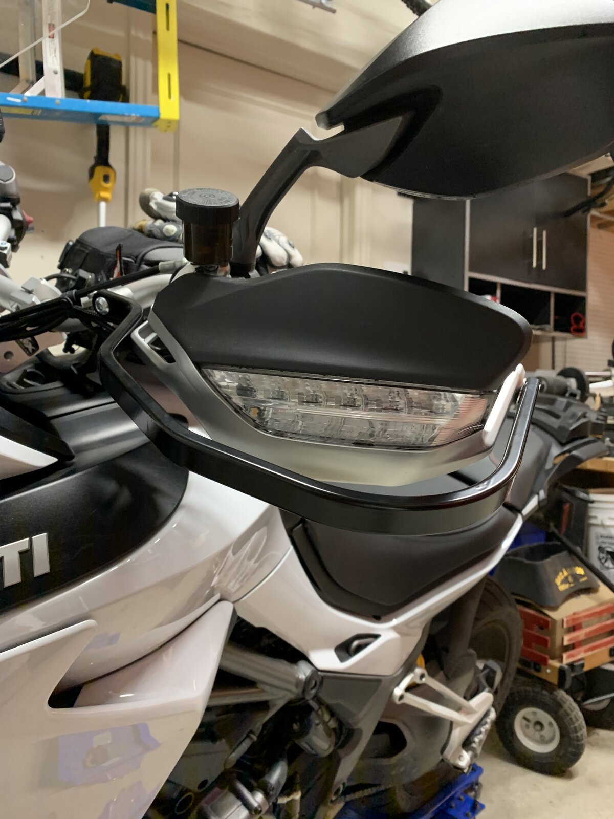

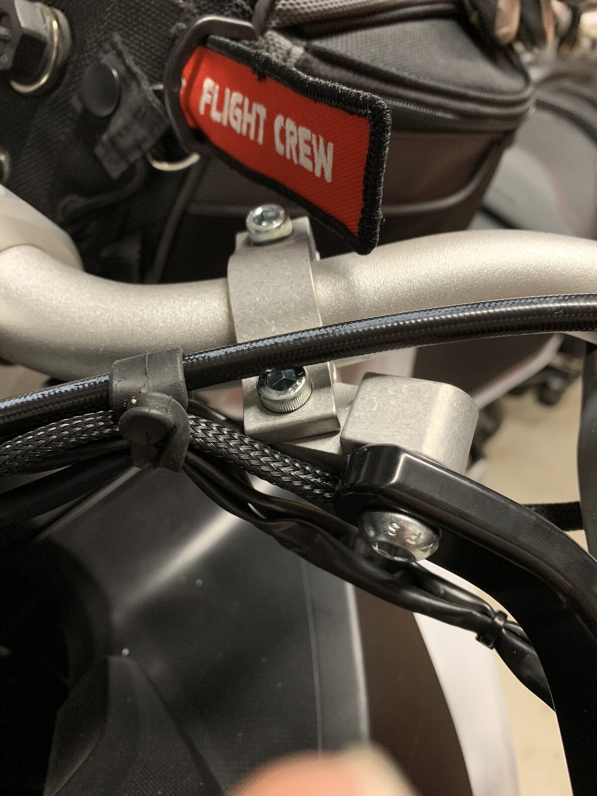

  5. Here are my impressions and install. Solid kit, very well made. Color offset from handle bar is not too bad, but then again I am colorblind.... Located all harnesses below the bar clamp, clutch / front brake hoses remained over clamp. LED turn signals are easily cleared - I followed the gray plastic outside part to locate the 'backbone' (as Barkbusters call it).

  6. Sorry, this is such a late question guys.
    Was there any issue with bar/fairing clearance on full lock? Any adjustment to lock-stops etc?
    Thanks in advance.

  8. Shoboshi,
    In short, no, not at all.
    Regards
    TonyN
  9. There should be no problem with clearance on full lock, at least in my experience with the standard screen.

  12. funny you should mention that.....I ve just given in and fitted some Barkbusters, proper ones for the bike , correct fitting kit etc, and it fouled the screen mounting on full lock both sides, now I suspect its my doing, as I have the bars rolled forward slightly for comfort,
    it is however less than 5 mins work to adjust the lockstops so it doesnt foul anymore
    as for the Barkbusters themselves, the usualy quality feel to them and they do fit the handguard well, hopefully I wont need to test them
