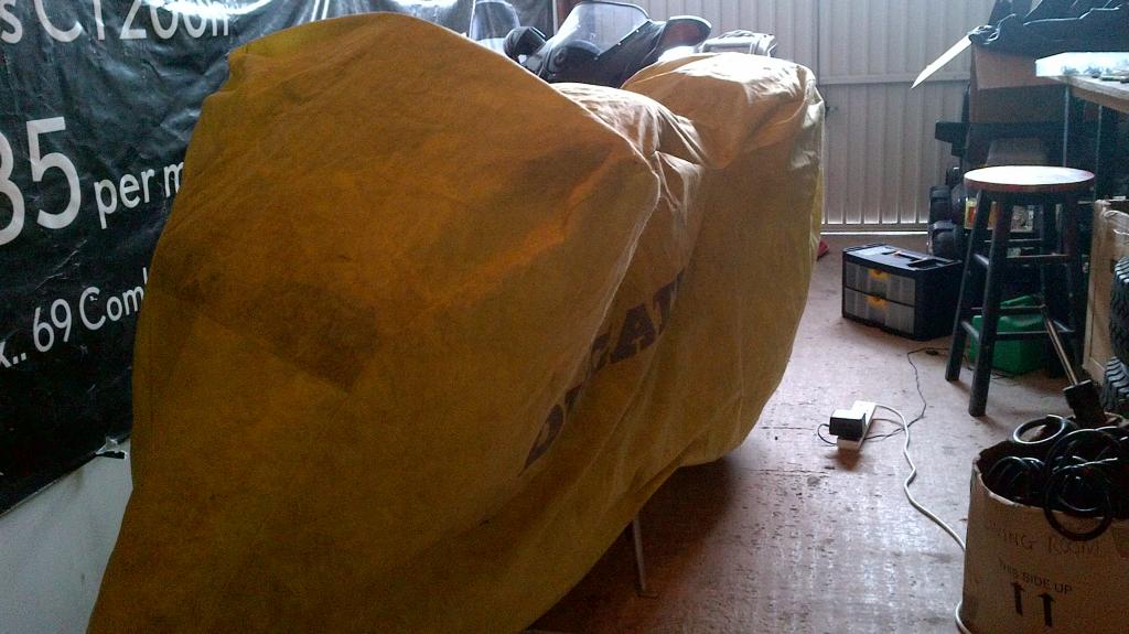

    Had a visit from View Profile: Bulletbill - Ducati Forum yesterday as he delivered the cover I was after - Awesome guy who came on his equally awesome 1098 powered ST4!!
    No progress on the 748 yet, and ended up tinkering with the 749 today instead - I promise I will get started on it soon!! :biggrin:
  11. Nice cover, does it say Ducati 748 on the side as it doesn't look like it. The covers that came with the SPS did have that written on them. I am not sure how authentic you want to be, but thought I would mention it. You are lucky to get a such nice cover though as they are so rare and as mentioned in a prior post they do literally fall apart. I was pretty annoyed when my just went very thin around the mirrors and then start to split and then just turn to dust.
    Maybe a good wash and plenty of fabric conditioner will preserve it as it's a nice item and now so rare you wouldn't want to see it fall apart.
    Good luck with it anyway, it certainly adds something to the package I think.
