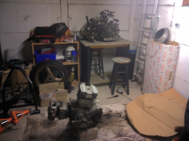

    So plan is to strip this blown one and see what issues I come across - then make the decision to tackle the SPS engine myself or not!! Everyone has to learn somewhere! and it would make keeping the original motor economically viable :tongue: any pointers / tips / pics?? :biggrin:
  13. The primary gear is very difficult to get off, it's best to use the correct tool but an hydraulic puller might do it. Crankshaft shimming is vital to avoid loading the main bearings and finally make sure the gearbox is correctly shimmed and all the gears and dogs engage correctly and the shifter mechanism is set up correctly. Check the crank big ends and repalce as necessary using the correct torquing method
    It is a big job and to be honest if you are not adept at these things then maybe pulling it apart and having some else rebuild after you have cleaned and sorted the engine bits out might be a good alternative.
  14. Making a sleeve only leaves it with a 1mm/40thou wall thickness. I would be inclined to drill the frame and make good the thicker bolts.
  15. I would top hat the fixings then that should do it. I have done this before and it works fine.
  16. I know a bit about that motor............it's an SP spec one out of a 1997 bike. I spent a bit of time making it into a steam kettle on the A41................
  17. This will probably be the way to go :upyeah:
    Ha :tongue:! what happened? Seems pretty clean (compared to mine!) - a shame its no good!
  18. Get Yourself many plastic boxes to store parts from disassembled engine :wink:
  19. And label them clearly if necessary with notes on orientation and anything else that's relevant. It's easy to forget when all of a sudden you are surrounded by parts that are unfamiliar.
  20. Take photo's as you go as well.
